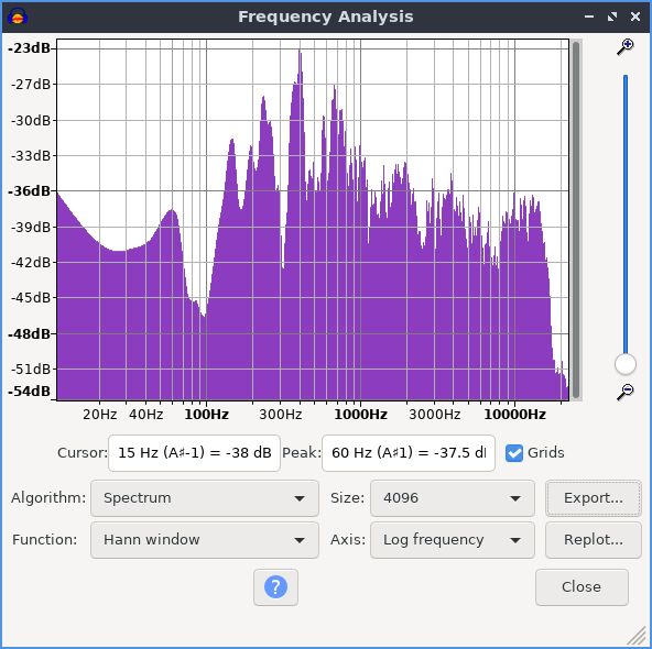

Second the motion about buying a proper room. On white noise backed against the front wall SP2(2004) has peaks of 6 db 240 & 400 hz, trough of 6 db 100 hz & 300 hz, down only 3 db to 20 hz. Room is shape of the Wein concert hall they give the New Years Day concerts in, 4 m x 2.5 m x 11 m, with a lot of urethane foam furniture, books records, pianos organs & carpet to damp out the resonances. Above 15 khz mike rolls off, I can't hear that anyway.

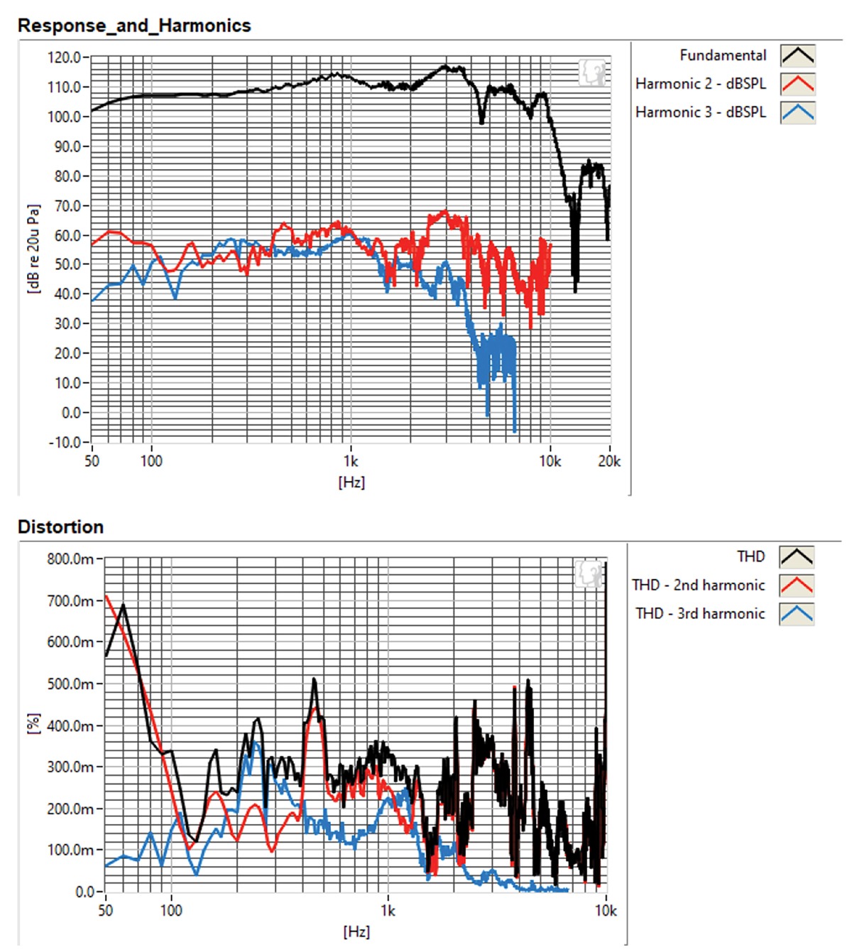

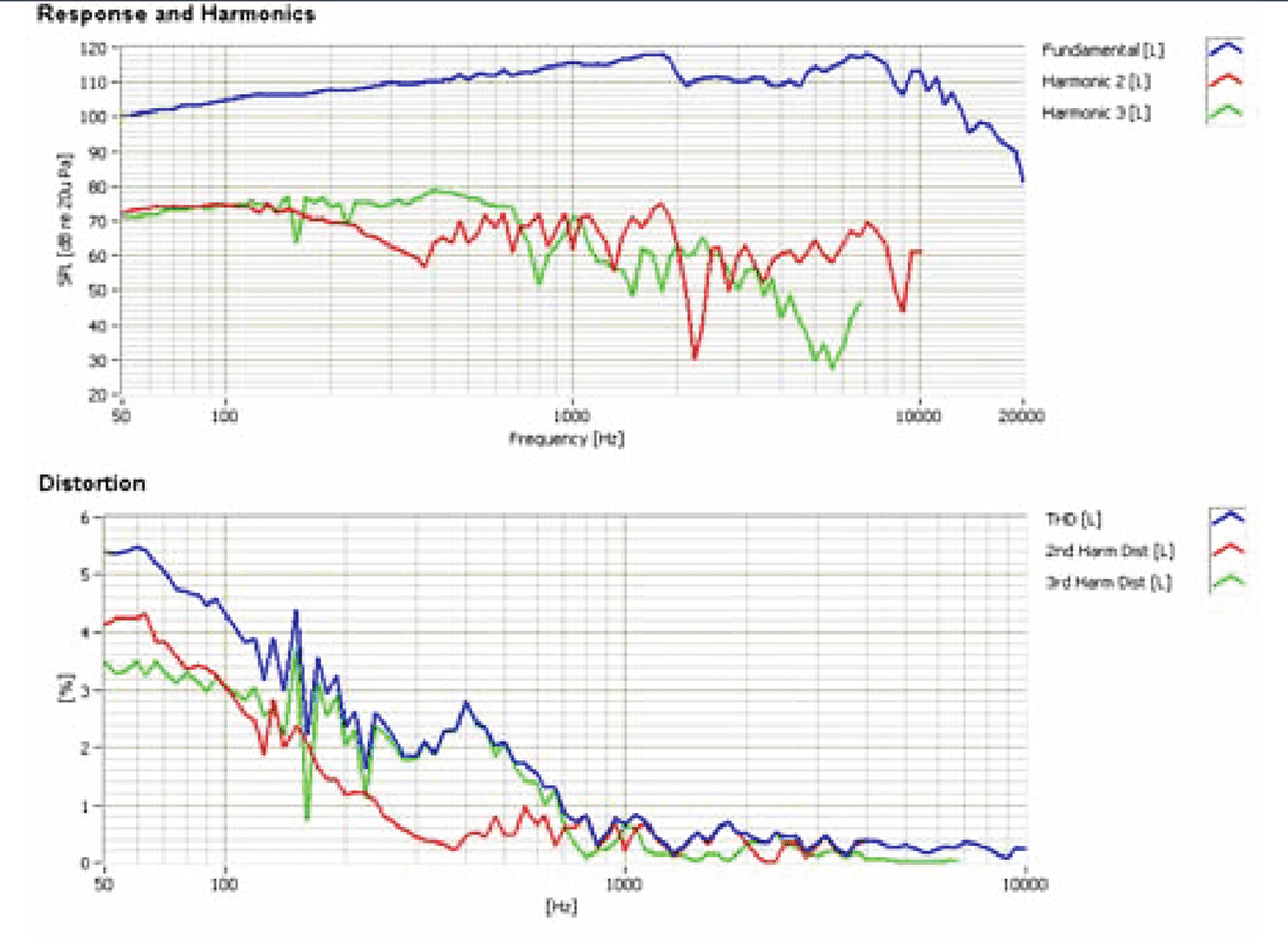

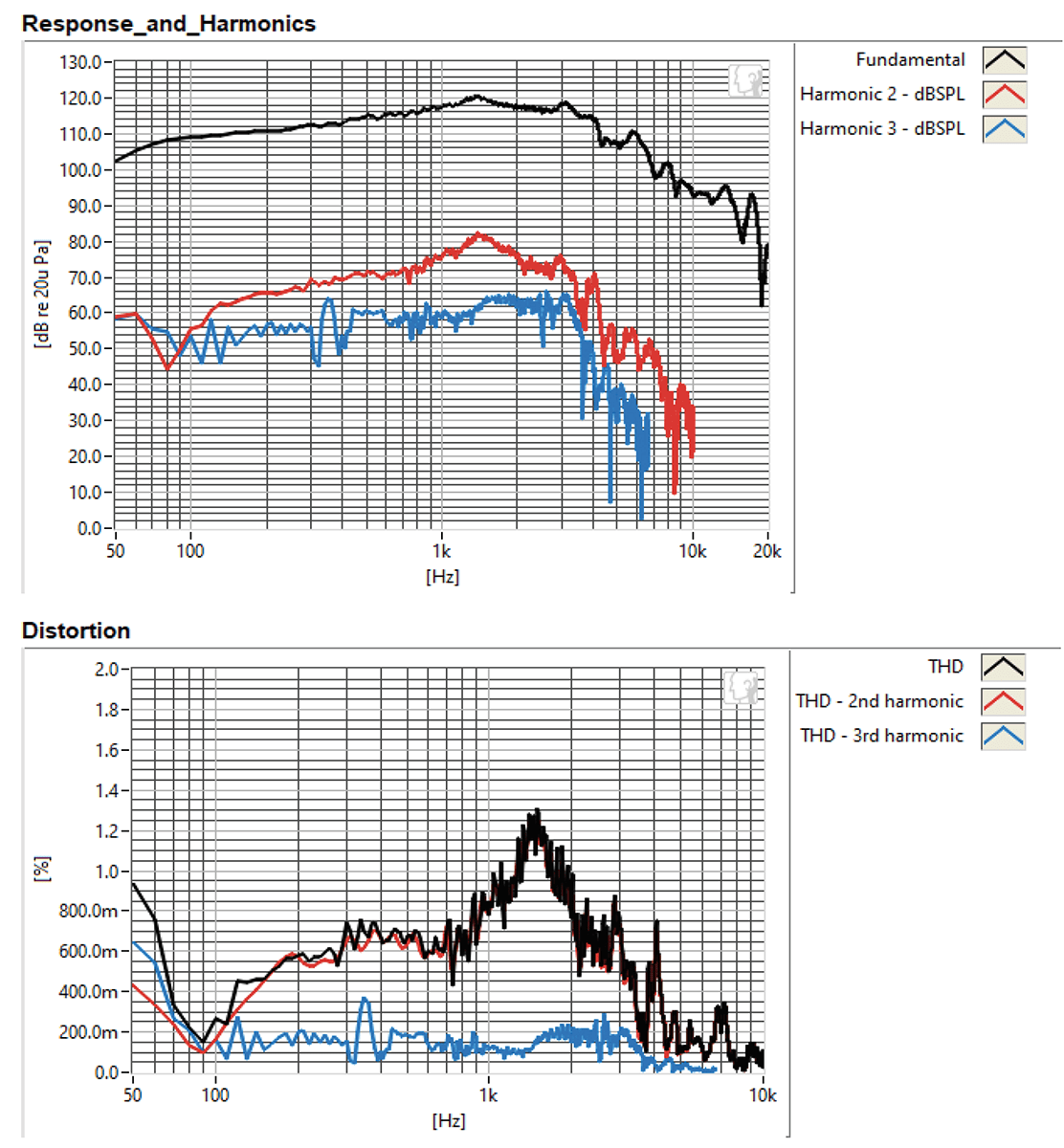

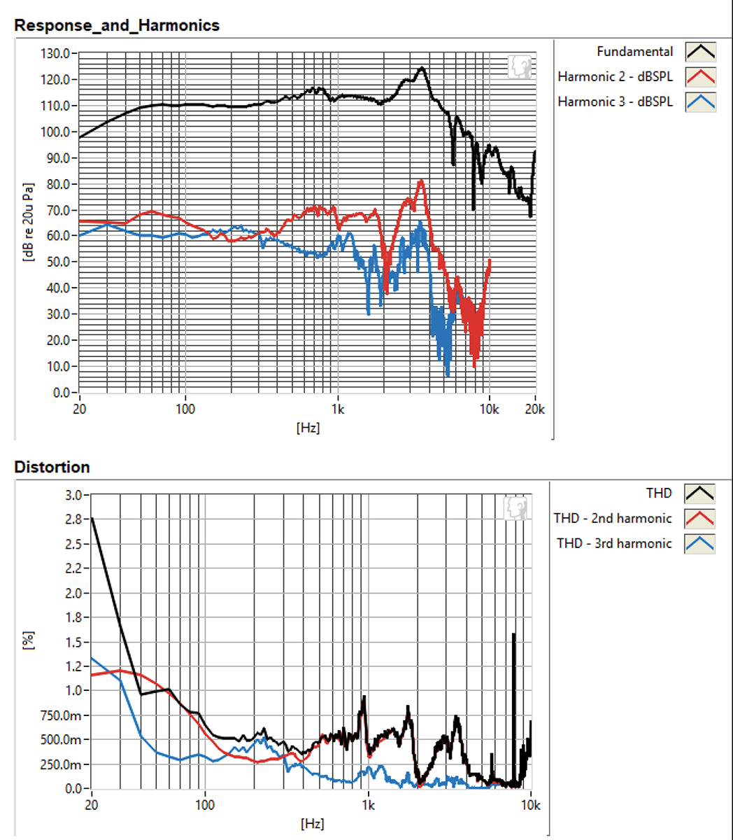

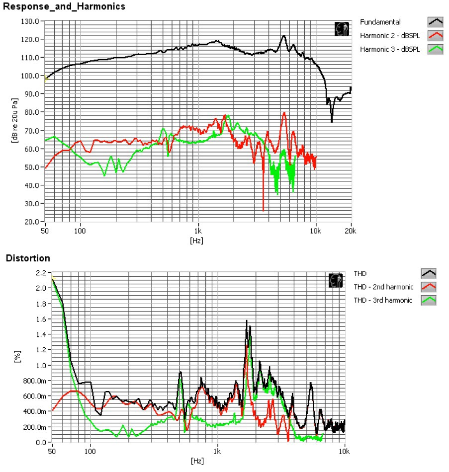

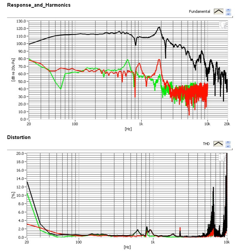

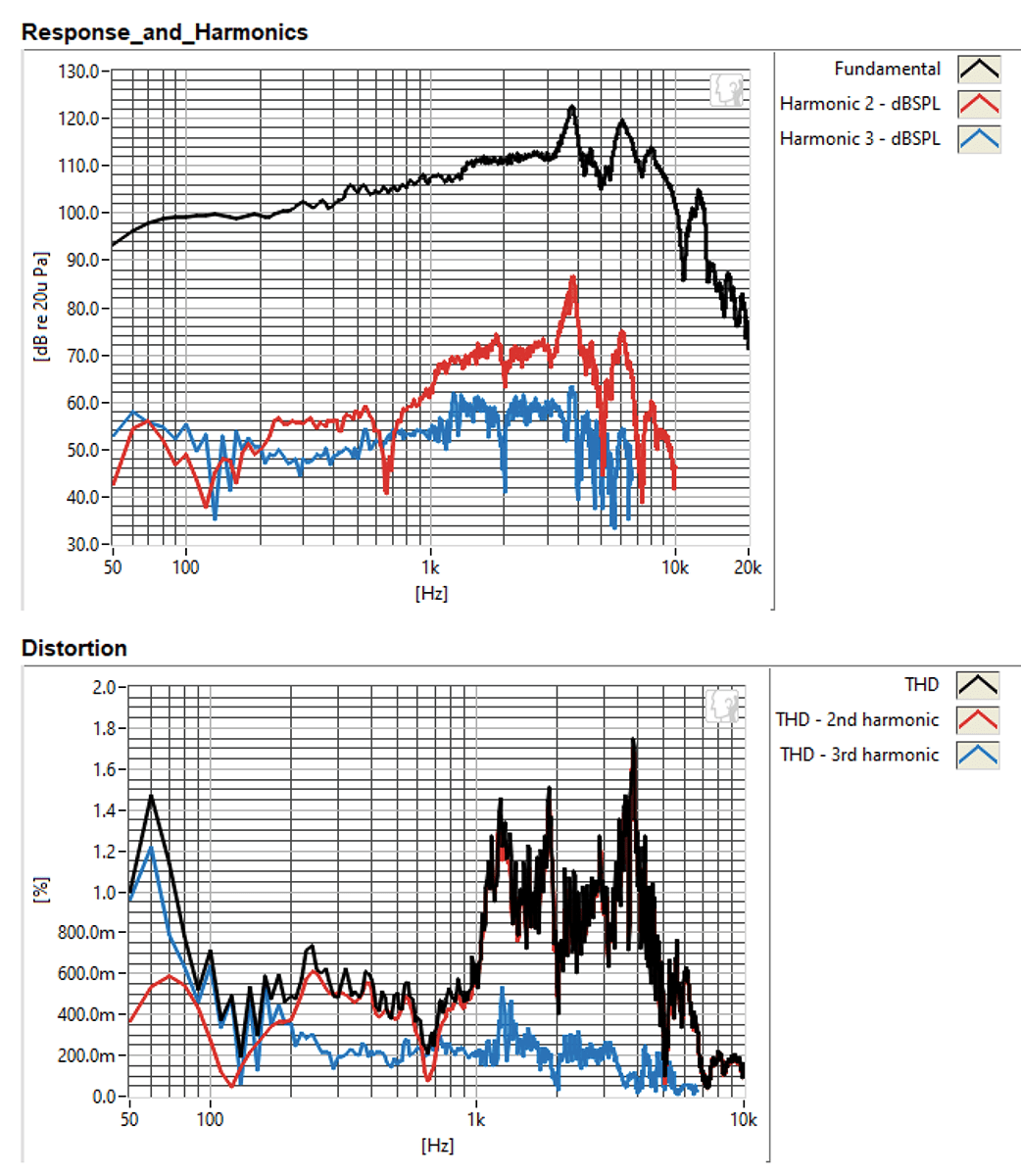

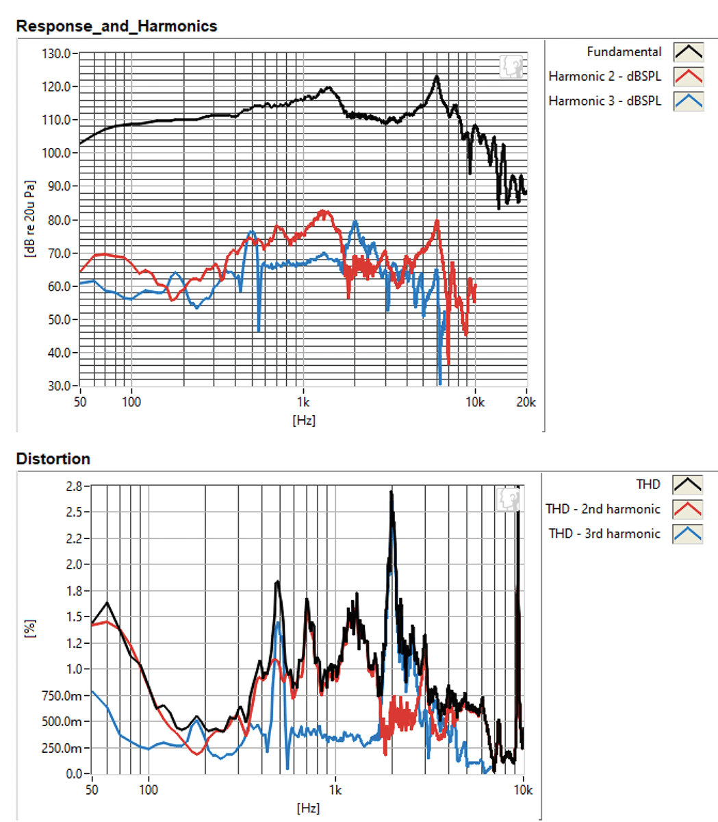

Considering only distortion and whether better driver would do one could look at voice coil test bench measurements as they are probably very well controlled and thus comparable. Here are few ~6" sized driver I quickly found and two 10" in home audio category for quick view what the distortion performance seems to be. Pro woofers are tested 10db louder so not directly comparable.
https://audioxpress.com/article/test-bench-dayton-audio-rs180p-8-7-reference-series-midwoofer
https://audioxpress.com/article/test-bench-the-bwx-6502-midbass-from-misco-s-bold-north-audio-line
https://audioxpress.com/article/tes...udio-6-5-midbass-transducer-from-purifi-audio
https://audioxpress.com/article/test-bench-morel-scw-636-woofer-from-the-fat-lady-speaker
https://audioxpress.com/article/test-bench-the-seas-l19rnx1-prestige-titan-series-woofer
https://audioxpress.com/article/test-bench-wavecor-wf275bd01-10-75-home-audio-woofer
https://audioxpress.com/article/test-bench-the-l26roy-10-subwoofer-from-seas
edit. found a 15" driver tested with 94db like all above
https://audioxpress.com/article/test-bench-the-sb42fhcl75-6-15-subwoofer-from-sb-acoustics
Most of these these seem to get ~1% distortion around 50Hz while some shoot above. Unfortunately there is no data below 50Hz for most of them so..
