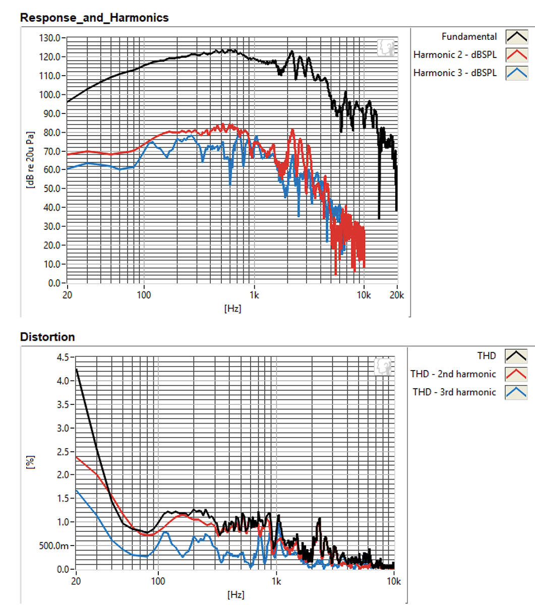

Some kind of baseline trend from the quick voice coil test bench journey seems to be that many +6" drivers seem reach ~1% distortion around 50Hz at ~94db and below that the distortion just shoots up with all drivers as more and more excursion is needed for the lower frequencies. Some bigger drivers in PA category measure similar performance with 104db test level like this 14" woofer from B&C https://audioxpress.com/article/test-bench-b-c-speakers-14na100-8-14-pro-sound-woofer
To me this reads, if your driver can do 1% distortion at 50Hz for the listening level you are listening to then its fine but if it doesn't then look if slightly better ones are available and prepare to pay some high price on it because the differences don't seem to be that big. That said the purifi data posted few posts back shows it has towards ~10db less thd at 50Hz than the Dayton rs series in the bunch, which is probably audible difference.
