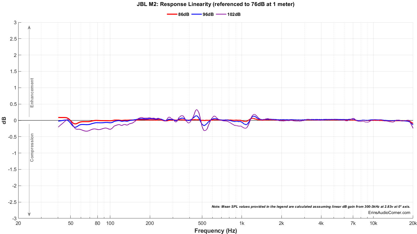

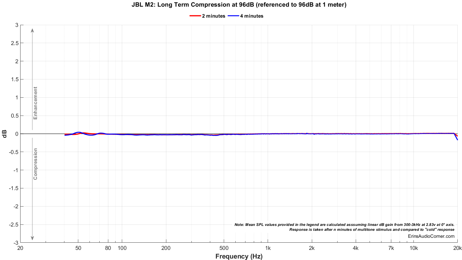

I have always wondered about the audibility of power compression at lower levels. I know Earl Geddes was concerned and Greg Timbers as well so I am not sure if this is what I am hearing of just the fact that out of all the 15" drivers I have owned these are my new favorites. Subjective for sure but sometimes that's all you got but looking at the Klippel measurements in the M2 review at Erins Audio Corner it's looks darn good.
