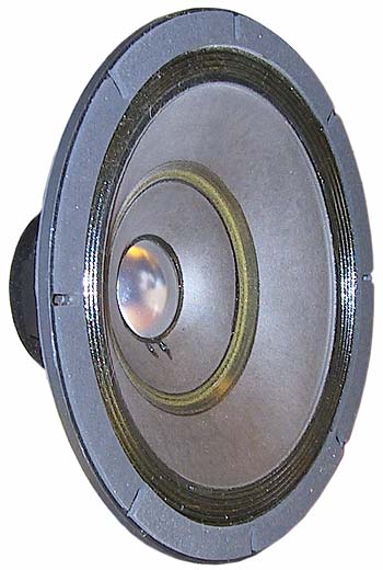

Tim Moorman said:Altec Bi-Flex
This is a 16" -- a very interesting (and substantial) driver.
dave

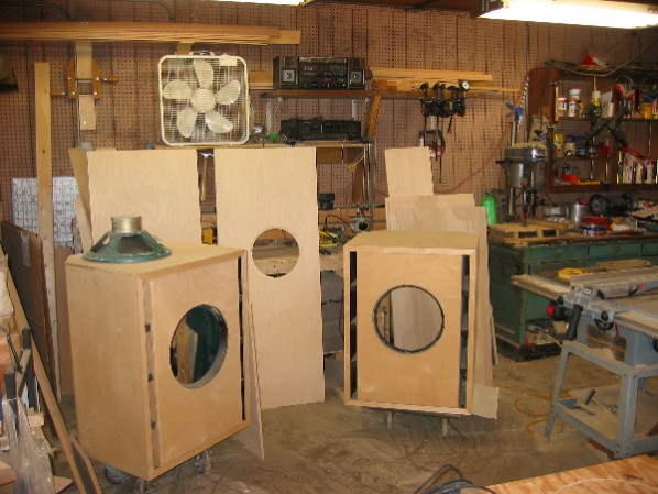

Altec 16" Bi-Flex
Yes, the 12" is the same construction. Sounds very nice, with just a hint of the peak I mentioned. About 96dB for the 12", will pair well with the ribbons above 3K or so.
16" frame is substantial indeed. 604s used that big frame.
The driver on top of the big box (onken-style) is an Altec 416Z (16 ohm). Needs very large enclosure, but do not sound bad at all in the onkens at 7ft^3.
Tim
Tim
