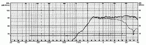

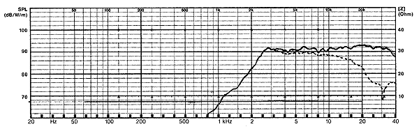

If you don't mind me to saying so, I heard quite a number of esoteric tweeters in my life, quite often with corresponding esoteric pricetags.
Very few of those did even come close to a half decent ribbon that sold at a tenth of the price of those big boys.
These are the specs of the Visaton ribbon and from what Sreten said about the Leribbon, I suspect that tweeter to measure in a similar way.
VISATON MHT12
Cheers,😉

claudio said:Hello Fdegrove,
looking at the Visaton mht12 response, the 30° off axis curve shows a high directivity, that is a limitation from my point of view.
Regards
Claudio
Compared to most dome tweeters looks very good to me,
especially around 15kHz to 20Khz. Seen domes flat on axis
to 25Khz and 30dB down at 30 degrees off axis at 25kHz.
Though I more than suspect 30 degrees vertical is not so hot.
🙂 sreten.
Claudio,
Let me assure you that I don't lose any sleep over that.😉
I understand your concern but in the design these tweeters are used in it sits well above ear level when the listener is seated.
These speakers never lacked in HF response and image so well that I need to tell people what speaker they're listening to if I have multiple pairs in the room.
You know, there's only so much you can tell from a graph or measurement unless it stinks big time of course.
Another major advantage of ribbons is that they present an easy resistive load to the amp allowing for simple x-over design.
Cheers,😉
Regards
Claudio
I think that many people hear that as an improvement. This is for several reasons:
1) Reduced room interactions like echoes, room resonances etc. Therefore there is more stereo separation compared to tweeters that have wide dispersion.
2) Many people really like lots of bass, so for them a lower in-room power level versus on-axis SPL at high frequencies = better. I've noticed the same thing with soft-dome tweeters: the ones that are often highly regarded have very low sensitivity off-axis compared to on-axis.
CM

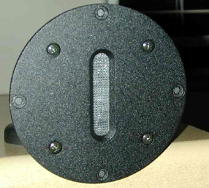

The ATD ribbon in the picture is in fact a bulgarian made ribbon, also sold in germany under another brand name. I have bought two pairs of then in bulgaria (and some pairs of all the other types off ribbons they are producing cause they all where about $30,- per pair) ) and used them in different systems. They can only be used as a super tweeter. crossing them at 3kHz will give you a very thin sound without any body.
The other Bulgarian tweeters I have bought and still using today are a copy of the old Decca/Kelly horn ribbon. These are very remarkable. Distrortion is the lowest I have ever measured on a tweeter. Impuls response is also the best I have ever seen, virtualy no ringing at all. And the most remarkble thing is the frequency response. Totally flat from 2.5kHz to 30kHz within +/-0,3dB !!!!! The off axis response at 30 degrees is also totally flat only 6dB lower, never saw that before. You can still find them very very cheap if you are lucky. In germany they sell them without the horn for lots of mony but they are not that good without the horn( why are people so afraid of horns?) I have spent hundreds of euro's buying tweeters but everytime I go back to these cheapo's. No Scan Speak, Seas, Thiel, Focal for me anymore.
If you are going to use the ATC mid dome, the Ravens or Aurum Cantus is a very fine combination, much better than a Thiel (Accuton, Ceratec, or wathever the brand name is in your country) A friend of mine has tried both combinations and the Rave was absolutly the winner. He also tried the scan speak ring radiator but I found it sounding a bit boring compared to the other two.
