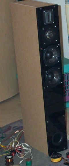

I tried several Ribbons over the time and had these Fostex FT7RP in my speakers as first try.
http://www.diyaudio.com/forums/showthread.php?threadid=6528&highlight=
The frequency plot from the Fostrex pdf i can´t confirm. The ribbon itself tended to sound a bit unpleasent,
or harsh in a kind compared to others.
The pic below shows one of the combinations i tried.
I still like the Technics Veterans based on the TH-400 foil most. Quadral, the ones i use atm use this foil
with a bigger coupled volume and neodyn magnets. Therefore i get a little better response as the original TH-400.
The Visaton MHT seems to be a real alternative cause it is still in the stores. I heard it once and think it
is in the same league as the Technics ones. Sadly i had no chance to compare it directly.
