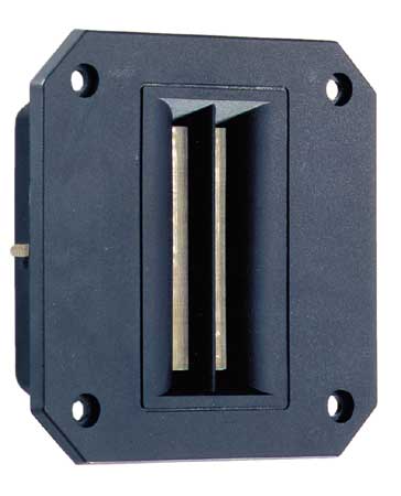

any on have any experience with the Dayton Pt2 Planar Tweeter. Is it a decent ribbon or are there better tweets for about the same price.
chbright said:any on have any experience with the Dayton Pt2 Planar Tweeter. Is it a decent ribbon or are there better tweets for about the same price.
You'll find a large number of these puesdo-ribbons, many with house brand labels (like Dayton). I had a set of the Stykes. They are good for the money, but most of the true ribbons are in another league.
