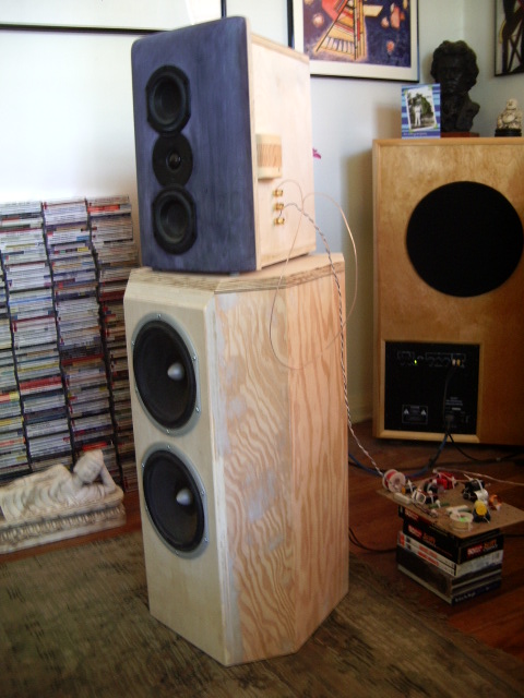

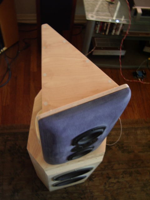

I have seen the B&W Nautilus enclosure drawing many times, as shown earlier in this thread, but I am not able to determine if the midrange enclosure is open at the rear end of the tapered tube. I am trying to emulate that enclosure style with a longish, narrow isosceles triangle instead of the tapered tube.
Even with the enclosure walls well damped and the whole thing filled with long fiber wool, I seem to be getting a lot of boxy colorations in the lower midrange. Should I cut off the very point of the triangle, making a narrow slot opening at the rear of the enclosure?
I would appreciate your opinions.

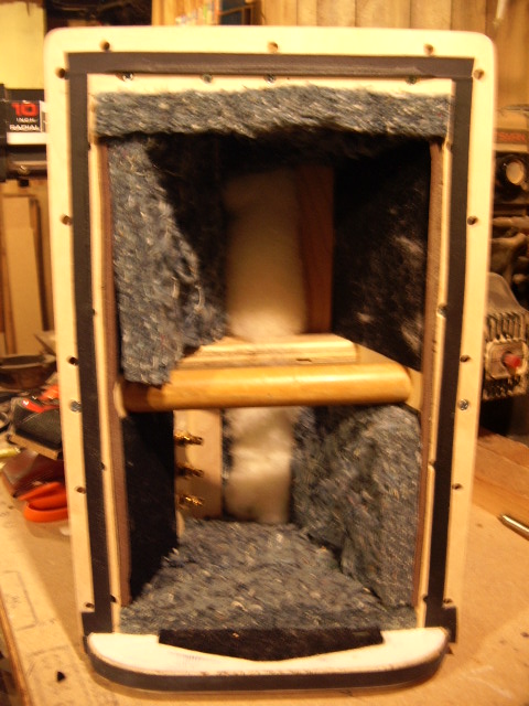

I can open the box quite easily; I've already done it a dozen or more times! I've played with stuffing density and type. Right now, sides, top, and apex are lined with cotton insulation (better at absorbing midrange than fiberglass), plus some thick felt in a few places, then stuffed with varying density of wool (thicker toward the rear). The whole point of the enclosure shape is to avoid a flat, reflective back panel. Thanks for your gut feeling, but why would I want to make it flat? Is the inside of the enclosure acting like a horn?
Crossover is active between bass bins and top, carefully built by me with quality components and many trial alignments but no measurements because I lack the equipment. Passive xover between mids and tweeter, professionally designed. The active portion could be part of or the entire problem, but what I'm hearing sounds like box coloration: a sort of echoey, hollow sound. Upper mids and highs are sweet, detailed, open.

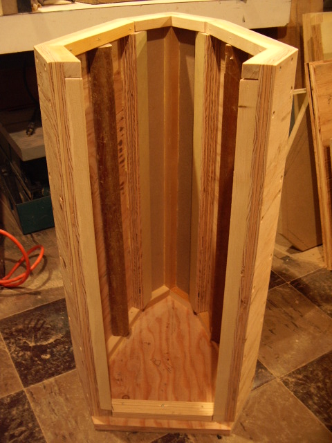

Internal pic, obviously without wool.

I'd open the slot at the back since it could be plugged or damped if needed. Lower midrange colorations can come from room effects also of course. Nice build.
Yes, it could be closed again with only mild difficulty. My room is certainly not perfect, but I've had other speakers in there (B&W 802's) that sounded pretty darn nice. Actually, the highs, upper mids, and bass of these speakers sounds better than the B&W's did. It's just the lower vocals and low strings that sound somewhat echoey and recessed. Maybe I'm expecting too much, but after all the effort and expense of building these (thanks for noticing), I would like to improve this one weak spot in the spectrum. I have built other speakers with better performance in the low mids, so I know it can be done. These are good Peerless drivers, so I know they have the capability to sound better.

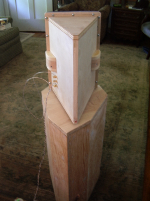

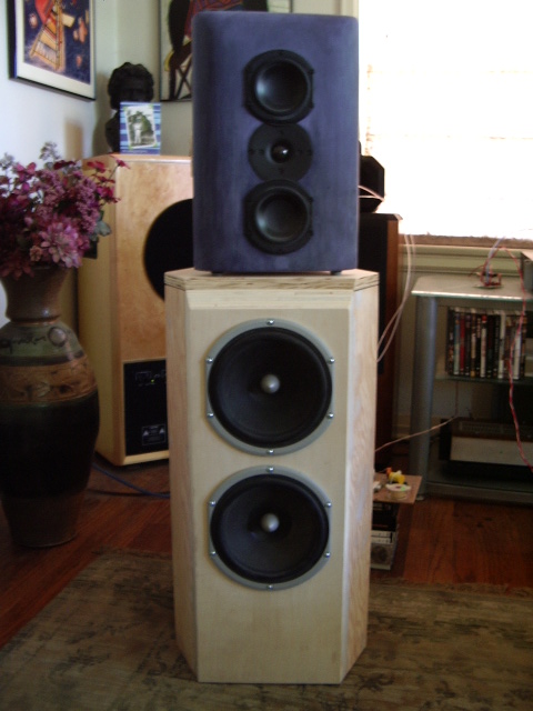

Here is another pic, with subwoofer in the background.

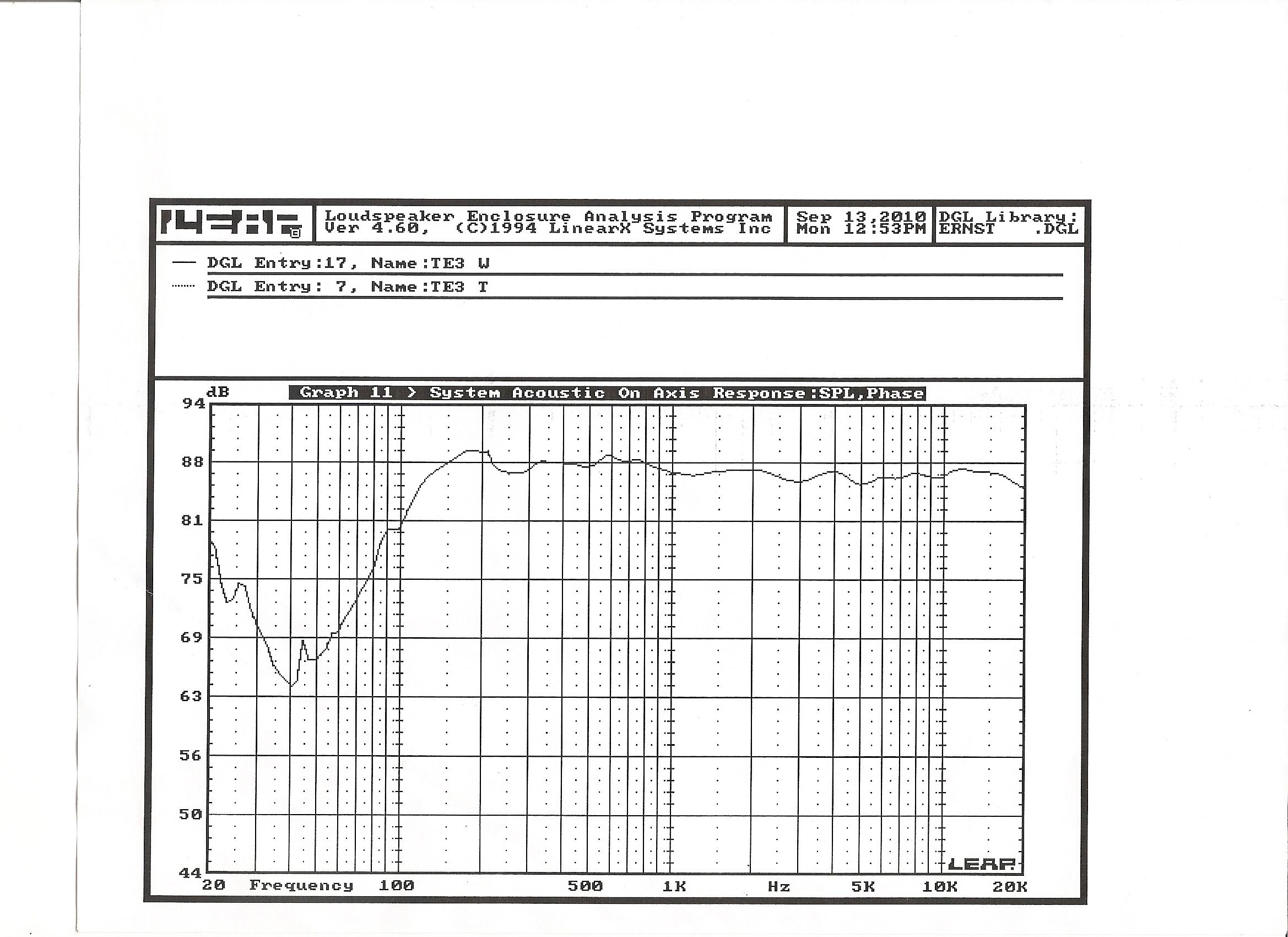

The passive between mids and tweeter is around 2800, approximately 2nd order, acoustic. The active beteen bass and mids is LR4 @ 220 LP and Butterworth 2nd order @ 300 HP, electrical. Response curve of mids/tweets shown below.
Woofers are Peerless 830884 8". Bass bin enclosure volume is two cubic feet, lined with thick felt and pretty well stuffed with fiberglass. I do not have a response curve. Pic of internal bass bin, without any filling, shown below. There is another layer of 1/2" plywood applied over the internal 3/4" layer shown. The bottom of the enclosure is covered with a tapered (sloped from thin at front to thick at the apex) 1-1/2" thick layer of VERY rough texture concrete.

Actually I was thinking that the sum of the reflections was aimed back at the face of the mid driver and that dense fibreglass stuffing was the best way around this
No, the cab will have a very diffuse reflection field with only the vertical seam and the parallel top, bottom surfaces causing eigenmodes back to the drivers, so in the scheme of things only the top, one side and seam need damping.

Based on the pics, I'm going to guess that your plywood/concrete bass unit is ringing quite a bit in the lower midrange. Ply is amazing for true subs but IMHO should be used with some sort of damping material on it, like dynamat or the coating equivalent.
....plywood/concrete bass unit is ringing quite a bit in the lower midrange.
Hmm, missed the attached concrete base, so yes, this lowers the cab's Fs considerably, probably down into the cab's gain BW, which most likely is causing the 'hollow' sound and probably will require more damping than there's room in the cab for.
If something heavy is to be used to mass load the cab, it should be on top, so with concrete on the bottom you'll probably have to add a significant amount of temporary weight to see if it helps enough.

Nothing wrong with the cabinet shape but don't assume that it absorbs reflections. The absorbing material is still crucial to what amount of back wave gets absorbed.
This is tied to the angle of the back V. If you have two back faces at 45 and 45 then with 2 bounces the wave will come straight back to the front. With the angle you show it would take 3 bounces to get back to the front. With a single back surface it takes one bounce.
So if you absorption material is very poor then you get a few more chances for it to get absorbed and should see a small improvement over the same material and a flat back. Still it is the absorbing material that does the job.
The whole discussion of slot at the back seems to center on some thought that the sound funnels down and then sneaks out the slot with no reflections. If you assume specular reflections (bouncing like light rays off of a mirror), very little would make it to the slot, most would reflect across the surfaces and reverse direction without hitting it. If any sound does hit the slot, it still reflects back, but out of phase rather than in phase.
No magic bullets here.
