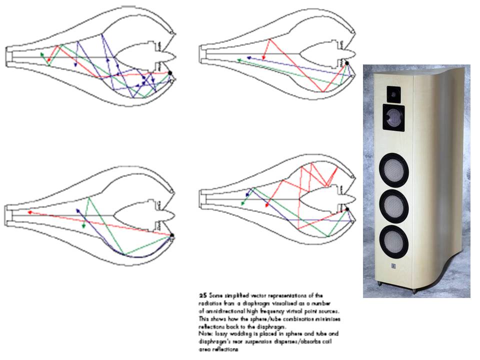

I think the ideal midbass cabinet is shaped like a sphere to allow the cone rear wave DYNAMICS to EXPLODE without interference and then get quickly absorbed without any resonance by a stuffed, tapered rear cavity with a tiny open exit. With a sphere, diffraction is almost ideal but a difficult shape to construct and integrate into a multi-way speaker.
B&W 801 genius engineers did their homework. Avalon genius engineers, Focal Grande Uotopia, WhiteLight engineers worry about rear waves and diffraction using more standard construction.
