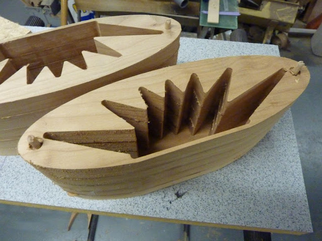

Best sealed enclosure for completely supressing back wave
Ed Collier's Concave Rapide. More surface area for damping can be achieved by using this technique.
That's a novel idea!
Clearly exotic interior shapes have more appeal than simply letting fiberglass do its job.
I haven't seen any response measuements that show that exotic shapes are better or that simple damping is inadequate.
David S
Toole has interesting information about irregular room shapes in "Sound Reproduction". He says that there are no real differences in the modal resonance structures between regular or irregular shapes. Just regular rooms are easier to work out mathematically!
Given that a loudspeaker enclosure is just a small scale room, it seems logical that it holds true for speakers too.

Guys, a straight through auto muffler actually has fiberglass in it for sound damping, hence the term "glasspack".
Most people are using polyfill, but fiberglass seems to be a fair superior material for sound damping.
Right on both counts. A glass pack is not the most efficient (soundwise) muffler, but they are good for flow. Air conditioner ducts are made the same way, A perforated barrier around the main flow area lets sound leak into the surrounding fiberglass where it is absorbed. Note that most mufflers are tuned resonators of various types. They use tuning to create cancelation of the most annoying exhaust frequencies. Designers are also very aware of what a "good sounding" exhaust note is and tune accordingly. I have read a couple of motorcycle articles that directly state that dB reduction is proportional to weight and volume of the muffler. i.e., you can't get good attenuation with a small muffler.
We don't need to flow hot exhaust gasses in our loudspeakers (at least not the ones I've worked on!) so we can concentrate more on sound absorption and less on flow drag. Mufflers, glass packs and catalytic converters are all mediocre to poor in terms of the real sound absorption that we want in a speaker.
I've been stating for years that polyfil is a poor sound absorber. It will increase box apparent volume but it won't absorb standing waves to any degree. (Yes, I have tested it in cabinets.) I went looking for the sound absorption properties in the usual acoustics web sites but apparently it has never been tested since its absorption is so poor.
David S.
But in a forum where everyone is obsessing about absorbing the back wave, polyfill is not only not "the best" it is downright poor. It will not absorb standing waves.
If you don't like FG then try some of the recycled cotton felts made from scraps.
Health effects? FG is itchy but it is not known to be carcinogenic.
David S.

Why you guys keep going on about bizzare box interior shapes and then ignore that some materials exist that can really absorb sound better than other materials??
