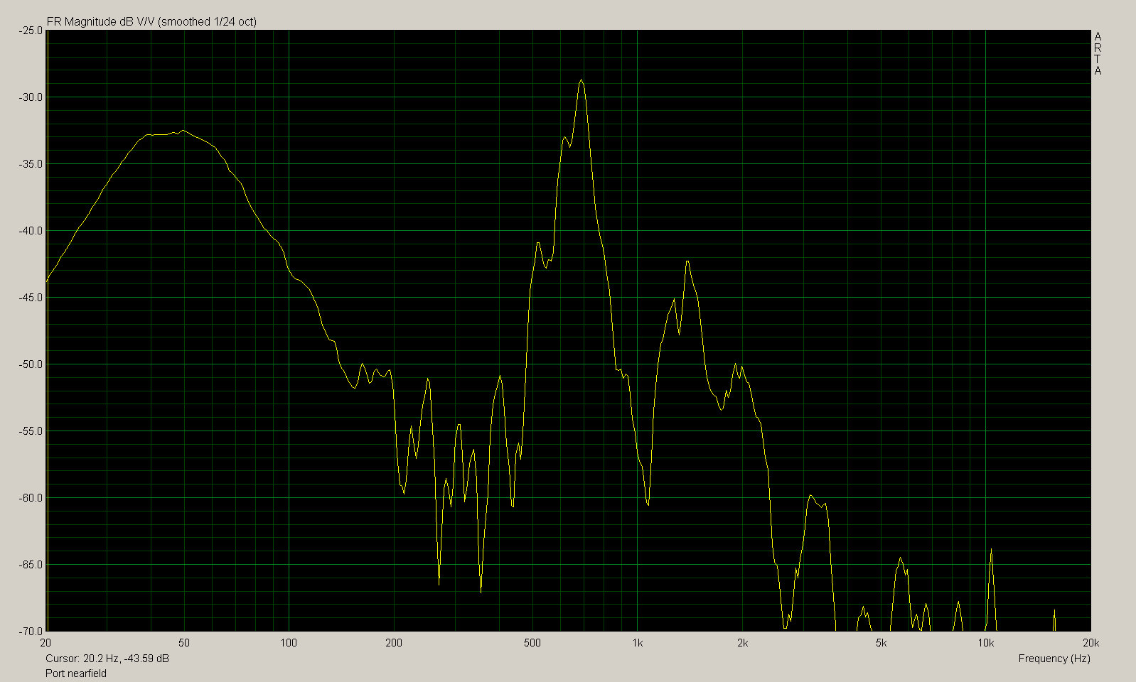

Here's some measurements to add to the conversation.
The box is about 63cm long by 39cm wide by 30cm deep with an 8" driver. The lining is only around 10-15mm thick wool under-felt with nothing else. The longest internal dimension is about 57cm after panel thickness etc is taken into account, that's a half wavelength resonance of about 300Hz. (Not 260Hz as I guessed in the previous post)
The first image is a near-field measurement of the driver. Despite a huge internal resonance around 300Hz when singing into the box with the driver removed, the fluctuations in response at least at the driver cone are a mere +/- 0.25dB between 140-400Hz. (Much above that frequency the near-field measurement becomes invalid due to the size of the driver...) In a frequency range where floor/wall reflections introduce huge peaks and dips in the response, I struggle to see how this minimal ripple in the response from the driver cone would even be audible.
What's more, the worst ripple in the response is at 140Hz, which is too low in frequency to be a air space standing wave resonance - in fact its a panel resonance which shows up in the impedance curve, and one that is actually just audible. (The higher frequency ripples around 200-400Hz may also in fact be panel resonances and their harmonics which are leaking into the measurement through microphone proximity to the panel...)
So even though we're not near-field measuring the panel, this panel resonance as measured near the driver cone is greater than the leakage of internal resonances through the cone...measured at a distance I would expect the panel resonance at 140Hz to completely dwarf any 300Hz peak coming through the cone.
The second image is a near-field measurement of the rear port. I presume the peaks/dips in the 200-500Hz range are internal standing wave resonances that are leaking out, possibly mixed with some panel vibrations as well, since the port diameter is a lot smaller than the cone thus the mic is closer to the panel. They're only 20dB down so potentially audible.
Meanwhile the gigantic peak at 700Hz is the half wave resonance of the port tube - that folks, is why you don't put ports on the front on 2 way / full range systems 😛 That peak in output is even higher than the maximum bass output of the port, and easily enough to interfere constructively and destructively with the direct signal from the driver if the port is on the front...
