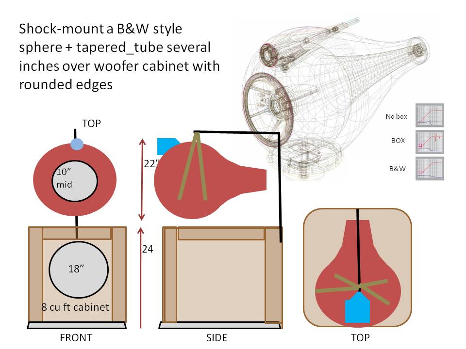

I think the ideal midbass cabinet is shaped like a sphere to allow the cone rear wave DYNAMICS to EXPLODE without interference and then get quickly absorbed without any resonance by a stuffed, tapered rear cavity with a tiny open exit. With a sphere, diffraction is almost ideal but a difficult shape to construct and integrate into a multi-way speaker.
B&W 801 genius engineers did their homework. Avalon genius engineers, Focal Grande Uotopia, WhiteLight engineers worry about rear waves and diffraction using more standard construction.

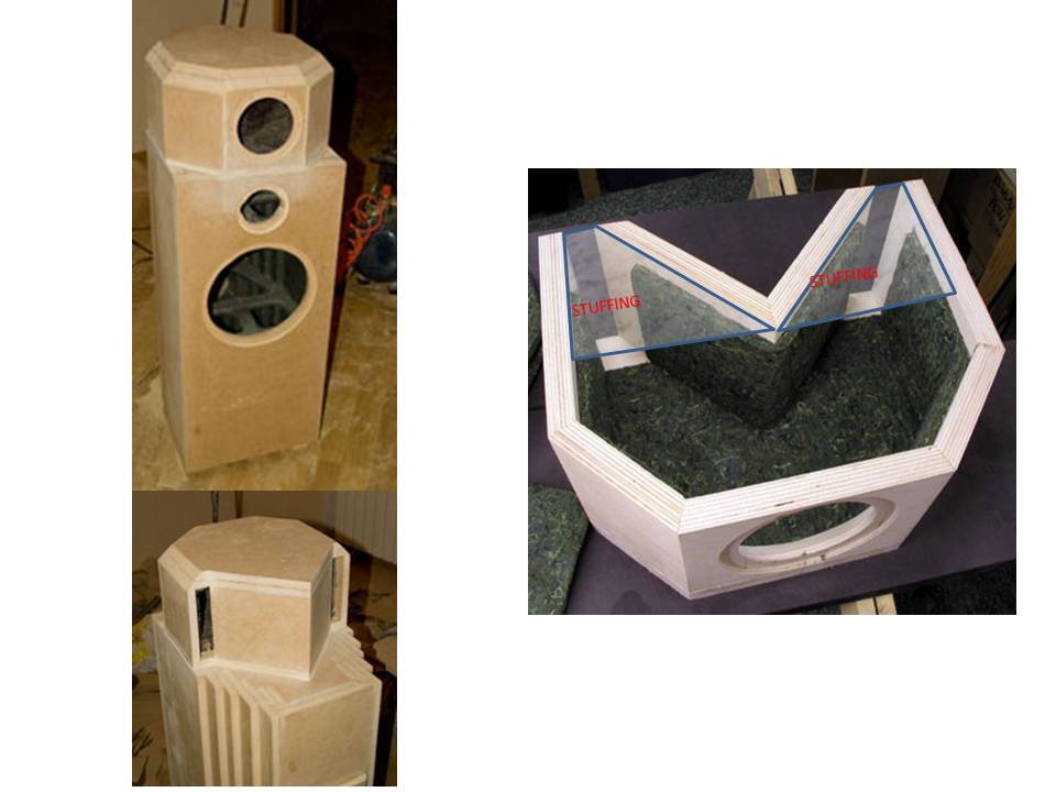

Most 10" midbass cabinets use large radius quarter round edges, or mitered front angles as shown earlier, with extensive fiberglass stuffing. For midbass, fiberglass stuffing measures best attenuation. Baffle simulation programs and DIY measurements(Aerial thread) show value in diffraction control down to 80Hz. AE Speakers use large radius quarter rounds on their bass cabinets.

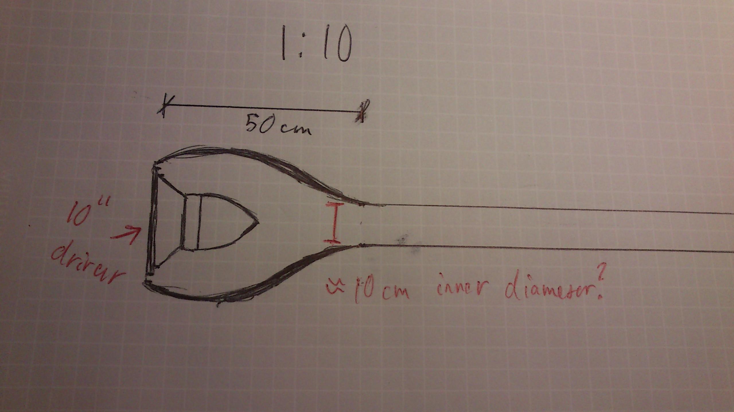

Hmm, I've just thought some more about this kind of design...
Or rather the dimentions of it. I'm toying with the idea of making a bullet enclosure like in the image and then fitting a sewer pipe on the other end.
The question is how large the rear pipe diameter has to be though... could I get away with a pipe with ~ 10 cm inner diameter when placed about 40 cm away from the driver like in the picture or would I need a larger diameter on the pipe?
In practice the rear pipe would be bent of course, those nice buyable 90 degree angles sure look interesting and probably much easier and better to use than trying to build my own snail shaped box 😉

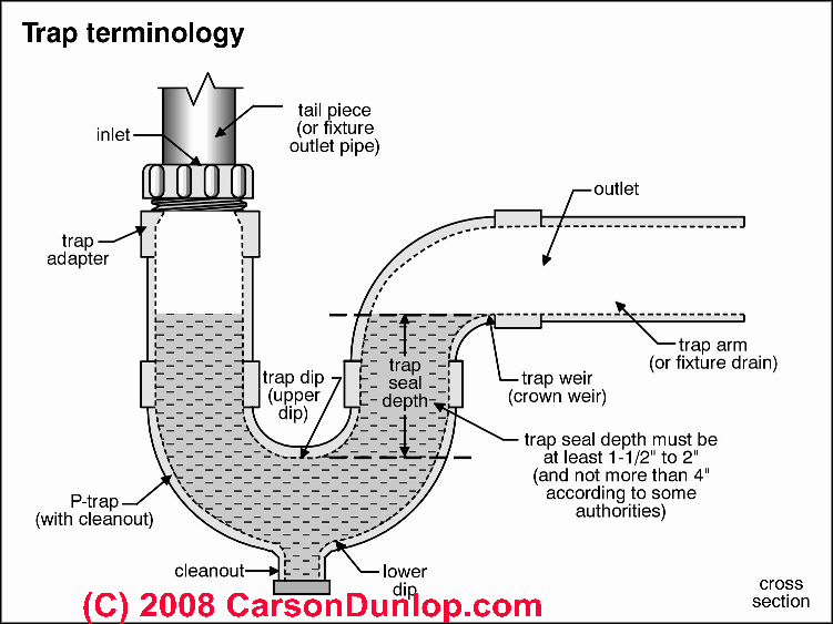

Make sure you connect a proper trap before connecting it to the local sewer. Otherwise there is a real chance of fumes getting back into the house. Most houses use a 4" service.
Regards
