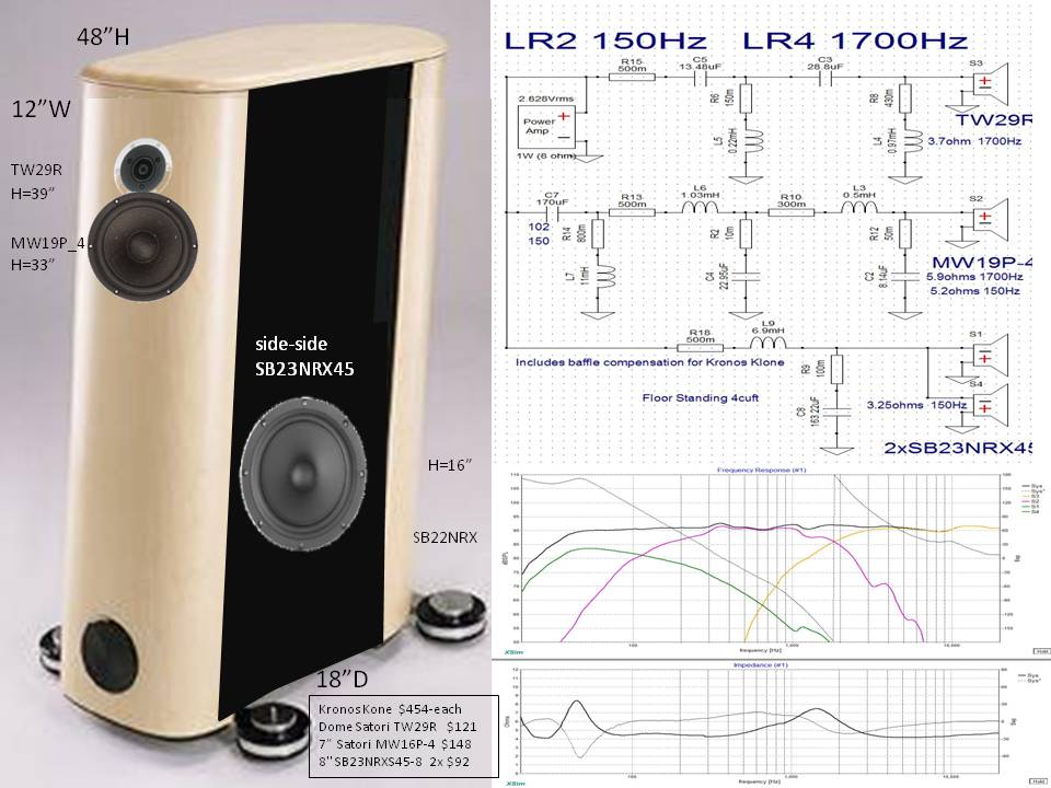

What about the Satori MW19P-4? At 7.5" it would seem a good directivity match at ~2khz, has very flat FR from 200 up, low distortion and reasonable sensitivity at 91.5...
An LR4 crossover at 1700Hz between the Satori MW19P-4 midbass and Satori TW29R tweeter provides good attenuation of the MW19P cone breakup, and also a smooth polar transfer to the 1.1" TW29R dome. The MW19P just starts to beam ~1700Hz, so the tweeter baffle placement will control high freq 2-PI to 4-PI transistion.
Decisions on baffle shape will also shape the soundstage. A narrow front baffle with large(3") radius edge treatment can smooth the upper midrange, but also put greater demands on the woofers. A wider baffle will "drive" more midrange sound to the listener and less into the room, plus support a sharper and lower frequency transfer point to the woofers.

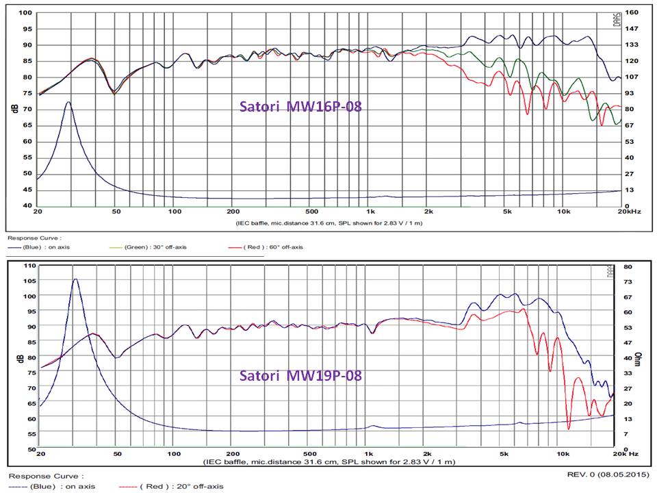

The factory SPL measurements for the MW19P and MW16P both look like excellent midbass candidates.

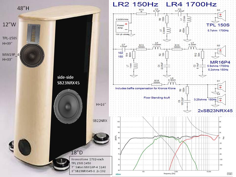

Kronos Klone Cabinet with Beyma TPL-150S(no-horn) and Satori MW19P-4. LR4 at 1700Hz shown. LR4 at 1800Hz should have acceptable polar match.
High cost of TPL-150S seems to demand much higher efficiency midbass.
