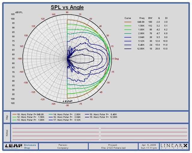

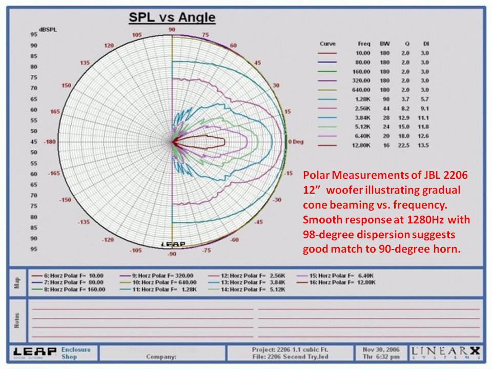

You can find good quality polar measurements on a few of the more popular midbass speakers like: the 12" JBL 2206 which shows a smooth response at 1,280Hz with 90-100degree polar directivity; and like the 10" JBL 2123 which is used by Disneyland with a ~1,200Hx crossover to a 120-degree horizontal polar pattern horn, and by some diy-audio with ~1700Hx crossover to a 90-degree horizontal horn. Sometimes the vendor SPL/freq data includes 15-30-45 degree curves with enough data for a leap of faith.
Polar/beaming estimates from the cone diameter can be a crude first estimate, but the cone shape, the width of the edge suspension, the dust cap, etc.... can create variations, and also poorly estimate break-up and resonances. You want a SMOOTH polar pattern on both sides of the crossover frequency.

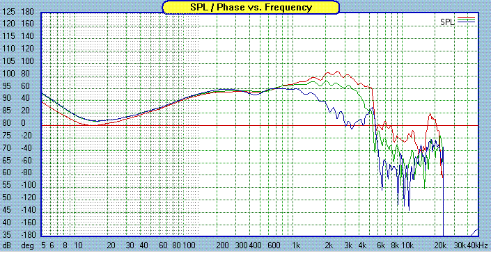

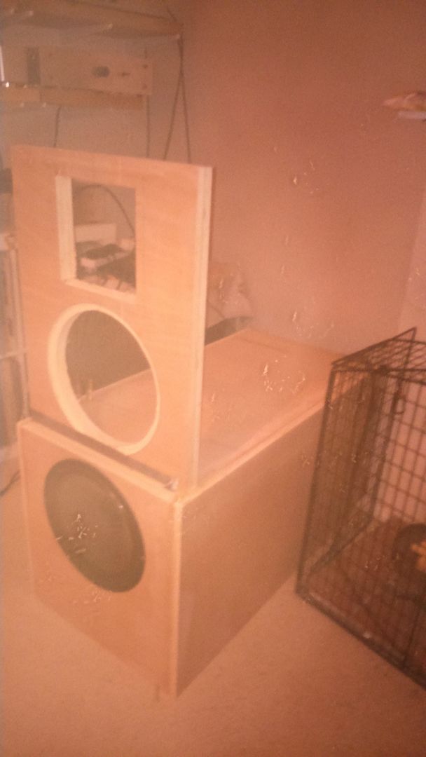

I'm going to try this with goodmans audiom 61(97-98db/w) in the blh to 100-250hz then an axiom 301 open back to 2k to the tpl150h. I'm keeping a close eye on the horn loaded cone driver thread as I like to try a 6-8" mid horn loaded to keep the tpl150h 's efficiency. It'd be great if someone could recommend a horn design and driver that would do 220-2k, I'm a bit lost with all the different designs being used.

Hi Enzo.
How is your midrange horn coming along?
