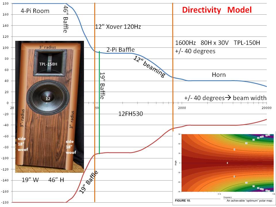

I'm thinking of getting a pair of tpl150h. I currently have diy speakers based on vintage goodmans axiom 301 run in parallel with audiom 61, these 15 ohm12" units are mounted as close as possible vertically with a beyma cp21f mounted close to the outside edge next to the goodmans. The axioms go to 10k and are 97db/w and the audioms to about 6k with the same sensitivity, so upwards of 100db/w together. They are run ob. Obviously there is noticeable loabing etc but the axioms sound really great to me. The cp21f is crossed in at 10k. I'm very much not a speaker guy, tube amps are my passion, but what would people's opinions be on a tpl150h mounted above the two goodmans crossed at about 2k? I have some eminence delta15 h frame subs under the goodmans, but often prefer them without. The current speaker walk over my old audionote an/ed's for speed, naturalness etc, but the ob nature helps massively in my room which has really terrible acoustics
I'm thinking of getting a pair of tpl150h. The current speaker walk over my old audionote an/ed's for speed, naturalness etc, but the ob nature helps massively in my room which has really terrible acoustics
YOU MUST GET POLAR SPL DATA on your Goodman12
Dr. Geddes white paper on controlled directivity could provide the big picture information to help you pull together your room with your speaker goals. Geddes recommends starting at 20Khz and using a tweeter horn/waveguide down to ~1000-1400Hz to control the polar response to best manage the room and listening position. Control/avoid early high frequency reflections. Geddes… run your Goodman12 up to ~1200Hz and cross to a horn/waveguide.
Sketch your room using the best speaker and listener position options. Decide how much room/wall interaction you desire for “reflected ambience” sound. Measure the polar response of the Goodman12 from 800-2000Hz. Select a horn/waveguide with the polar response that MATCHES THE POLAR RESPONSE OF THE GOODMANS AT THE CROSSOVER FREQUENCY. TPL-150H 80H x 30V; LeCleach ; SEOS15 90H x 40V ; 18Sound 60H x 40V
http://www.gedlee.com/downloads/directivity.pdf
The value proposition for the TPL-150H is: exceptional dynamics; excellent detail; exceptional efficiency; high max SPL; starting at ~1600-2000Hz; with 80H x 30V polar pattern. So… YOU MUST GET POLAR DATA on your Goodman12 around 1600-2000Hz before attempting this marriage .
Common compromise: If you want to run the Goodman12 above 4Khz, a horn tweeter like the Fostex T90A is often the accepted compromise.
The Beyma CP-21/F has a wide 140-degree horizontal dispersion...which will not match/blend well with an extreme 4Khz beaming Goodman12.
Thanks for your excellent responce, I'll do the research you suggest! It may be that the goodmans would be wasted in this configuration, crossing at 1kHz and that a tpl150h would be better matched to another project
The Beyma TPL-150H favors being crossed at ~1,600Hz or above. There are a few 1" compression drivers which perform well when crossed at 1,000Hz, and several when crossed at 1,200Hz and above in good tweeter horns. The TPL-150H is attractive for "horn tweeter" + cone midwoofer + subwoofer designs.
When you sketch your room and listening area, what horizontal horn angles cover the seating positions(couch, chairs) with modest splay around the room? Home Theater couch seating often favors 90H x 40V. A basement man-cave with a 2-seat couch might favor 60H x 40V to avoid reflections off concrete walls.

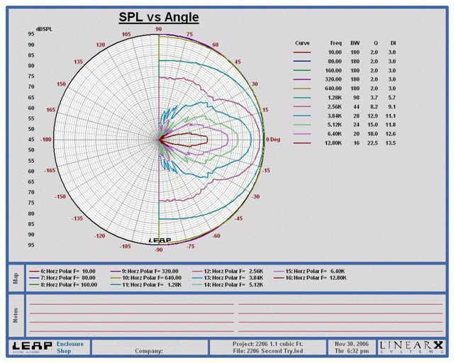

Polar Measurements for the 300mm(12") JBL 2206H show:
1) Below 640Hz a 180 degree polar pattern is generated on a infinite size baffle.
2) At 1280Hz a 98 degree polar pattern is generated on an infinite size baffle, and the SMOOTH plot measured polar pattern shows that the cone is free of major(wimpy cone) resonance modes and high frequency resonance break-ups .
3) Estimate that near 1,500Hz a 80 degree polar pattern is generated from cone beaming. A vibration on one edge gets canceled by a vibration on the 1,500Hz-wavelength opposite edge of the cone. A smooth polar match to the 90-degree horizontal TPL-150H horn is possible. Without a good polar match at the crossover, SPL energy from one driver will beam, as heard by the listener as irregular_SPL and irregular sound stage queues.
4) A real baffle with a width of 19" would show a reduction in forward 180 degree SPL radiation around 700Hz(19" wavelength), with a irregular increase in rear 180 degree SPL. irregular = edge effects, side effects, wall effects, etc..
5) At 2,560Hz, the rough, and irregular shape polar pattern on this JBL 12" illustrates multiple cone resonance modes and high frequency break-up. A steep slope Xover is needed.

Hmm, okay... If you scroll down towards the end of this image gallery you can see what the room looked like Minhembio.com - Hemma hos dac83 - Nya Bio Bygget Del 2
I can't answer by looking at the images, except to say that we can rule out bafflestep. If you have a measurement of both systems overlaid on top of each other in the listening position, we'd no doubt see a significant different in the low midrange region. But the key point in answer to your question "no - lack of warmth is probably not an issue with TD12M."
