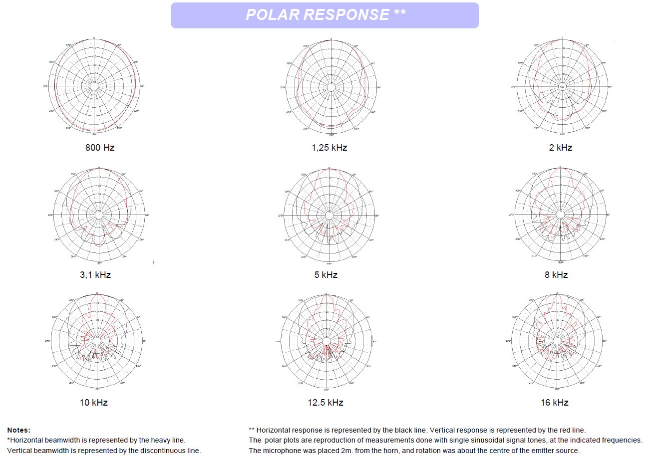

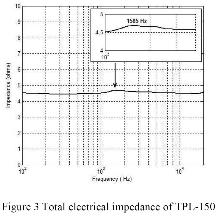

I think the TPL-150H needs to be crossed over at 2kHz based on all measurements that I've seen. Fs is 1.5-1.6k with a ringing resonance, there is a dip at 1.7-1.8kHz and distortion increases below this frequency regardless of back cup on or off. Maybe 1.8kHz is doable if crossed over steeply. Crossing higher (2.2-2.5 kHz) to a 6.5" result in CTC spacing larger than 1/4th wavelength.
Consequently, a mid with an Sd of 175-200 cm2 seems to be the best match directivity-wise, which means 7-8" depending on manufacturer's definition. A typical 8" with Sd 220 cm2 probably has best match at 1.8khz but perfect directivity match is most likely less important that resonance and distortion and signature so 2kHz may still be a better XO.
I think the right 8" mid in a 3-way doing 200-2000 Hz together with the TPL-150H doing 2-20 kHz and a suitable woofer, say JBL 2245H, doing 20/30-200 Hz could be nice.

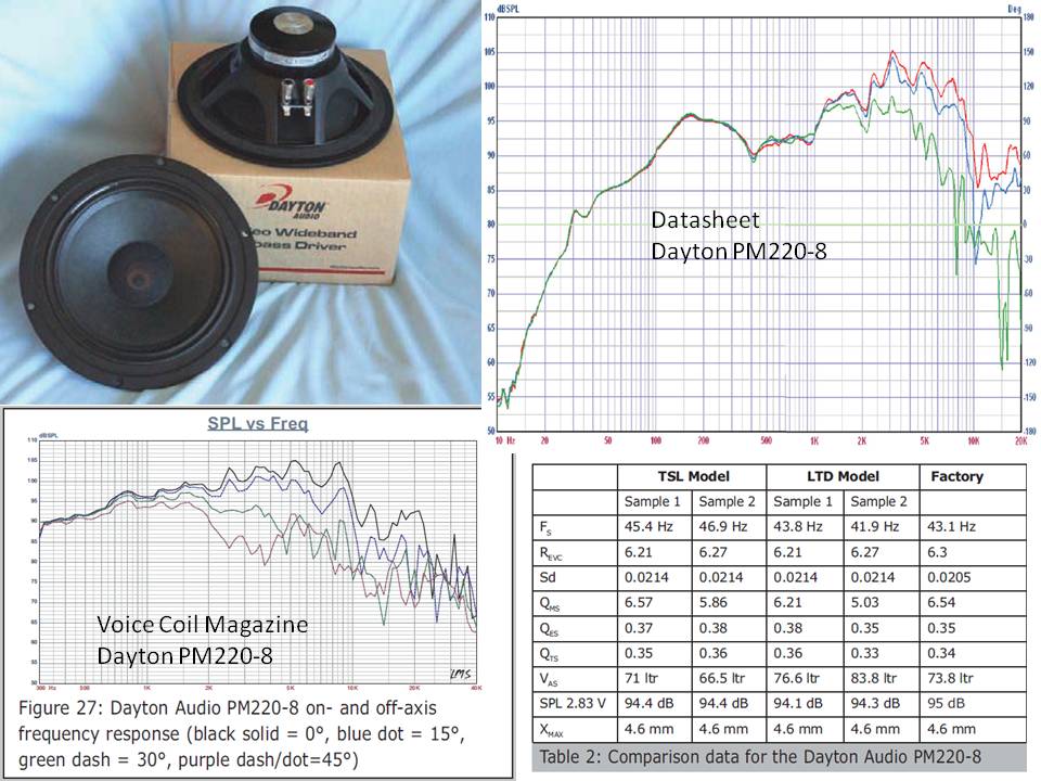

Of the BMS drivers, I'd think the newer 8N519 looks good. Of the Daytons, I'd think the PM220 is better for the task than PM180 that was mentioned. Problem is that most of the hifi-oriented manufacturers stop midrange specific drivers at 6.5" typically, with 8" having more woofer oriented TSP. AT 18H52 has an Sd of 174 cm2 (but low sensitivity). OTOH, Per Skaaning could probably make you whatever driver you want based on any of his core chassis if you cough up. There's also a rumour a 7.5" Satori will be released soon, which could have the right Sd as long as not inflated nominations, but sensitivity is of course bound to be low, necessitating active filtering.

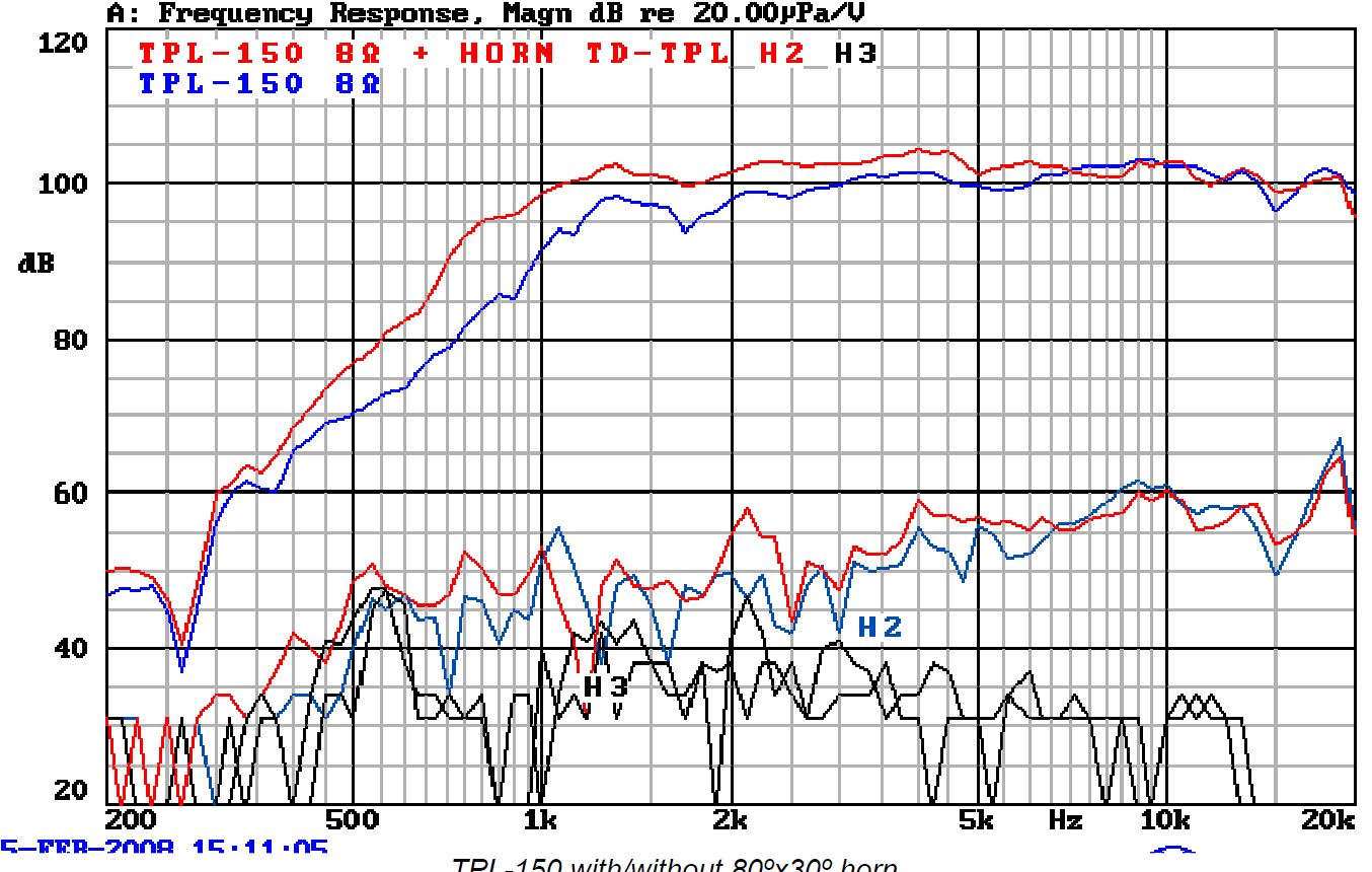

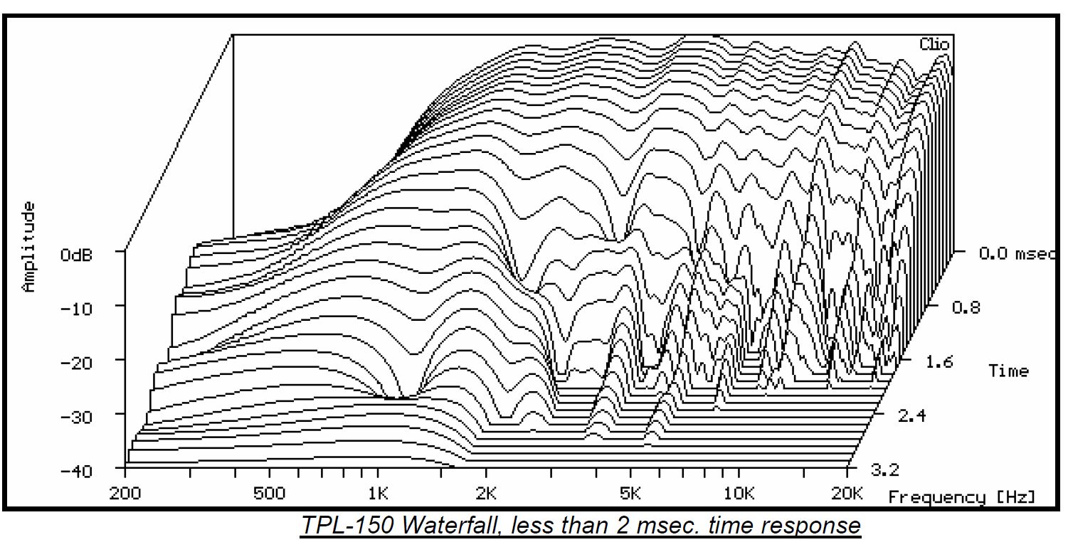

2008 Beyma measurements of the TPL-150 and TPL-150H at 1m and 1watt.

FYI... Voice Coil measurement of Dayton PM220-8 you mentioned ... not as scary as the Dayton datasheet.
