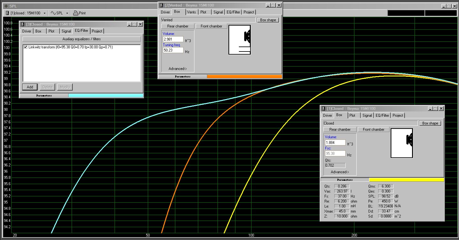

The old(2013) 15MI100 datasheet showed Fs=48Hz and Qts=0.28, and Xmax = just 2mm and Le=2.3mH.
The new(2015) 15MI100 datasheet shows Fs=37Hz and Qts=0.29 and Xmax=4.5mm and Le=1mH. A better midbass, but still not a woofer.(WinISD posted: sealed F3=96Hz and ported F3=50Hz)

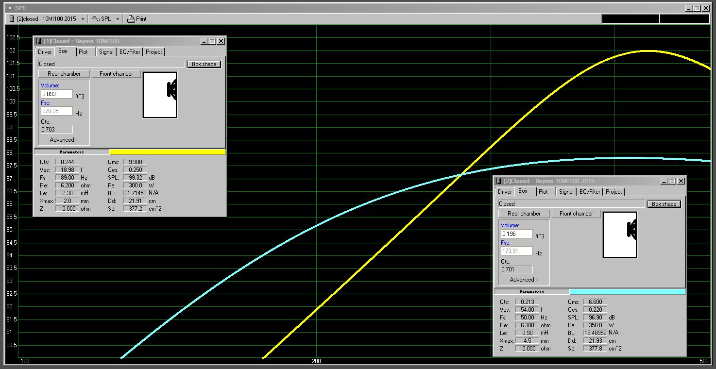

The old(2013) 10MI100 had Fs=89Hz and Qts=0.25 and Xmax= just 2mm and Le=2.3mH, and seemed designed for use in a horn.
The new(2015) 10MI100 has Fs=50Hz and Xmax=4.5mm and Qts=0.21 and Le=0.9mH, and now looks like a useful midbass, and possible partner for the Beyma TPL-150H tweeter. (WinISD posted: 97db/w sealed F3= 170Hz)
