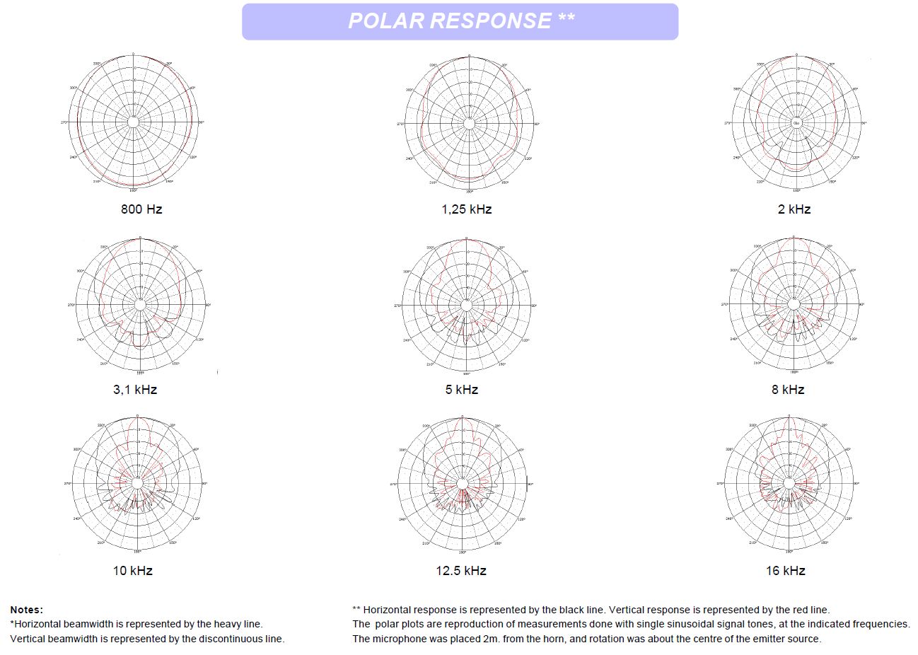

Both the midbass and the TPL-150xx must have the same polar response at the crossover frequency for a smooth controlled directivity function.
A TPL-150 without any horn has a 180degree polar resonse at 1600Hz on a wide flat baffle. Several midbass up to 6"-6.5" polar data show a 180degree polar response up to 1600Hz on a wide flat baffle. The Satori midbass has great reviews, but just reaches 1600Hz and is only 87db sensitivity.
A TPL-150H with the factory horn has a 80x40 degree polar resonse at 1600Hz on a wide flat baffle. A few midbass around 8"-10" have a 80degree polar response at 1600Hz on a wide flat baffle. The Lambda TD10M, and the Tang Band W8-1808 with the whizzer removed are mentioned.
A TPL-150H with a custom horn can provide a 60x40 degree polar resonse at 1600Hz on a wide flat baffle. A few midbass around 12" have a 60 degree polar response at 1600Hz on a wide flat baffle. Cone beakup is a big concern. 18 Sound 12" 12NMB420 with a 33g Mms is also worth consideration with the Beyma 12P80Nd and Lambda TD12M.

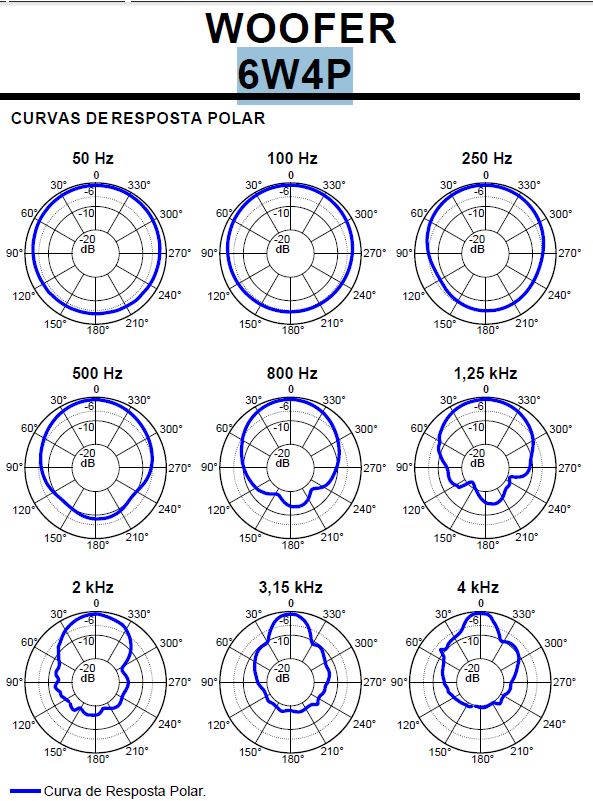

Do you mean to say that the Satori polar response is 180deg only up to 1600Hz? That's true of any 6" driver. Just to clarify, Satori useable bandwidth extends above 1600Hz. Are you suggesting an even smaller mid driver to preserve power response on flat baffle? Thanks
A 2khz 2nd or 3rd crossover slope will be kicking by that point so the off axis effects are less.
Richidoo, I was sloppy in my earlier post and used 180degree to describe the idea of a wide polar pattern, where >120degree polar response would be a more accurate description of the physical limits of the AMT width and the speaker cone diameter. A 5" moving diameter cone polar response would first start to narrow at 1/4 wavelenth(680Hz), with a >120degree polar response at 1/2 wavelength(1360Hz).
For a 1600Hz Xover, a 6" - 6.5" midrange with a clever cone profile like the Satori is probably the largest diameter usable with the TPL-150 for smooth controlled directivity polar response with a >120degree wide M-T transistion polar response. Most larger diameter speakers would likely benefit from a TPL-150(HORN of some type).

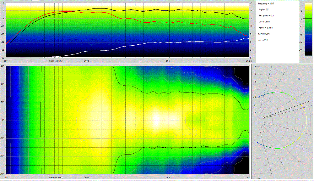

A TPL-150H with the factory horn has a 80x40 degree polar resonse at 1600Hz on a wide flat baffle (attached). A few midbass around 8"-10" have a 80degree polar response at 1600Hz on a wide flat baffle. The Lambda TD10M, and the Tang Band W8-1808 with the whizzer removed are mentioned.

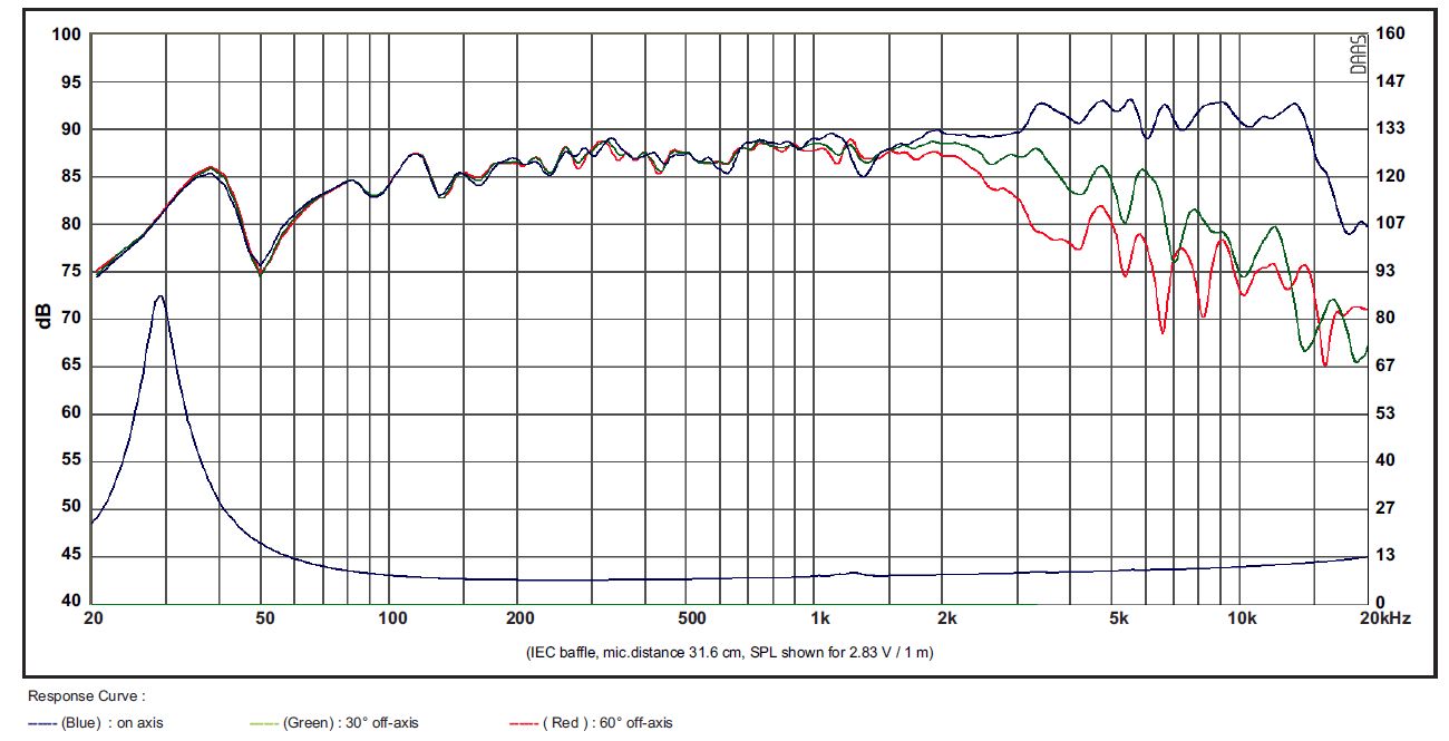

The B&C 6md38 has a curvilinear cone and doesn't narrow until about 2khz on a 12" baffle. It's a solid 95db efficiency and shouldn't need any baffle step to 250-300hz in a small sealed seperate chamber. It's an excellent sounding driver to my ears and it's distortion profile meets or exceeds some the best HiFI midwoofers I've ever compared. At less than $90 it's a steal IMO.

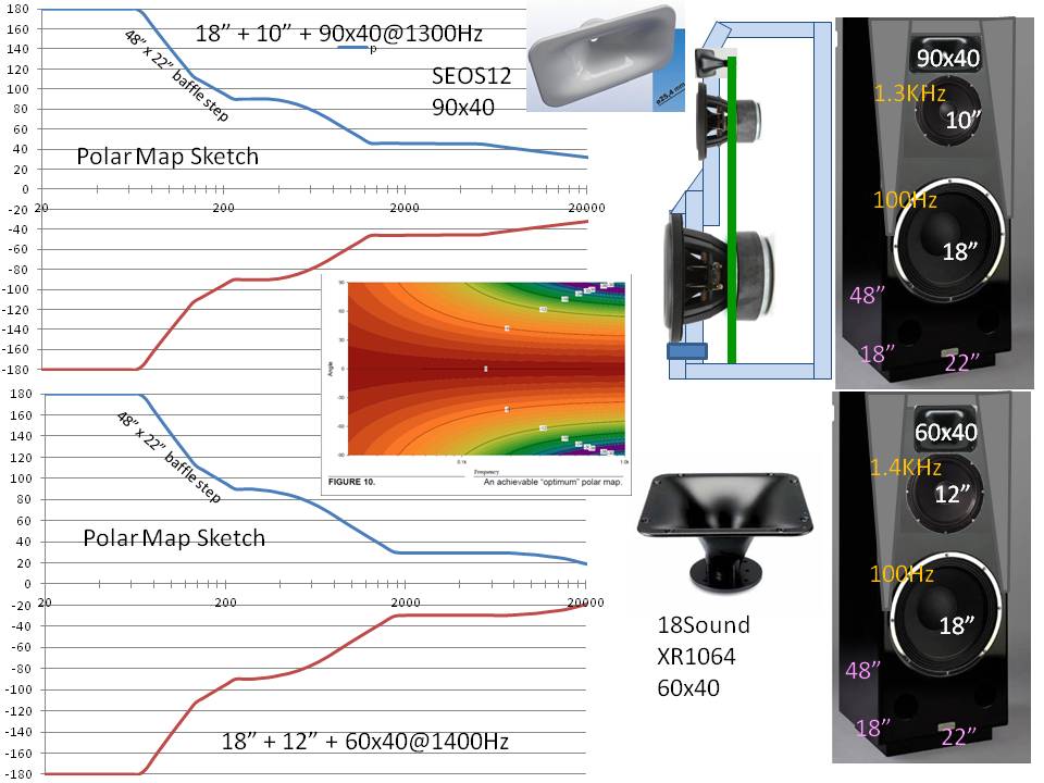

1) TRUST STIG: "The TPL-150xx driver benefits from removing the rear chamber and felt damping pad, and allowing the rear exit into a large damped chamber. THD is reduced by almost 20 dB by doing this." worth repeating here!
2) Greg.... it has become common to sketch a controlled directivity function goal for a new speaker.... has your studio set polar pattern goals?
---deep bass will have a 360 polar pattern
---the baffle width will set the shift to a 180 degree polar pattern
---room/wall placement will affect deep bass and lower midbass polar pattern
---midbass beaming will start the polar pattern shift to match the tweeter @Xover
---physical dimensions of the tweeter will set the high frequency polar pattern
