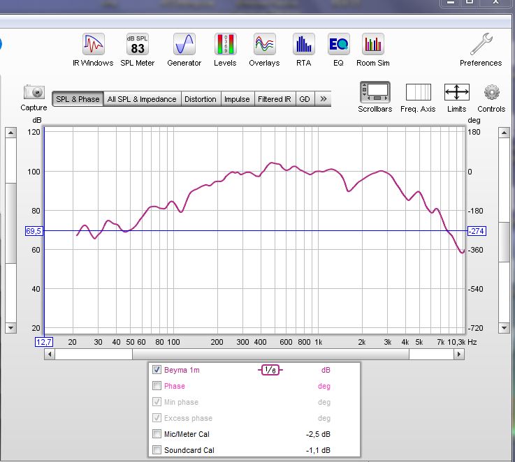

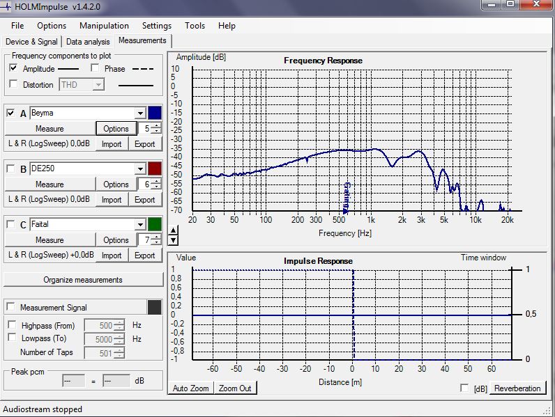

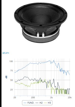

Hi Everyone. I'm looking for a big midrange driver and need your advice.
I need a 10" or 12" midrange driver mated to DE250 compression driver in SEOS 12 on top and active DSP driven, sealed subwoofer on bass. This midrange would probably work in small, sealed box and cover circa 150hz - 1500hz bandwidth.
I've already tried Faital 12PR300 wich is a wonderful driver. Very flat response gives a lot of crossover possibilities. While sounding great I wanted to check if there is even more to gain in terms of detail in 500-1500hz band.
Therefore I decided to try out Beyma 10MI100 wich look like a killer drivers for my purposes. UInortunately I'm not very fond of it. It has a significat dip in response at 1.5khz. This leaves me no space to play around with XO. Crossing over has to be at around 1.2khz. Leave or take it.
1200hz is doable but I just don't like to be limited that way.
I've contacted Beyma and they claim that they changed construction of the midwoofer a long time ago but forgot (!) to change datasheets !!!
Now I can exchange it to something different so I'm looking for alternatives.
Improving 500-1500hz range is my priority so I'm looking for something with flat response and extreme BL/mms ratio.
Of Beyma offering I like two options so far
Liberty 8 - 12E120
and
12MI100
and maybe
12P80Fe
I also like 18 sound 10m600, B&C 10MD26 and Faital 10PR410 but the're little to expesive for my budget.
You guys have any advise? I'don't listen loud. Just with 4W SET amp for highs and midgrange.

For your information: Beyma 10MI100 advertised vs measured. They claim that they forgot to change datasheets.
