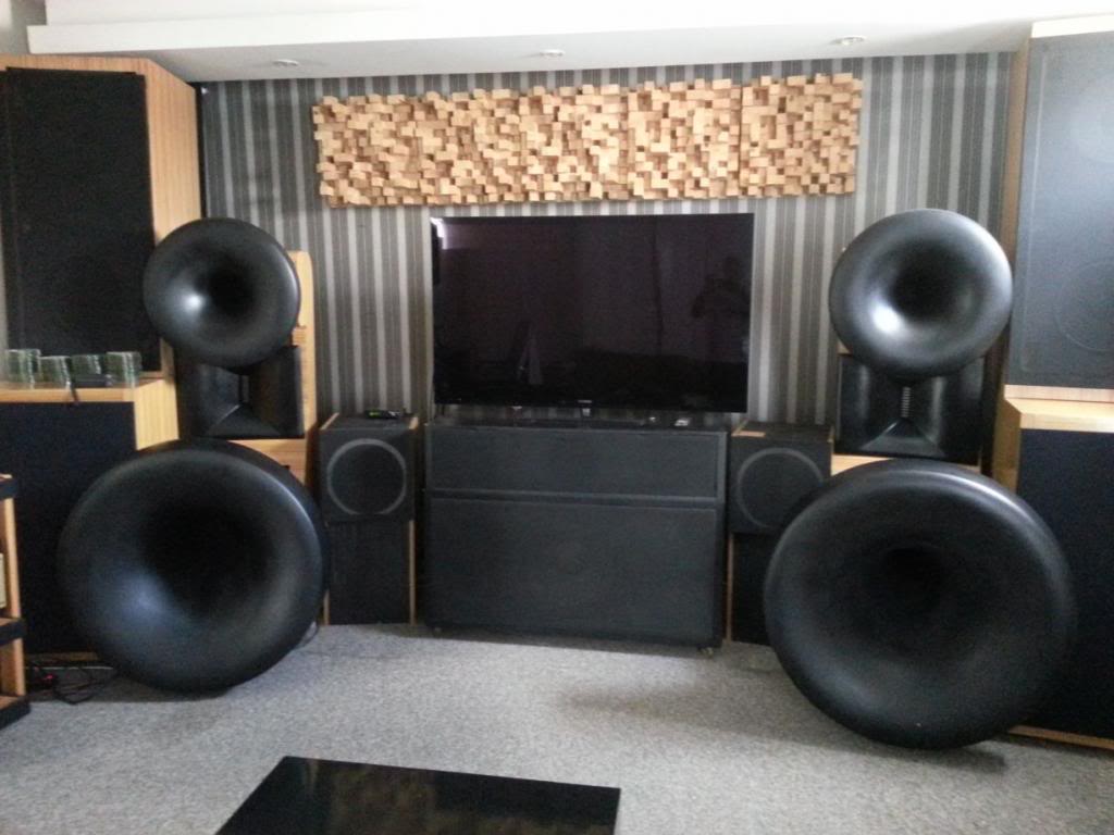

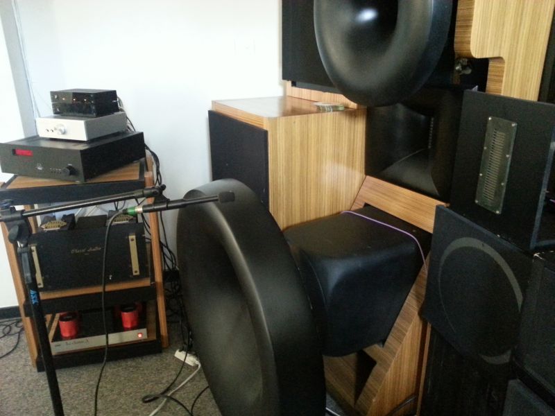

Angelo, do you have any pictures of your 12p80nd+TPL150 build? I'm really interested in that combination.
well, my agroupation of the two speakers is not a example to be followed, since i just made a rudimentary experiment initially, and built the 12p80nd into a cabinet i had around ( which i made for a Audax Cleveland bass ) , and it remained there until now.
below a picture of my system as its now.

Wow, impressive setup!
Is it the Beyma with the silver rim around it?
yes, thats where the 12p80nd is mounted. It tops by far my lower midrange horn with Fane Studio 8m. ( which sounds muddy and colored in comparison ).
The 12p80nd sounds incredibly defined and fast and natural, amazing for a 12" to have this sort of definition in the mid range, a gourmet for the ear. A real out-performer. 😉
Sounds very interesting! How do they handle dense rock music? Or how about electronic music? Do you use any subwoofers or are they good enough to take care of the bass as well?
Well. These rock the house. Literally. I mean, these are meant to be P.A. speakers. Undistorted performance with hudge headroom. Its good to have a sub below, in the lowest register its rather shy, but if you have nothing to add, its ok .
