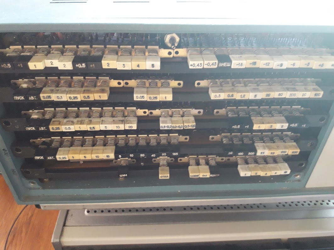

We have two devices "Canal-2" ("Канал-2") at one of the laboratories at my work, they are analog (tonal) channel simulators. They simulate analog telephone lines so students can practice how to measure basic line parameters (frequency response, attenuation, etc). And both two were rather bad but worked somehow (worked good/bad enough to carry out students laboratory work), and they totally died in the last year.
I'll attach a photo I made (I have only one photo, w/o front panel), so it was easier to understand what a device is.
It has regulated power supplies, and 5 large PCBs: mainly analog circuitry (old opamps, 741 clones), and one or two PCBs mixed or digital (old TTL IC) with a lot of mechanic switches and ICs.
We don't have (or couldn't find) any documentation.
I checked the power supply first, looked at PCBs, and realized that I have to check electrolyte caps first. So I took my ESR-meter and almost directly found dead caps (in-circuit). Middle-sized electrolytes were ok, but about half of all small electrolytes (10-47 uF 16V) were dead or between life and death. There was absolutely no reason to unsolder and measure them with RLC-meter. I had some amount of surplus caps and replaced all dead ones in the first device. The device started to work immediately - it was showing a signal similar to what we wanted to see.
The next day I bought more caps and replaced all electrolytes on PCBs in the second device.
Yes, of cause, there are a lot of possibly faulty switches in these devices - but we checked em first (before all of that) and they were not the main reason (it was done without my help, but I had checked them roo, w/o unsoldering, just by pressing on/off).
I haven't checked the parameters of all new caps, I just measured the ESR/capacity of a couple of them.
So, now we have two working devices instead of two dead ones. If it was a good or bad repair? Hmm, from my point of view it was a good job.
