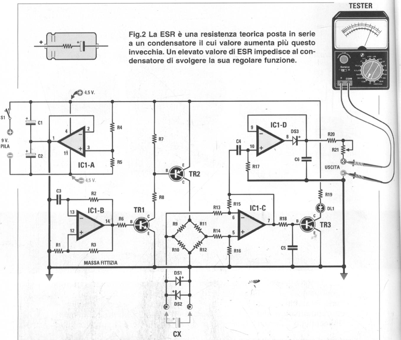

ESR Meter
under this very old website under
Repairing Switched Mode Power Supplies (SMPS) | All About Circuits
I read this:
A very useful tool in checking and diagnosing electrolytic capacitors is an ESR meter. This tool allows for a quick check of all electrolytic capacitors without removing them from the circuit. I built myself an ESR meter based on this article which is itself a practical building of a design published by the Italian magazine Nuova Elettronica N212 as kit 1518. I made some modifications (which I think are improvements) to that design and the device has been very useful to me in repairing power supplies. An ESR meter does not measure capacitance but ESR (duh!) which is a very good indication of a capacitor's health and well-being. I recommend this tool and understanding how it works to anyone who will be repairing power supplies. Besides this one there are plenty of designs out there which can be easily and cheaply built by the amateur. One thing I like about this one is that it signals if the cap is shorted. This is very important because a shorted cap looks ideal with regards to ESR. The building of such an ESR meter would be a worthwhile project for anyone who does not own one.
maybe of interest
Esr tester for capacitor
Nuova Elettronica
Components from attached schematic
R1=1K5, R2,R3,R4,R5=10K, R6=68K, R7=4K7, R8=12K
R9,R11=1K-1%, R10,R12=22-1%,R13,R14=1K
R15,R16,R17=47K, R18=15K, R19=680
R20=2K2, R21=20K TRIMMER
C1,C2=1uF electrolytic
C3=1NF POLY, C4=100NF POLY, C5,C6=1microF POLY
DS1,DS2=1N4007, DS3=1N4148, DL1=LED
TR1,TR3=BC547, TR2=BC557, IC1=TL084
S1=SWITCH
