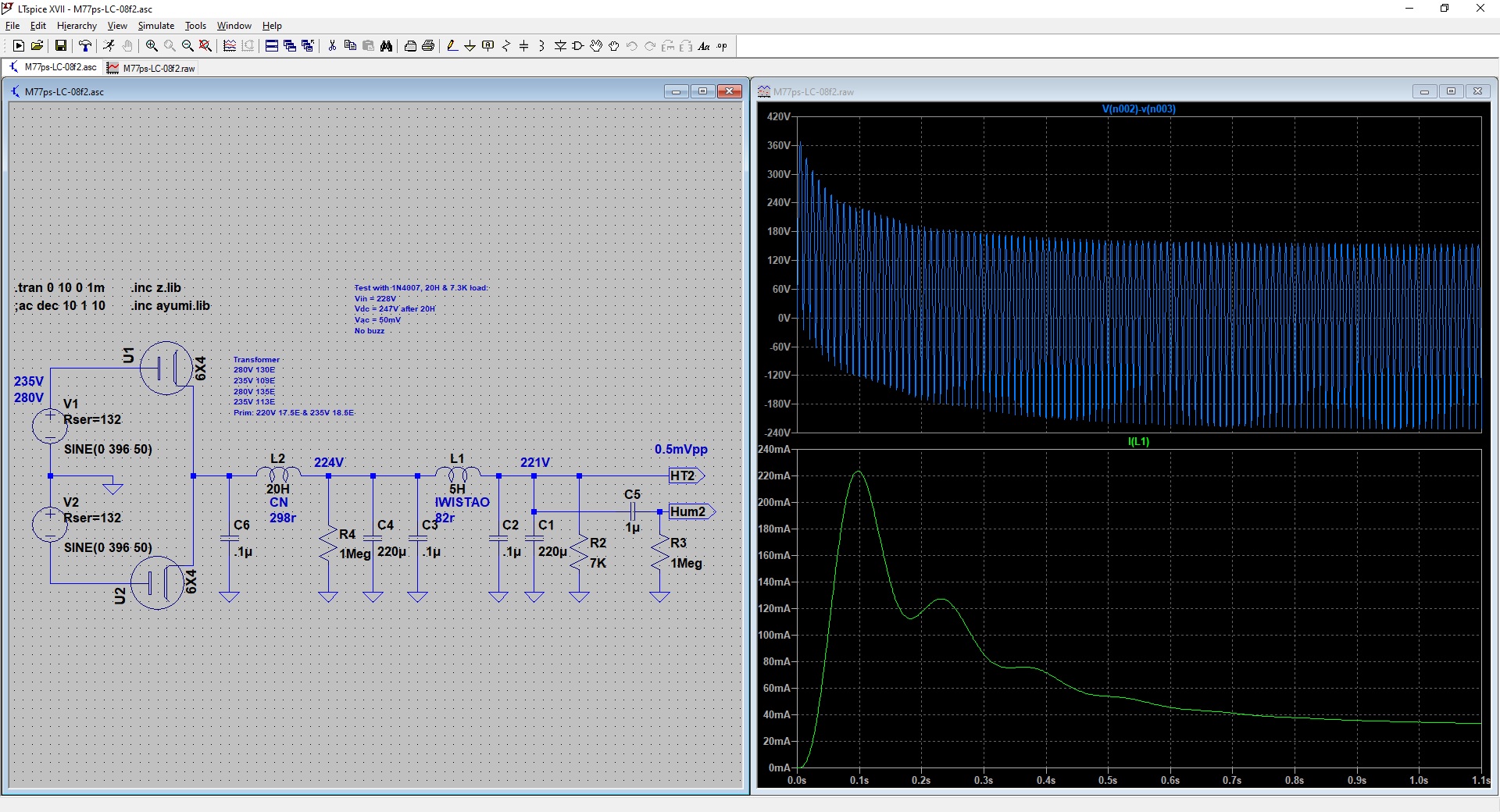

PLease try a small C before the first choke if you use choke-input. LIke 0.33uf or 0.47uF, this will reduce the stress level for them considerably (see V(L1) in PSUD2) without changing the output voltage too much and you find the sweet spot of the great macro dynamic and authority of a LC-supply combined with the quietness and fine resolution and transient response of a CLC-suppply. ... there is a way to have both...I use Duelund CAST or Miflex KPCU1 there for low voltage and Mundorf silver/oil for 1000V.

PLease try a small C before the first choke if you use choke-input. LIke 0.33uf or 0.47uF...

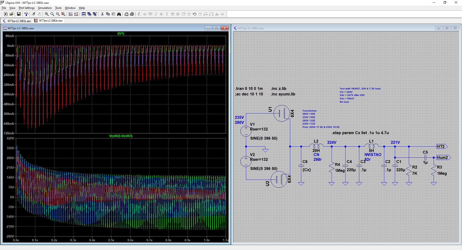

That's what I did for my preamp: playing with that small C, you can go all the way from CLC (top trace, 4.7uF) to LC (bottom 3 traces, 0, 0.22u & 0.47u). Beware the resulting voltages also vary by quite a bit, from Vac to Vac*SQRT(2); and the current, inversely.
More importantly, you want to look at the AC- voltage across L2 in your schematic (so your choke-input choke). You change the stress level dramatically for the choke if the first C becomes bigger...
...in return you need to look at the current spikes and form of your transformer...you basically stress the transformer enourmously more when going to pure CLC...so the trick is, to find a good compromise and give the choke AND the transformer a nice, less stressfull environment to work in with lowest EMI.
In your case i would bet its a 0.22 or 0.33uf cap. Why dont you just pit a little switch into your psu, so you can switch those values in and out without even powering the amp off ? Thats what I do to find the right value...and as we talk about small differences in value, HV is not changing a lot (more than 0.47uf in your case will sound not so good anymore, you loose the choke input advantages at that point, things will sound less authentic, less dynamic, less real).

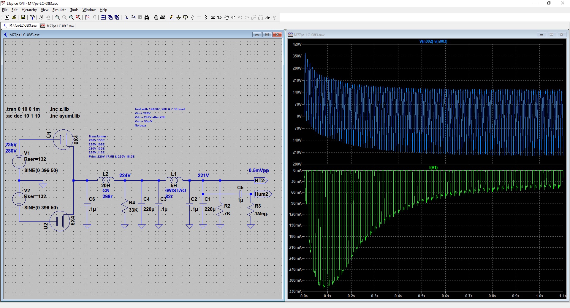

... you want to look at the AC- voltage across L2 in your schematic (so your choke-input choke)...
The voltage is OK, green trace, 2:1; the current is more scary, blue trace, 10:1, with the 0.1uF I chose... 🙂
With a LC filter, the head L is 10% science, i.e. L>>>L(crit) = RL/1000, DCR, etc.; I had 1 case of an inductor buzzing like hell with these sciences.
Then I figured there must be 90% voodoo, i.e. Imax>>>Iactual, size & weight (indicative of the copper & iron structure, the bigger the better), look (indicative of the care the part is designed and built). After I started applying the voodoos on top of the sciences, I no longer have any case of buzzing. The L2 in the example, I picked it up myself in Shenzhen (CN) for 10 bucks, and it's quiet as a grave.

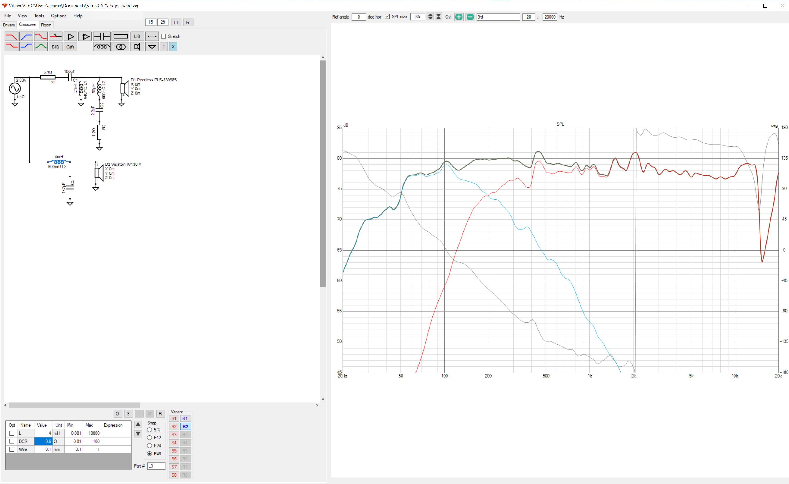

Hi, if i didnt want to spend 60-100aud per cap when dealing with a 100 or 150uf, is there such a thing as a budget friendly option that doesnt sacfrifice too much on the audio side of things? IE going a non polarised 100v cap option?
I've only ever constructed some basic BSC's so i honestly have no idea.
I've attached my fast crossover i'm going to build for reference incase people are interested what im using it in.
I would use Mundorf bipolar/plain smooth foil ECap70 | Mundorf EB GmbH two 47uf with connecting them reverse ro each other, like the old Blackgate bipolar trick.

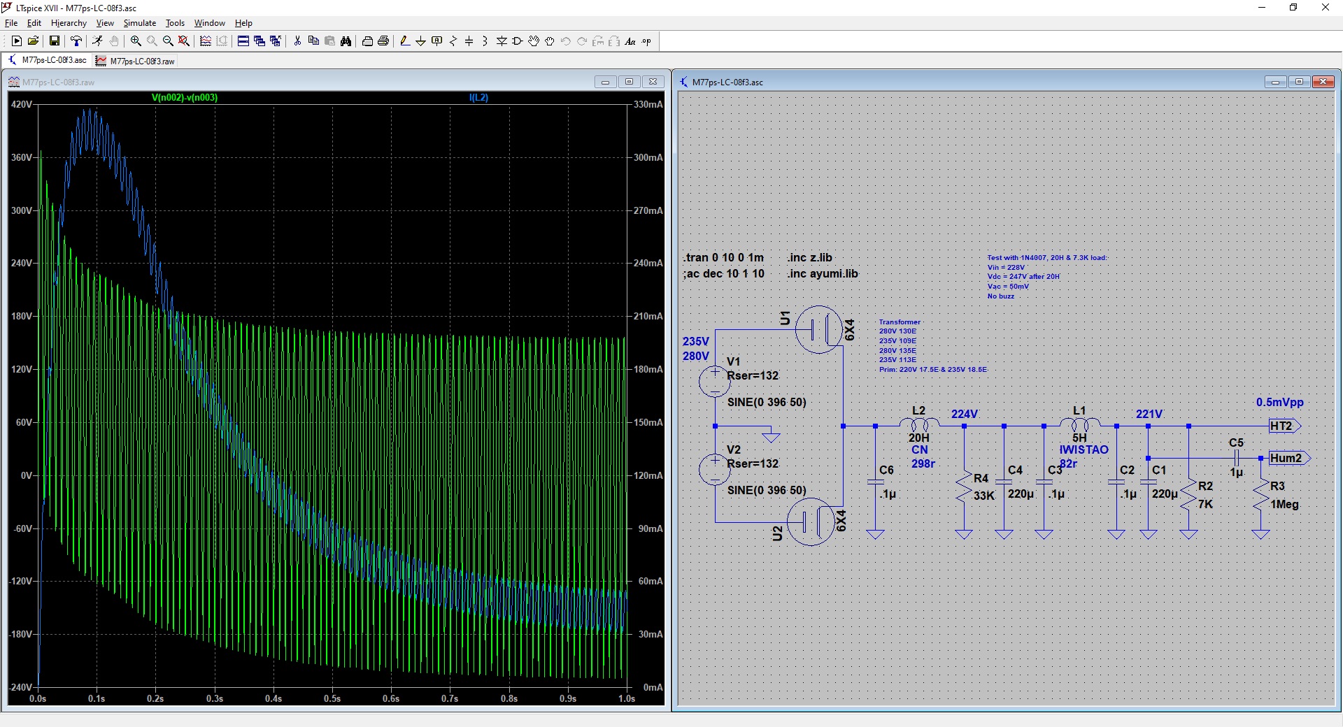

If you do your simulation comparison with the same cap values you used before, but just stay in one picture with the V(L2) and in a second picture I(T1), we ll learn something. Then you can see nicely the game of giving less stress to the choke (when the first caps grows) vs. increasing the stress to the transformer at the same time...
Besides manufacturing topics, the ratio of AC-voltage vs. DC-current in the first choke is important to understand when having a buzzing choke...so, the more DC-current there is, the more the choke gets clamped together by the current and the quieter it will become. The lower the inductance, the more important this factor becomes.
I meant V(L1) and I(V1), so the later one. If you now do the same sim with 1uf and with 4.7uF, you will see the effect.
Thats a very nice ilustration. No, nothing to worry about, but it explains nicely why C1 has such a big effect on sound and how the stress is moved from the choke to the transformer:
We move in your example stress level choke from 360Vpp down to 70Vpp and increase the stress level of the transformer at the same time from 40mA peak to 240mA peak...
