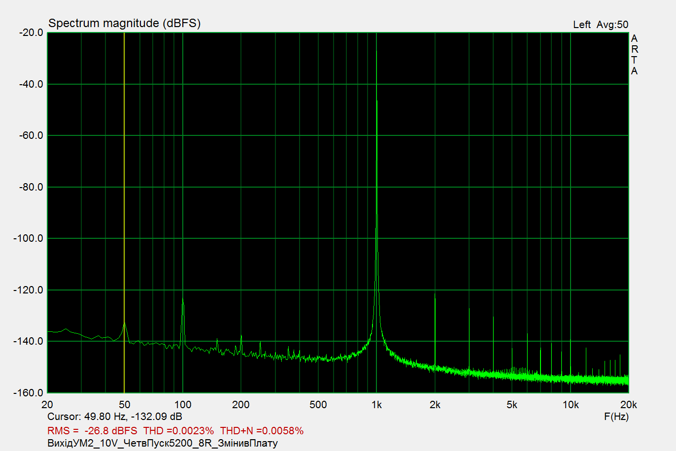

The last time I serviced/repaired an audio device - it was quite an old soviet amp (2x50W @ 8R) - I measured many caps with RLC-meter, possibly about 50-70% of them all, just for curiosity and for the experience. But then I replaced them ALL - paper type (these had bad DF and increased capacity too much, as usual. I replaced em with usual PET film), film type (replaced them with smaller size same type PET film, or with large capacity same type film, or used a better film - PP), old ceramic types (I used smaller size through-hole NP0, and a pair of SMD), and of cause - I replaced all electrolytes (I used both polarized and bipolar types). I used mostly bipolar electrolytes in a signal path (they were a great deficit in the Soviet time). I left only two large 15000(?) uF 80V caps in a power supply untouched, they are of a reliable type, and will live a long life.
Then, I replaced all transistors and diodes with actual good ones (ST/Vishay/etc). Checked the resistors (not all, but all feedback circuitry).
When I done with parts, and amplifier started to work fine, I started to check its properties, started to investigate its distortion (preamp modules then output amp). The preamp was fine till this moment (0.002% at rated voltage and load), but the output power amp PCB had too large distortion - 0.02-0.25% depends on a load 4/8 Ohm and an output voltage.
I made some investigation (it took a couple of days or more, up to a week), found a reason for so large distortion with 4 R load, changed a couple of wires onto a PCB, and now it has about 0.010-0.005% THD+N max (at any load, even at 4 Ohm). I don't know if PCB wires were intentionally wired badly by design (to have a lot of even harmonics), or it was just a silly PCB-engineer at a usual soviet plant (I lean towards the second).
Here is a spectrum at the output of that whole amp with 8R load and 10 VAC, after my service. I don't have a "before-service" picture but it was 20-40 dB worse. I haven't saved it because it was too bad for me.
