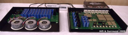

Anyway!
Have a look at this picture.
It is a preamplifier with a separate powersupply.
This is IMHO the way NOT to use elctrolytics, or even design powersupplies.
If you look here @ page 109 http://www.epcos.com/inf/20/30/db/alu_03/01010109.pdf you can see the impedance characteristics of Sikorel state of the art electrolytics.
If you use such massive amounts of capacitors as done on the picture, you´ll normally bring down ESR and impedance, and you even might be lucky not to highten inductance, but the characteristics of R vs Freq will still have the same relation, maybe even worse.
Also by lowering the impedance in the capacitorbank, you could say you move "closer" to the amplifying circuits. This makes the sound even more coloured by the electrolytics.
Smoothing caps should be used for smoothing the energy jerks from the rectifiers, when done with low or hardly any ripple left, regulation or multistage regulation can suppress it further with no or just sufficient decoupling.
Both sonically and electrically this IMHO would be a much more elegant solution, with almost completely linear impedance characteristics.

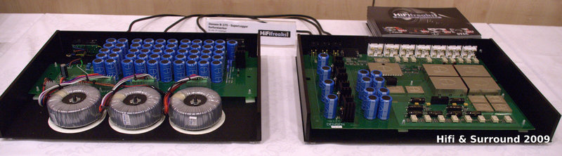

You are right about the ESR, I think I looked at the other FT datasheet, but still Ripple is very superior on the Rifa´s.
The body shape of the caps, is a result of cooling amongst other matters.
The Rifas are also made for heatsink mounting, hence the larger can diameter, which provides a larger area for heat transfer through the buttom end. Also the winding is pressed hard onto the buttom of the can, which also electrically connects the negative pole to the can.
But I do not think the lower can for the FT will cause any trouble @ higher frequencies. Actually amongst other details, the lower can should theoretically make it more suitable to HF measures.
But a lot of things influences on this kind of stuff, terminal design, number of contact points between winding and terminal, separator, electrolyte electrodes and so on and on.
Be aware that the data provided by the manufacturer always is data for the electrolytic cap, an nothing else. You will probably never be able to implement the caps to theese standards, because PCB tracks, even short cables and this kind of stuff, will ruin the data.
When critical engineers have to optimise these parameters in their design, then the cap contributes with precisely what is stated.
