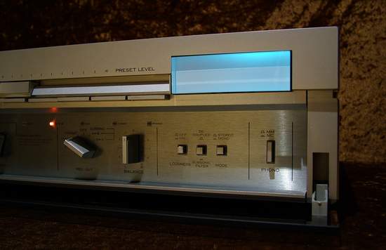

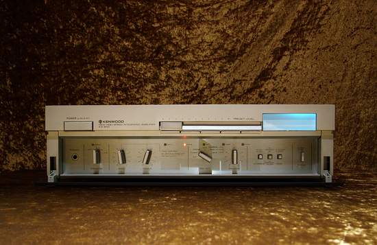

I would agree that "industrial grade" caps are often as good as the audiophile components. One exception I would make is the use of magnetic (steel) leads in industrial caps, and some audiophile manufacturers (ELNA and Nichicon) claim that steel leads can produce audible and measurable distortion. This is not surprising since the high magnetic permeability of steel means that the skin depth is only a tiny fraction of that of copper so that at higher frequencies, even at 10s of KHz, most current should only be conduted by the tin on the leads.
There is a great similarity to Kenwood's claim regarded the "KA-1000" integr. amp. Less metal and more plastic components by their enclosures was justified cause no magnetic permeability by plastic.
Unfortunately, I could still not comprehend, where these so-called magnetic distortions were to identify from in most cases exist bound of other imperfections. So I don't know about audible magnitude of this kind of distortion.
Whether the distortion differences in the same magnitude than the differences between e. g. air coils and coil with ferrite core (which creates clearly audible distortions in good hifi chains), I do serious doubt.

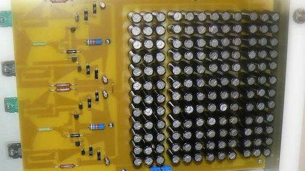

This PCB is like a Porsche with bicycle tires. Very high PCB inductance and moderate resistance isolates the capacitors from the output stage.
You may be able to see the capacitor banks and feel that they are "fast", but believe me, the output transistors can't see the capacitors at all, electrically speaking.

You can make the cap bank much faster by using 2 planes for plus and minus - this creates a low inductance bus connection to the caps, see Rifa's "Electrolytic Capacitors Application Guide" page 5 http://www.evoxrifa.com/electrolytic_cat/electrolytic_appguide.pdf
