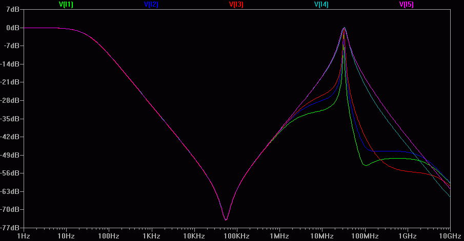

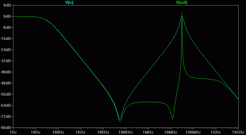

I had small RF coils in mind. The two LTspice plots below illustrate this. The teal trace shows the filter formed by 50 ohms in series with a 100 uF ASC poly/oil motor start cap. The cap model was derived from measurements of self-resonant frequency and terminal-to-case capacitance. The downward slope to ~60 kHz is self-explanatory. The cap's internal inductance then takes over. (I don't recall such a low self-resonant frequency but can't find the original measurements.) The capacitance between one of the isolated terminals and the metal body was measured at ~300 pF, the ~30 MHz resonance is caused by the interaction between that parasitic capacitance and the cap's self-inductance.
The green trace shows what happens when a Wruth 100 uH inductor, selected for a value greater than the ASC's self-inductance but otherwise at random from the LTspice library, is inserted after the 50 ohm resistor.
I know it sounds counterintuitive. There is only one way to find out and that is by measuring different coils or determining their resonance frequency - and btw., resonances at a few hundred KHz would be pretty good for PS filtering IMHO.
