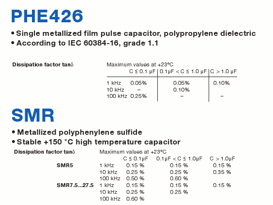

Evox's data sheets appear to indicate a dissipation factor two to three times that of polypropylene for the SMR series. They don't publish DA numbers.Try also Evox SMR polyphenylene sulfid caps. ..
According to Wima the DA is 0.05%
Read for yourself here: WIMA
I think the material is the controlling factor of DA, not the manufacturer.
So IMHO if you you choose Wima or Evox, might be of no matter.
Btw. I don´t think heatwill be a problem in normal decoupling in audio applications.

Interesting. Here are the numbers from Evox. Wima doesn't appear to use both dielectrics in the same model and comparing anything with leads to SMD requires caution. It could be Wima's published difference is entirely due to packaging.
You´ll find 5 mm PPS caps here: WIMA
Only Panasonic seems to abandon through hole PPS caps and only do the SMD types.
As I see it, the PPS types seems to be very stable @ all temps up til 130-140 dgr. And also they seems to have very little memory effect (DA).
ESR also seems to be very low and very constant vs. both temp and frequency.
So to me it seems as a very interesting cap at first glanse. But I never conclude anything from data alone. There might still be downsides afterall, but having tried them out, I must give in. I find them very good for audio.
