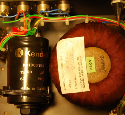

Consider the Kendeil's as well. I've read good things about them. Don't let the fact that they are affordable fool you. It is one of the favourites if not favourite among the Naim "refurbishers" and I've read somewhere that even Naim themselves use them. But that is ofcourse just a rumour.As to the big ones (10.000uf)
Certainly not a rumour. All the Naim pieces i've owned used them. Excellent caps.
