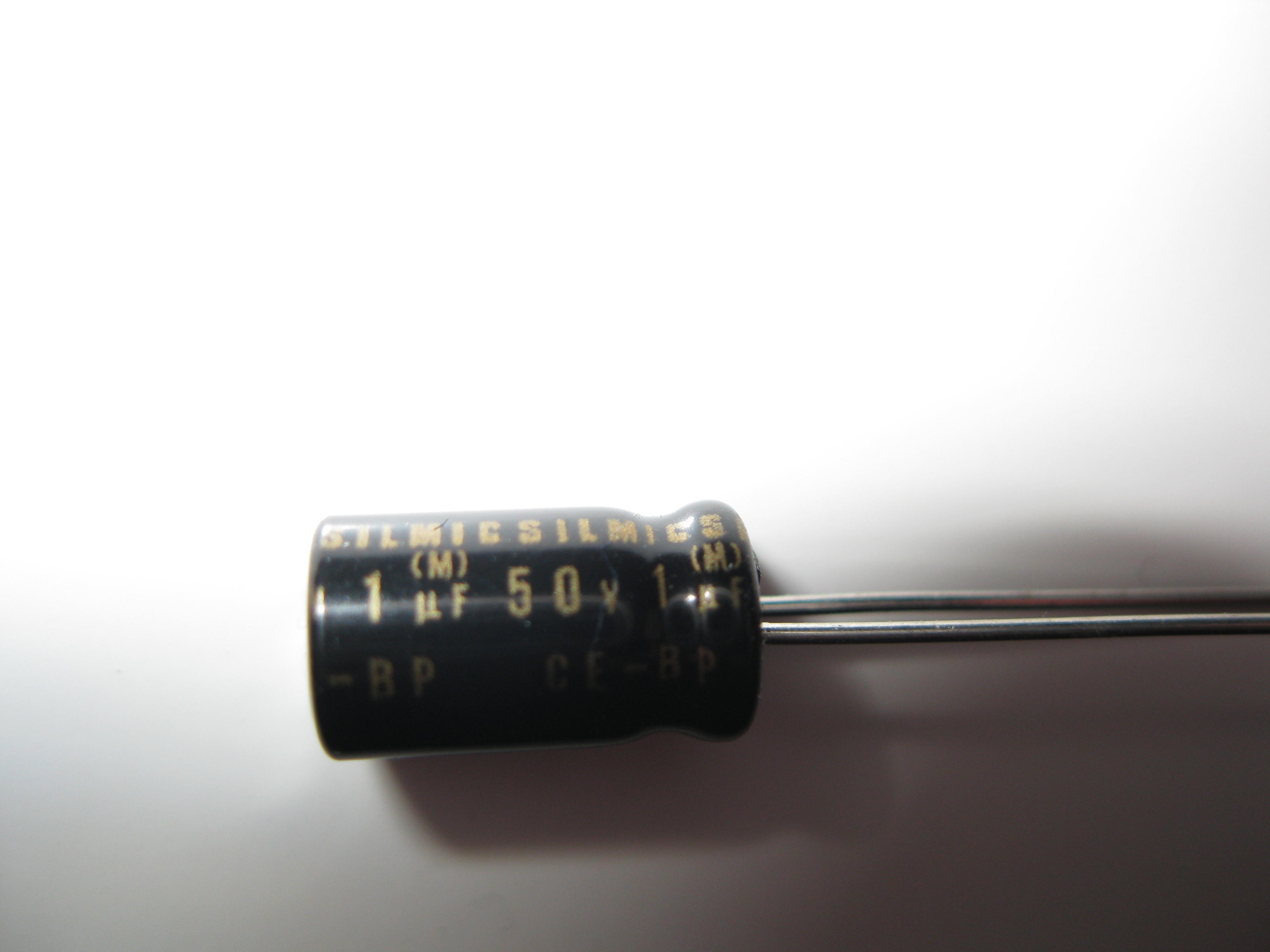

silimics
Here is a shot of the Bipolar Silmics. Made in Thailand.
