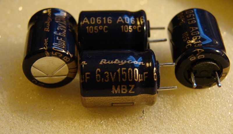

No Rubycons anymore?
Haven't heard about Rubycon caps for a long time here.
Is it loosing market? Out of audio-grade sector?

Rubycon ZLH and Nichicon PA & HE look to be tops as regards ESR. Can't find the PA's here though for some reason.
I hope they haven't crossed the Rubicon to a fiscal downfall or something.
I like the ZL and ZLH for their durability, size and low ESR - they're fine for SMPS/PSU/VRM applications, as well as general digital bypass on PC motherboards, etc. YMMV for audio duty - ZL is good for bypass, but probably too harsh in most signal-path applications. Almost all Rubycons (except Black Gates) have magnetic leads.
Similarly, almost all Nichicons (except some Muse series) have magnetic leads. The Muses (especially KZ) are great for just about any audio application, but physically large. Muse KW and SW are good trade-offs - relatively compact, and reasonably good for audio.
Rubycon got into trouble because they were late in switching from Aluminium to Solid Polymer Electrolytics, which are now the mainstay of the commodity PC and digital equipment business. That business is now dominated by Sanyo, Nippon-Chemicon, Nichicon, and some Chinese and Taiwanese rivals. They also got killed in generic electrolytics by Panasonic, Elna, Nippon-Chemicon, Samxon, Samwha and others. Rubycon now has some polymer lines - but probably too little, too late.
It doesn't help that they also stopped manufacturing their niche high-value lines like Black Gates.
