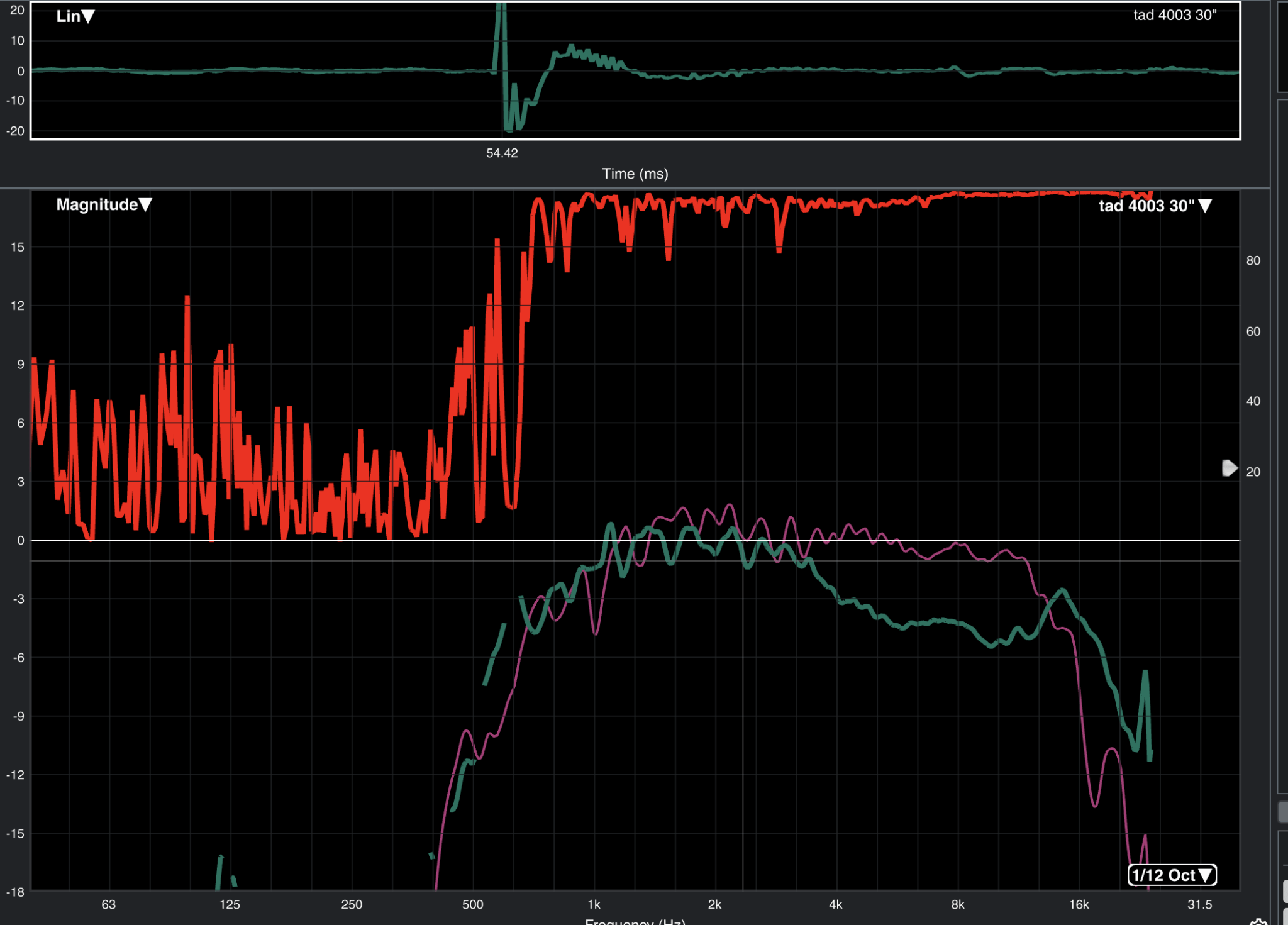

Hi guys,
I did a quick comparison TAD 4001+seos 30 and 4003+TH4003. High pass filter at 600hz no eq. Mic around 1M from the horn.
I was surprise that 4001+ seos does not have flat freq response. Pink: 4003, teal: 4001
Is this normal? After I eq 4001 it does sound similar with 4003.

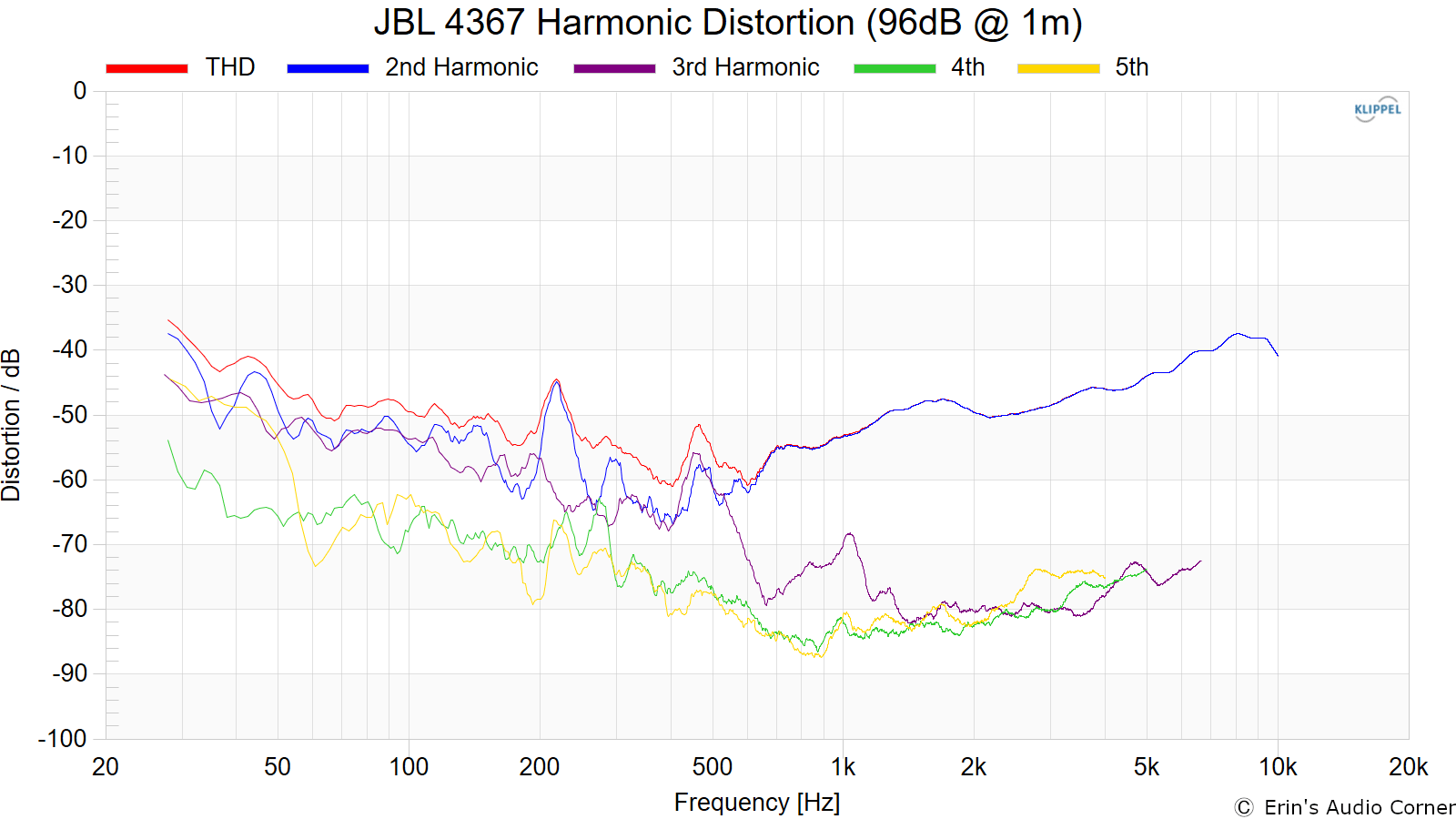

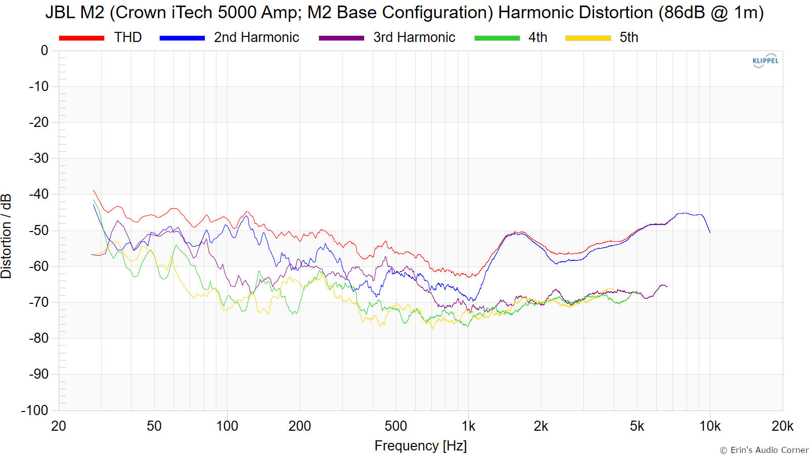

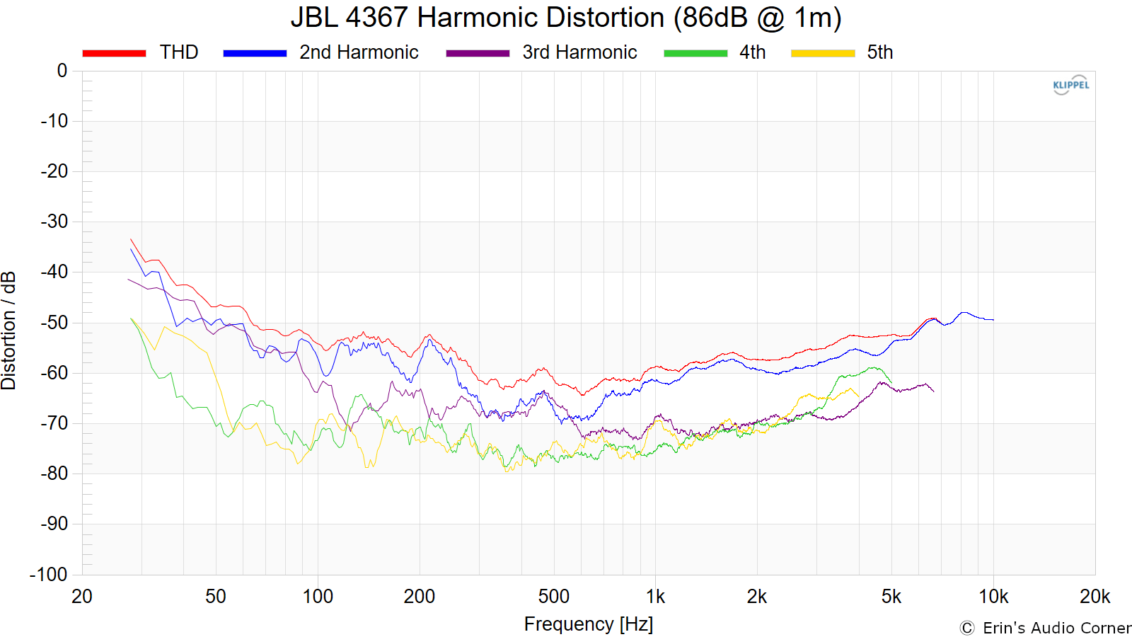

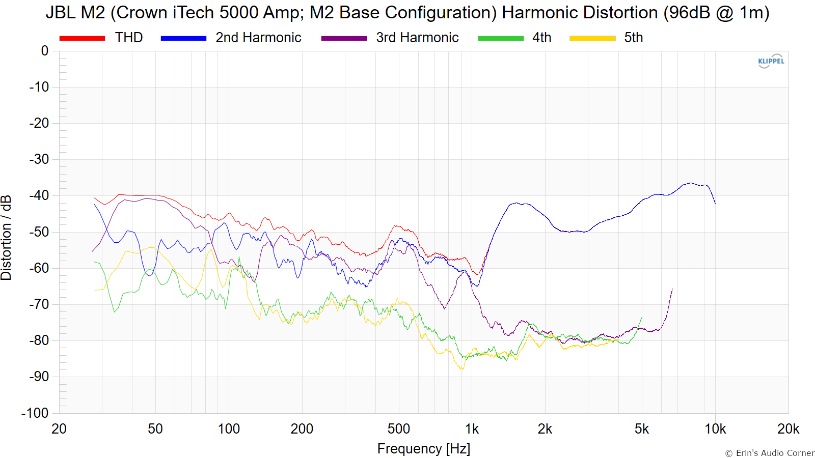

JBL manage to do it with a 2 way with very low distortion, in both the M2 (active crossover) and the 4367 (passive crossover)
4367 (source:https://www.audiosciencereview.com/forum/index.php?threads/jbl-4367-review-by-erin.32689/ )
M2 (Source: https://www.erinsaudiocorner.com/loudspeakers/jbl_m2/)
