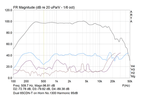

The measurement he provide makes me wonder why the burst decay in his previous measurement on 65CDN-T looks so clean?
Only 8kHz shows in the previous burst decay measurement but this time there's much more.
Is that due to horn matching? Did he do smoothing on his measurement?
The other 2 drivers shows cleaner behavior on the this horn.

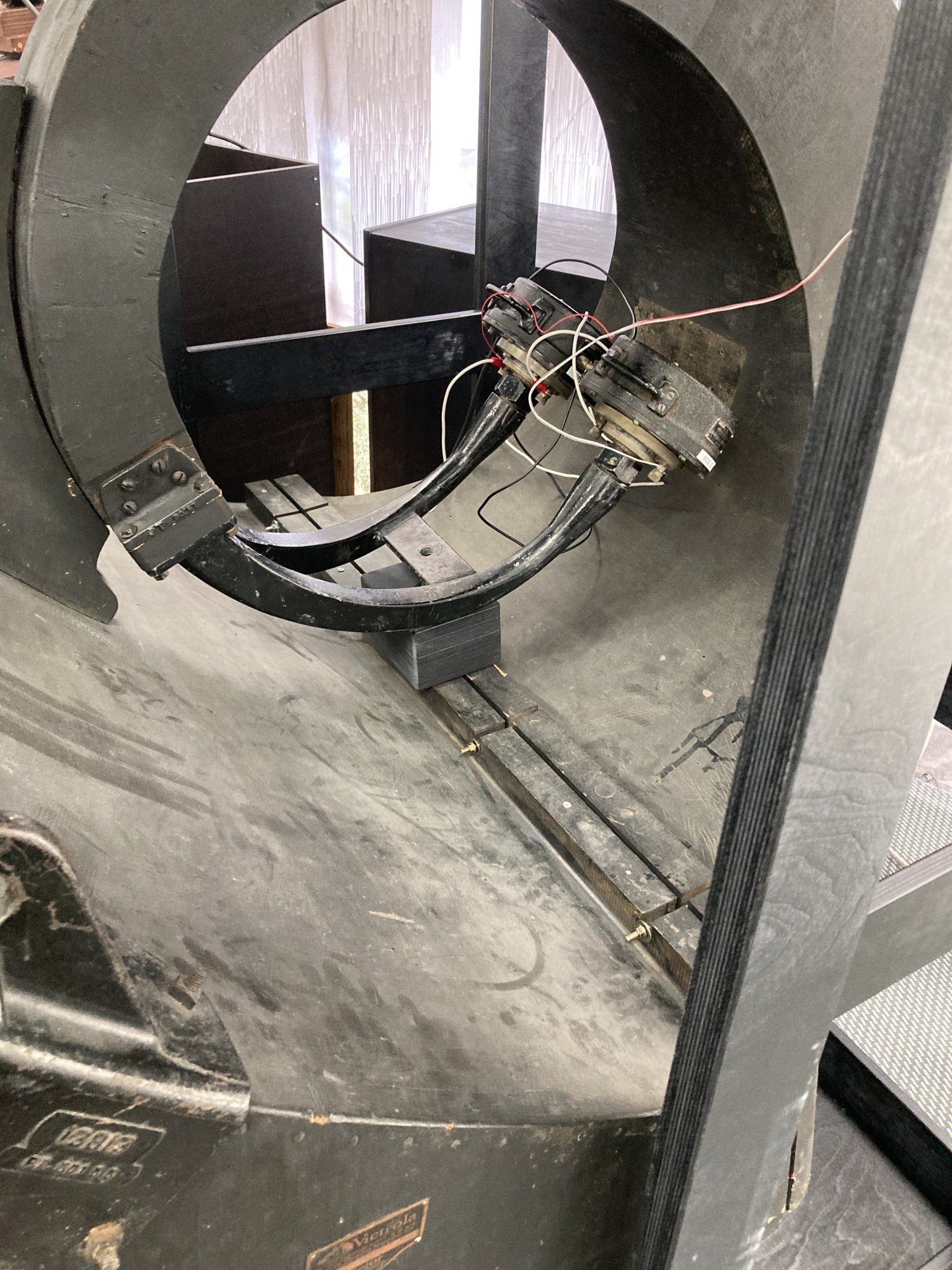

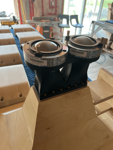

Back to the topic. Maybe the best driver is two drivers? Just saw the new Joseph Сrowe experiments, he got very decent results with Y-Adapter dual 65CDN-T and big horn. Great measurements, no cone breakup, good low end.

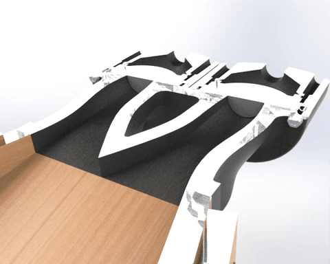

This opens up the prospect of a new look at a Y-adapter, for example, with two good 1'' drivers. Of course, you need to model and print the adapter and make a horn for it (or experiment with available line array adapters and horn selection for them).
View attachment 1178971View attachment 1178978
By the way, he also found that removing the RCF 950 back cover can have some advantages at home volume levels, which confirms my observations as well.
Dual CD: state of the art 1926. 😉 According to Mr. Suzuki of GIP it increases sound ‘density’. Don’t know what it means exactly but shouldn’t this produce the log10(N) or +3dB sound pressure therefore lower ‘apparent’ IMD consistent with JCrowe findings?
Nothing new under the old sun, I know 🙂 But as with horn modeling, there are some new things in 100 years, as computer modeling and 3d printing, as well as measurement tools - perhaps this idea will get new life.
I'm not that smart 🙂 my understanding is more surface area with less break-up effects but at the cost of more complexity of integration without artifacts.
