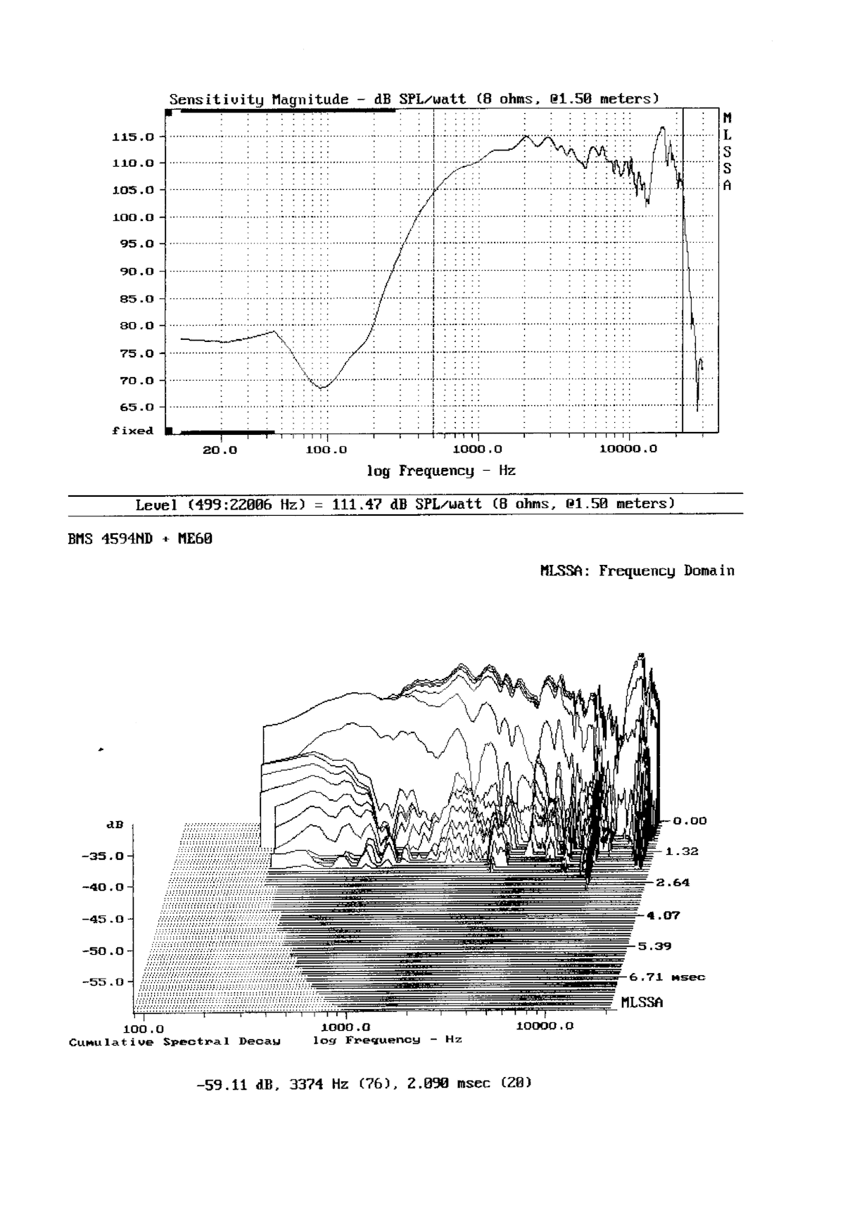

Have a look here - even in the datasheet they didn't hide it. Look at the impedance plot ...Yeah. Think! You cannot spread speculation either, by definition. It's speculation until proven. Conversely, you can disseminate seemingly correct measurements and data that are accurate on the surface but are meaningless since they don't capture the actual issue.
https://bcspeakers.com/en/products/hf-driver/archive/de750

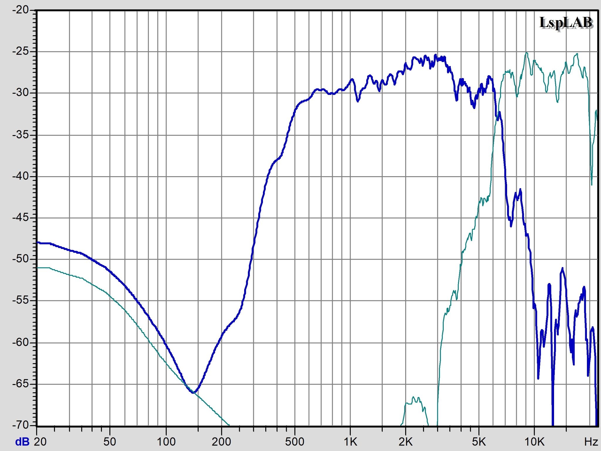

I was owning HK Audio VT Tops at that time and Craaft T12 and N12 (what a beast). And did measurements myself which showed the same result as the datasheet. This was 2005/2006, I used an ancient version of LSP Lab for measurements ... sorry, can't open these any more.
I bet now you show measurements of the TAD drivers. Or the ones from the cool dude ...
Wow - that's a horrible implementation of the BMS. Who is doing that? A 1,4" driver on a to small 2" Horn? Puh ...
Even the stock frequency divider network is better as that.
On the other side you see the resonances of the B&C - and this was the good model, the bigger 750 was worse when I remember right.
Edit - some old measurements I found (2006) which I could convert from emf to jpg but which don't show that much information. 4592ND on Limmer 2" Horn.
There is in no way a hole in the 10kHz area with these drivers if you don't make HUGE mistakes. The crossover is pretty tight, no area to play around, but it works. A lot of K2 THD with the small tweeter driver ... but still sounds better as membrane resonances.

It's the 4592ND instead of the 4594Wow - that's a horrible implementation of the BMS. Who is doing that? A 1,4" driver on a to small 2" Horn? Puh ...
View attachment 1176917 View attachment 1176918

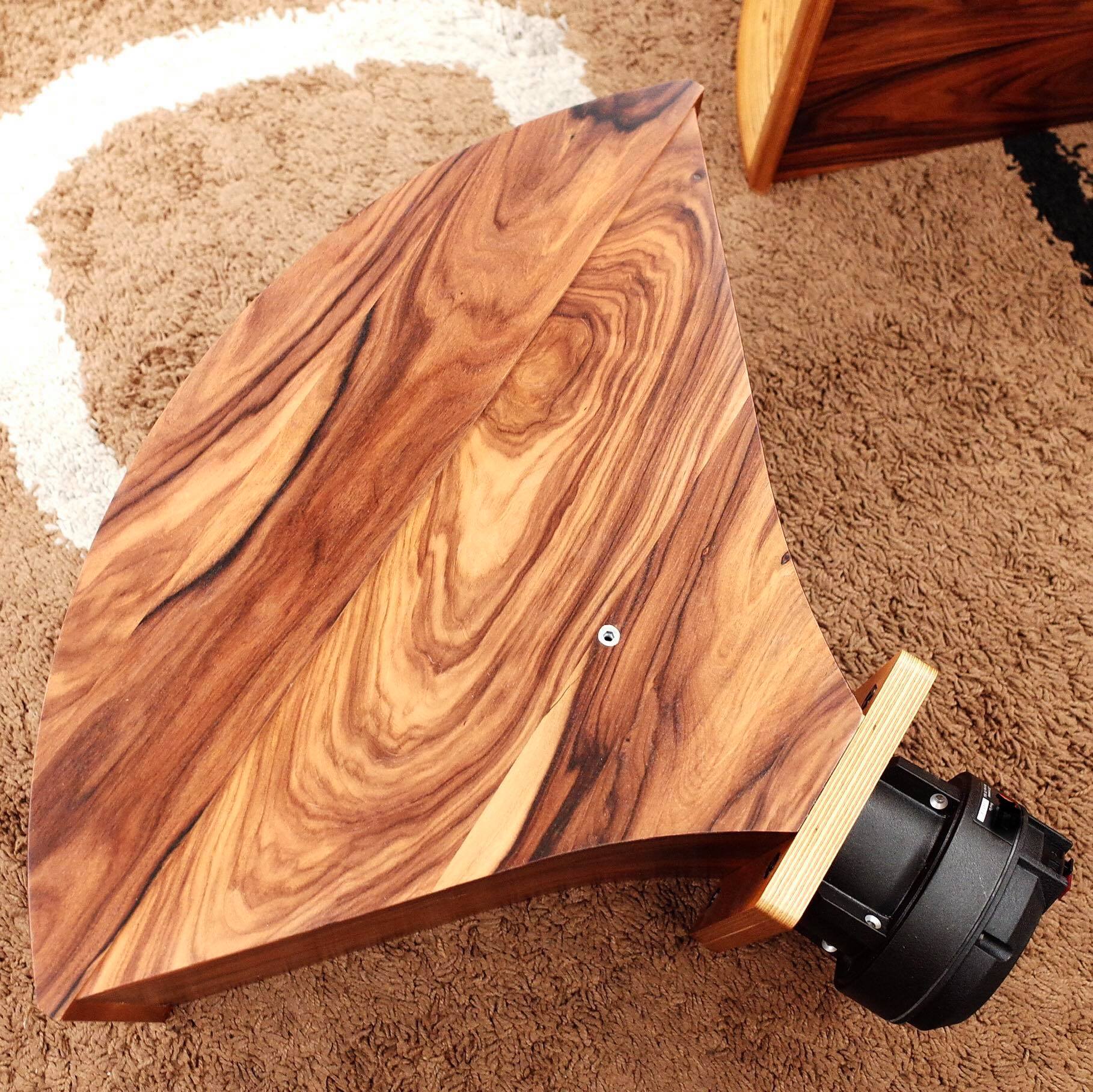

Hi yys310,Hi mark100:
Love your previous sharing on DCX464 with XT1464 horn. The directivity control seems perfect on this combo.
Is the 4594HE your final choice over DCX464?
How do they compare? Thanks!
funny you should ask which is final choice....because that's something I'm currently deeply engaged with, trying to figure out...(still)
I've been alternating the two CDs in my latest experimental build syn11.
The 4594he is the easier of the two to get sounding super on wider array of material.
But on certain material, the dcx464 has a degree of clarity/realistic sound, that I can't quite match with BMS.
On other material, it sounds bright despite measurements that say otherwise...simply dunno why.
I've noticed this difference between the CDs before (on about every horn/syn I've built),
just not as strongly as on the latest syn11 test platform.
So sorry to say, I'm probably not much more help than I've ever been, on this.
I really do wish I had more than one dcx464...
totally screwed up when I didn't buy two. (especially back when they first came out for under $500 !)

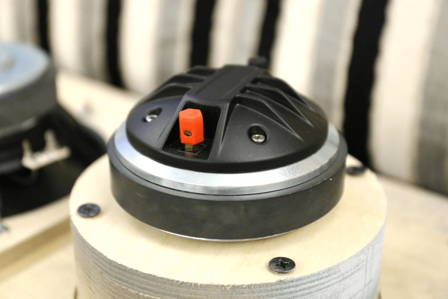

Not in those that I listened to, though.Compression driver used in the smaller Lals systems:
While still a 1" driver, the one used in the Classical 15 system looks more like an old school design:
