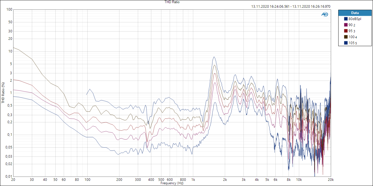

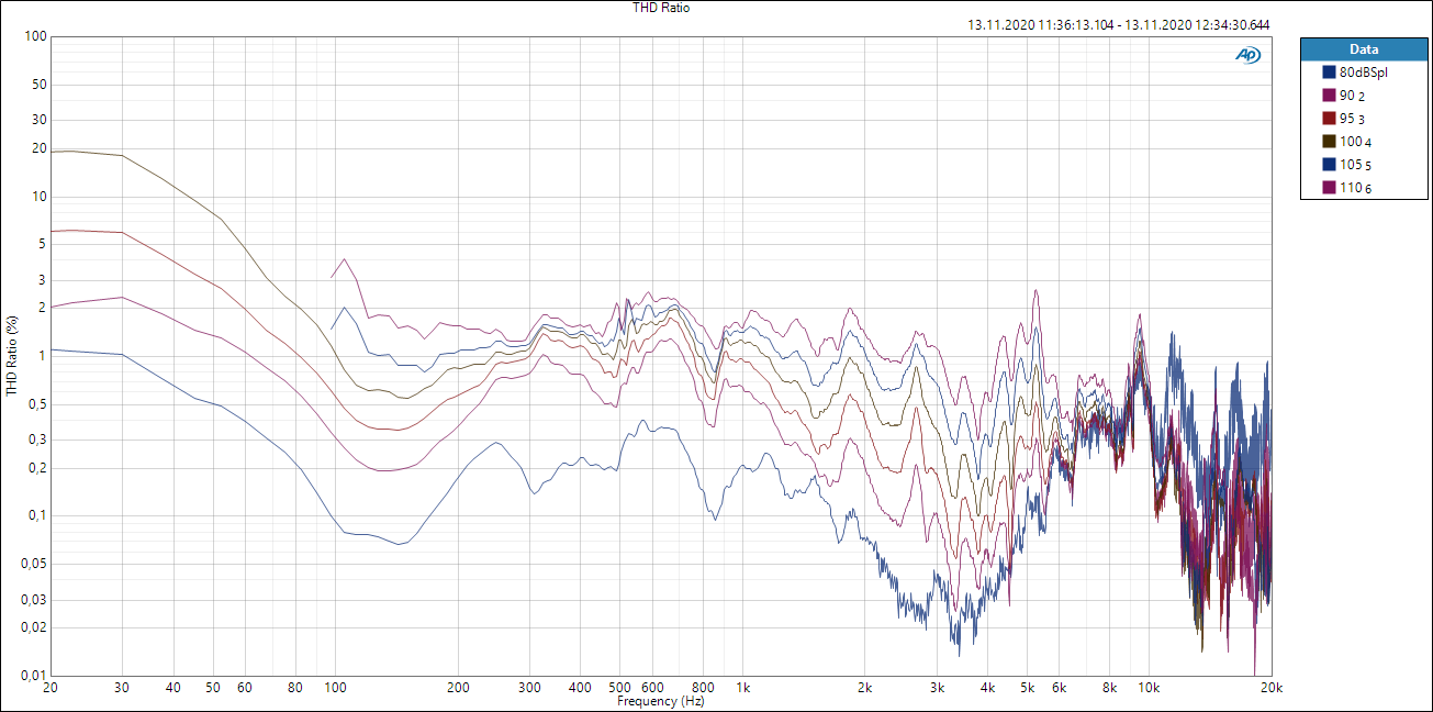

But I just did THD measurements at different levels and classics like 18Sound 8nmb420 are pretty bad at low levels (but fine at high levels).
In comparison your beloved ScanSpeaks 😎
PHL or Kartesian can do low THD and high level at once.
And no - magnetic structures can not be over engineered. Every little improvement is welcome.

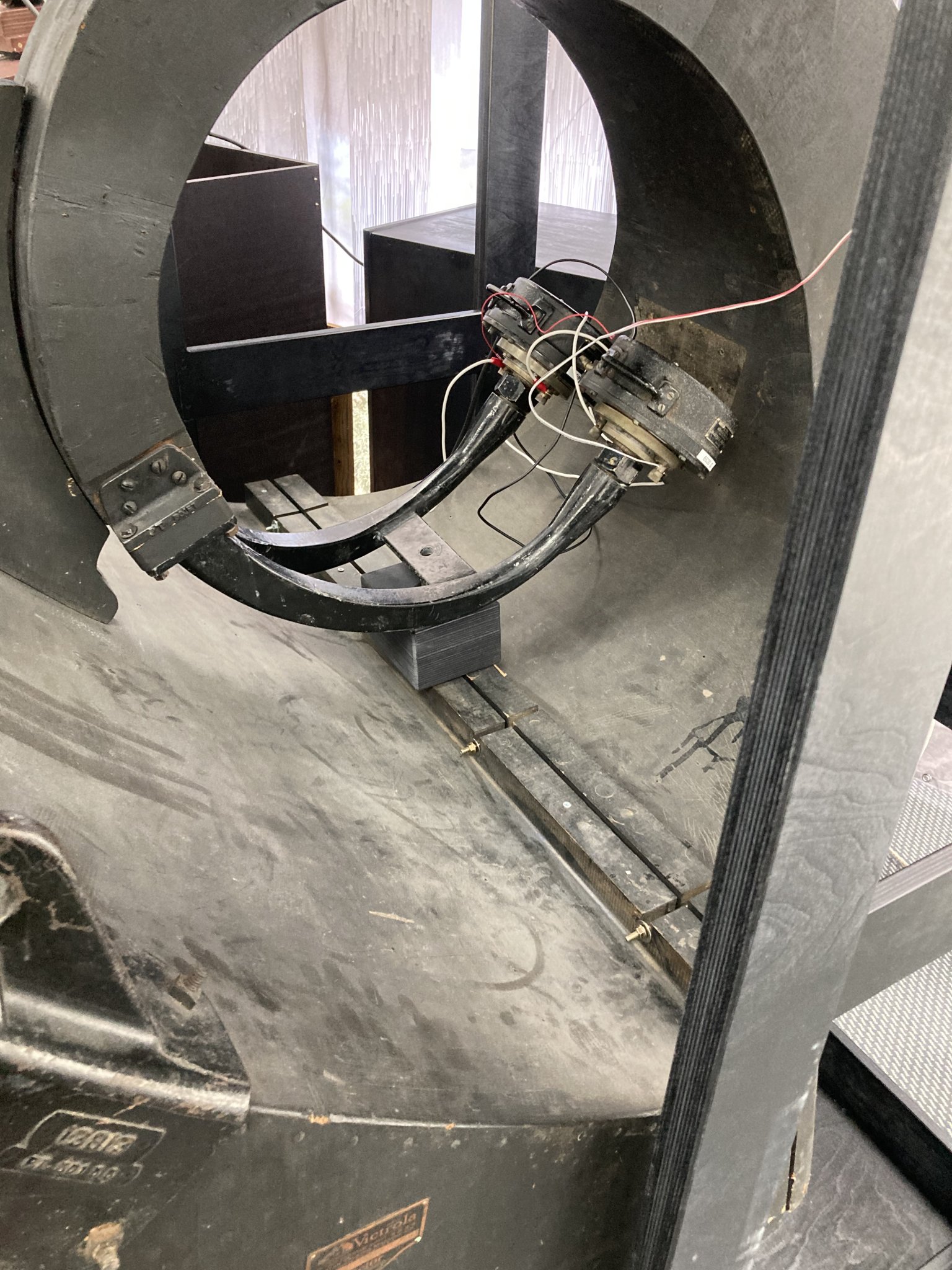

I was talking to a very cool dude, and quite well know in audio circles and he doesn't like the TAD 2001-4001. He seems to think frequencies above 13kHz are fake resonances and not part real musical program.
After spending almost 4hr listening to actual music l am am almost sold on the idea.

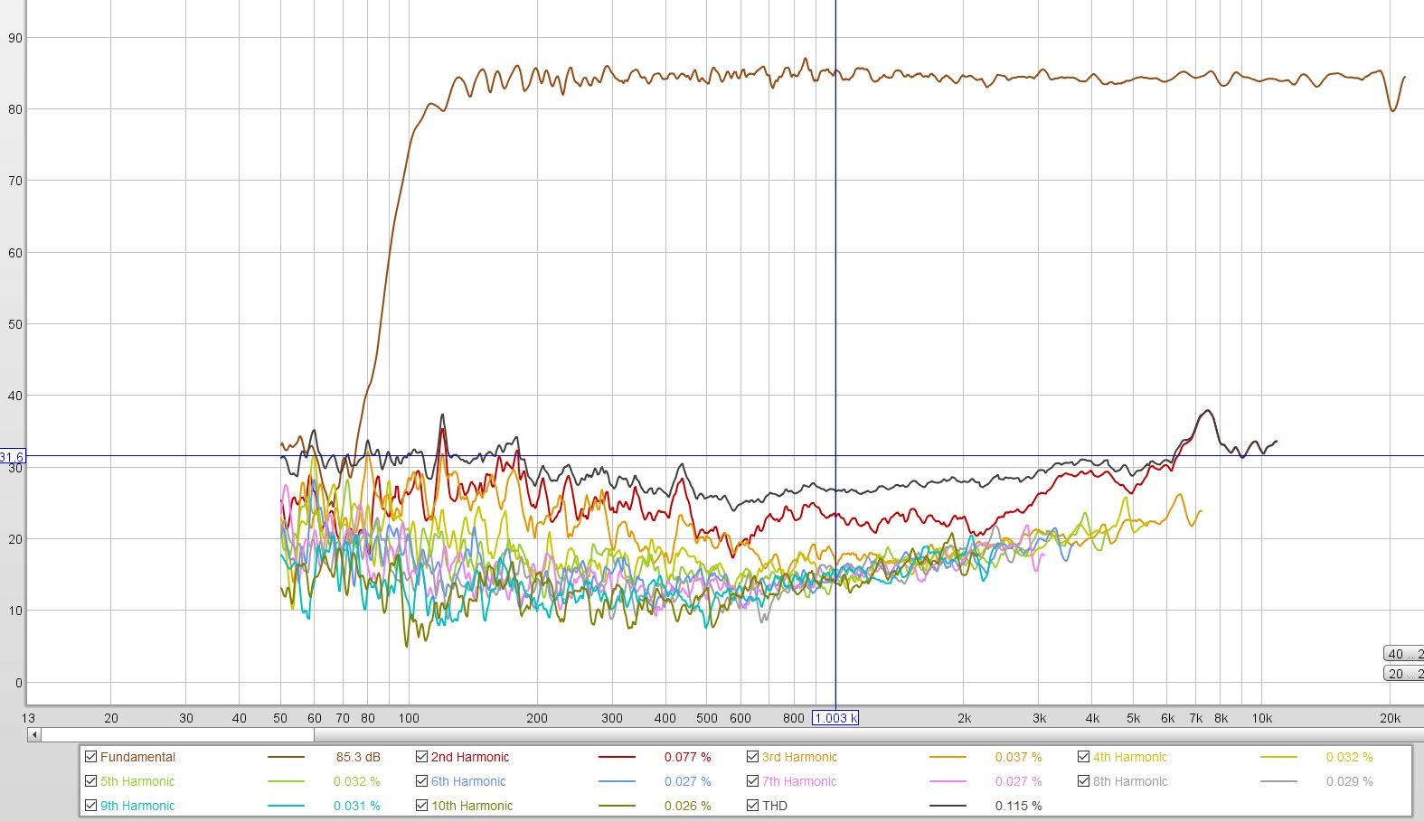

Out of sheer curiosity, what is your take on the harmonic performance of the below ?
It's not a 1" however, it's a BMS 1.4" 4594he on a XT1464 horn. EQ'ed of course.
(Speaker is a PA build using horn loaded 12"s MTM around the CD/horn.....that works super for home audio too, imo)
Crossover to CD is at 650Hz...85 dB is kinda medium SPl, I think..
Looks really clean to me...but maybe not in comparison to best TAD ????
That may be partially true for the 4001, due to the surround resonance. Improved in the 4003. Not an issue with the 2001 or 2002, IMO.

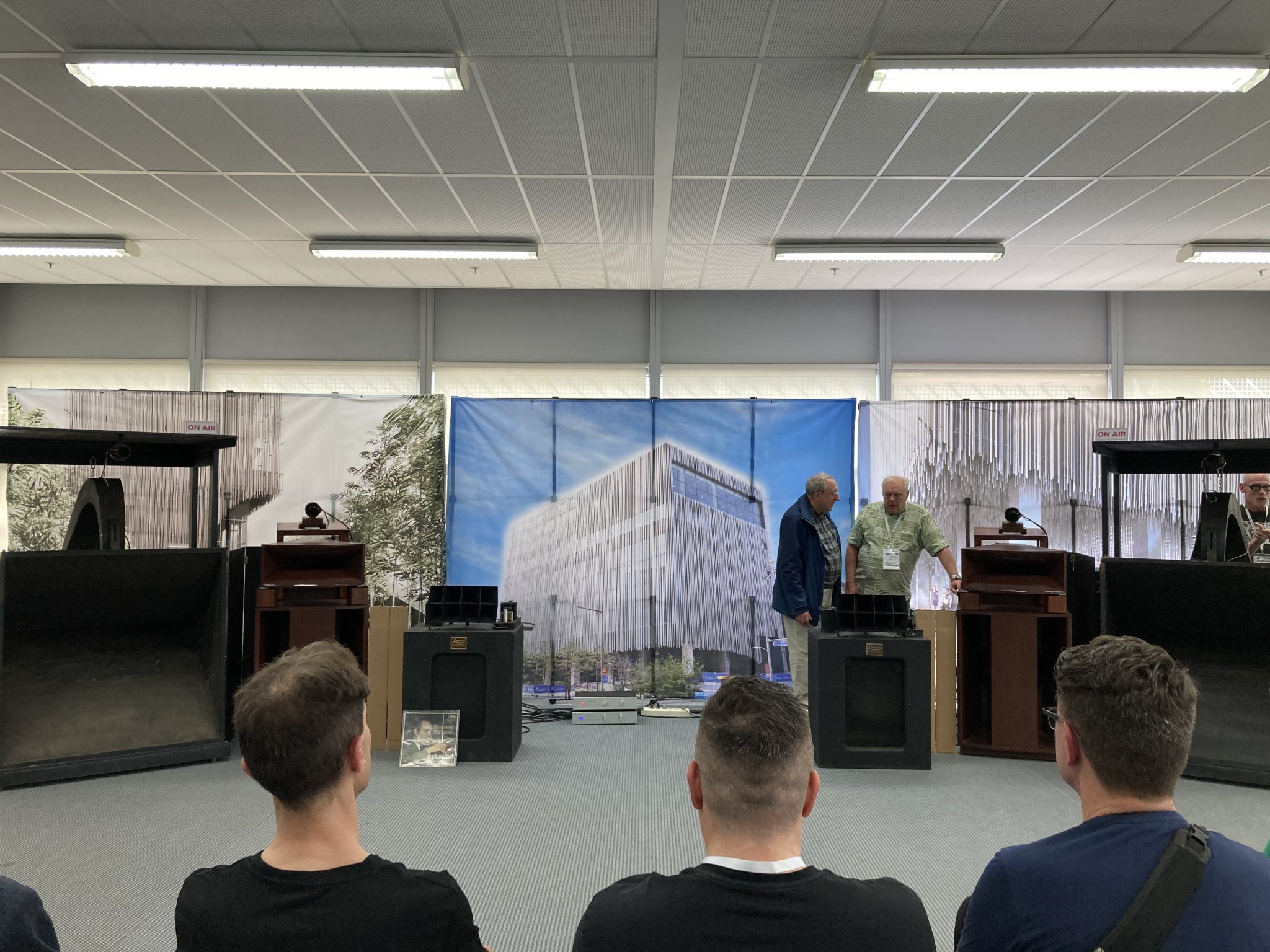

I don't know about 'non competitive' and 'nostalgia'...🤔 the Silbatone room had the best sound in the show, once again. No other room drew applause at the end of each track. You could hear jaws dropping and people were in tears, the vibe was palpable.:worship:
I personally love everything TAD but I have to say the 2001/2 definitely need much better horns than where people put them. I heard 3 speakers that used TAD drivers the results were disappointing.

I was there too (Munich High End 2023), and thought the sound was NOT neutral - coloured and ridden with resonances.
"Vintage" in the non-flattering sense.
I guess we'll just leave it there.

To get a calibration curve: what was you fav room? Did you hear the cessaro , JM (or whatever at the marriott) and the other red one that used TAD drivers? What did you think of them?
Cessaro... not good. Lacking integration.
JMF... I was expecting better.
The other red ones... better, but still room for improvement.
Bottom line, I 100% agree that just using TAD drivers is no guarantee of good results. Many factors at play.
Favourite room... probably the small booth with the Taiwanese LALS speakers (which looked like TAD 2402 knockoffs, but with their own woofers and 1" drivers...)
The Magico room also sounded good, I must admit. As did one of the Wilson Audio rooms.
Then, the Audio Note JP room with the vintage Jensen speakers did something very right on some music (e.g. Art Pepper's "You'd be so nice to come home to")... but then it disappointed on other tracks.
