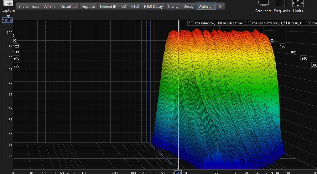

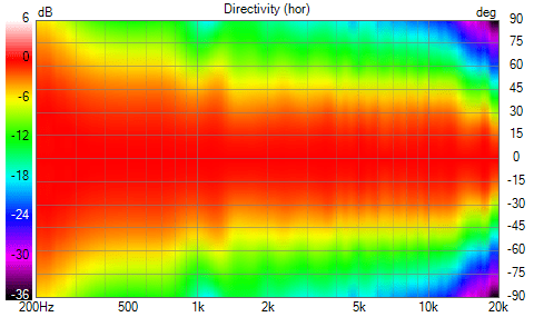

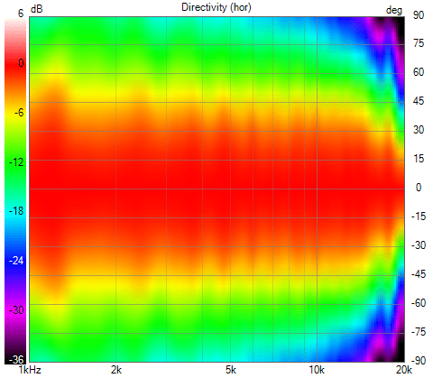

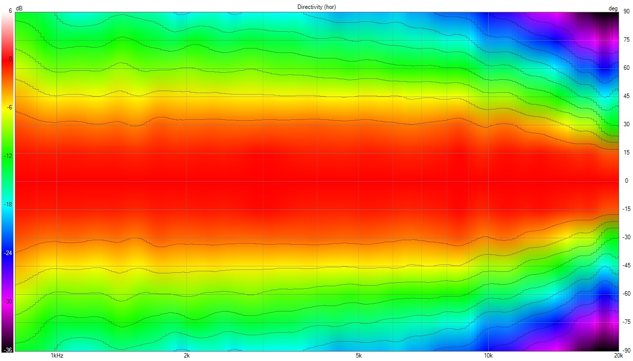

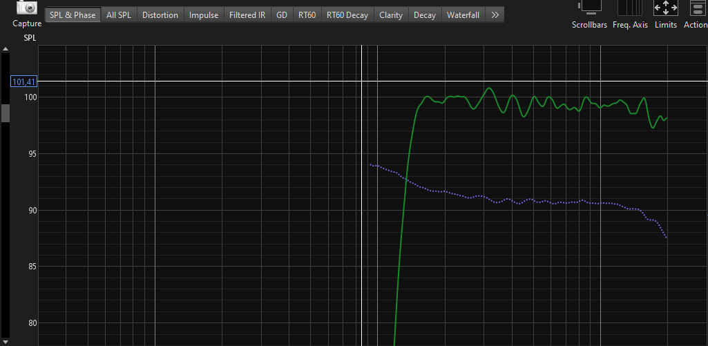

So now let’s go back to my 5530nd and Audiohorn X25 :
To finish the Horn you need to add roundovers to avoid midrange narrowing, otherwise the directivity control will not go as low as possible.
it is easy to check that the raw response is a bell and that break up occurs soooooo late
it is easy to use REW auto EQ at the lowest level of the bell
this is exported to Rephase
Convolution filter is generated, here LR48
Then it is measured, I even tried to make my own polar by making a 1m80 stand with a turntable base.
I am happy to see that I almost get the same as the manufacturer, I only have a problem at 18khz (the polar loses a bit of control) which I am sure is not audible.
I am also trying to use my PHL 1140 in a cardioid with a front waveguide. Then I did the polar of both speakers playing down to 400hz. With the gating at 3.3ms I could not do better.
Now the subjective listening.
It is really precise and clear. Cymbals hits but without distortion. thanks to this 90° CD horn staging and ambiance in my semi treated room is really good. It sounds a little bit like my EQed Hifiman HE1000 Stealth. HF108R was good but it has a little sense of smoothed sound. You have more crisp and sparkle now.
I am very happy to recommend BMS 5530ND and Audiohorn X-Shape Horns.
My personal data are joined and here is the raw data from rew
