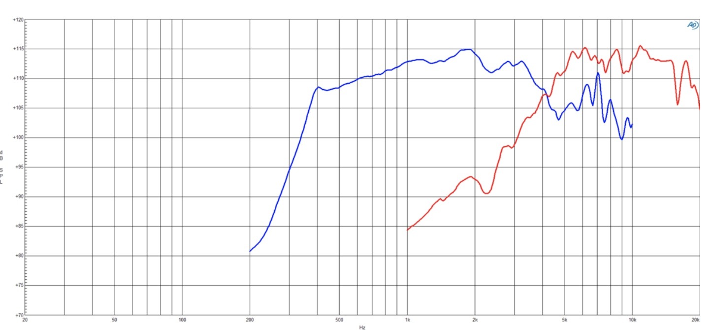

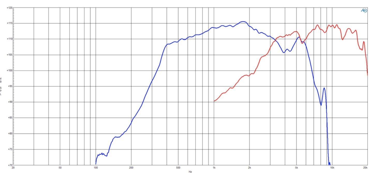

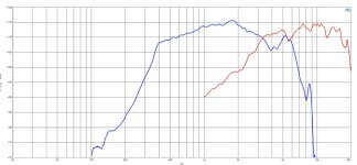

Any consensus regarding the smaller version of the 464 ( 354)...if used for home audio ( not PA use)??
From the measurements it looks as if it would be easier to design a crossover for the DCX354 beause it has more overlap between its two ways than the DCX 464. Bu it has slightly more harmonic distortion if Vance Dickason's measurements are right.
Theoretically the coax drivers should have a slight advantage in terms of IMD over single diaphragm ones covering the same frequency range. Whether they also have an audlible advantage is still open.
Regards
Charles
It should have a BIG advantage over a 3" or 4" membrane in terms of resonances >8kHz!
IMD with a membrane which is "not moving" at these listening levels should not be the big difference?
Regards
Charles
How do you reckon that? Looking at the graphs it's pretty much six of one and half a dozen of the other.
Reactions: Speedysteve7
Looks as if my memory served me wrong. I searched for the Dickason tests as well and also there it looks as if the larger one would be slightly easier to cross over.
https://audioxpress.com/article/tes...h-powered-coaxial-compression-driver-and-horn
https://audioxpress.com/article/tes...igh-power-coaxial-compression-driver-and-horn
But both are quite tricky to cross over. So the question is still open whether it is worth it to use them for a HiFi application. Drivers like a HF1440 should be much easier to get a linear amplitude response from. But there is still a possibility that the B&C coaxes sound better if used properly.
One thing that I don't like that much about the DCX 354 is that the path lenght of the MF driver is about 12 mm longer than the HF path. Vice-versa would have been much more convenient for the crossover design.
