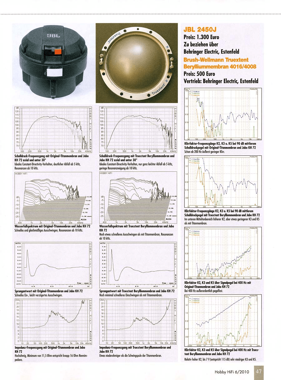

The Materion Be diaphragms will have more of a damped response, and the top octave needs more atttenuation/EQ .
The TI SL diaphragms have a more extended response actually, but they are less clean in the top octave.

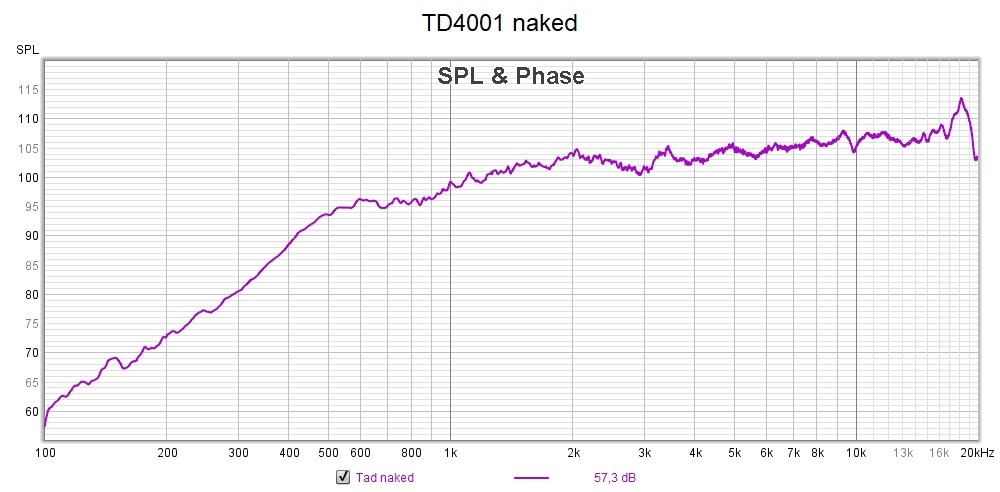

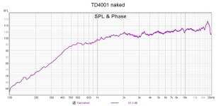

The 4001 has a diaphragm weighing less then half of the Materion, the shorting ring linearises the impedance also. But it's extended response in the top octave is mainly due to the Beryllium diaphragms half roll surround resonance, that gives the 18khz peak in the response. As demonstrated in the old JBL techsheet i added.
SONY SUP T11 are hard to find in a good shape, and replacement diaphragms are nonexistent.

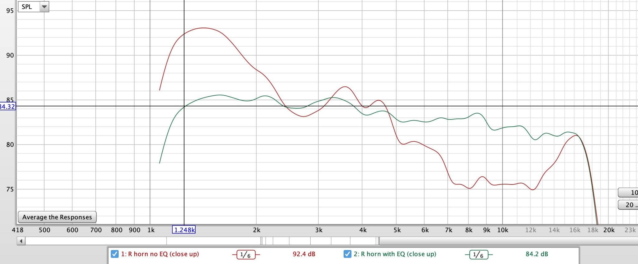

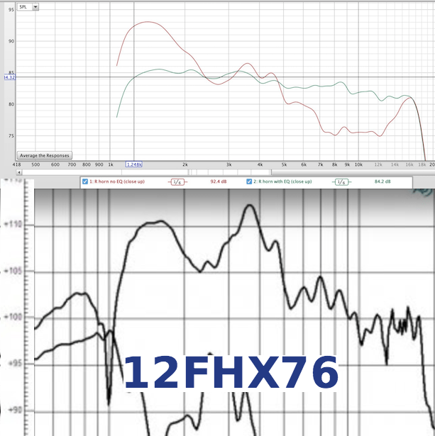

My experience with compression drivers comes from the B&C 12FHX76 coaxials I'm using. They have a 1.4" CD/ Horn, titanium diaphragm. Patterns is 60x40 degrees. Below is the response without DSP and with DSP. I used 9 PEQs to achieve this response. And attached is the REW measurement themselves.
(Un-filtered curve is similar to the published response curve)
I found an old thread where Earl Geddes was discussing compression drivers, and he said that EQ is mandator for a true compression driver. He said the physics of a compression driver dictate that they have a decreasing response, if I remember his words correctly And if it does not have this characteristic, then it is something different from a compression driver.
So in his view, we will never get a "flat" frequency response out of a compression driver? If this is true, how even or "flat" of a response can we realistically hope for (unfiltered)?

I'm at the beginning stage of a new design, and I've been trying to understand Compression Drivers a little better, so I can make a somewhat well informed choice. Below is the response without DSP and with DSP. I used 9 PEQs to achieve this response. And attached is the REW measurement themselves.
Similar?
Your unfiltered measurement curve deviates at points by more than 8dB from the published response curve, perhaps because it was made too "close up" to the horn.
Your 9 PEQ choices made for that measurement location will not result in the same response at other measurement locations.
A typical compression driver response on a "constant directivity" horn or "waveguide" will increase in it's midrange response and drop off in the high frequency.
On a horn with non-uniform directivity coverage, the on-axis response can be near flat over around a decade of response, depending on the driver/horn pairing.

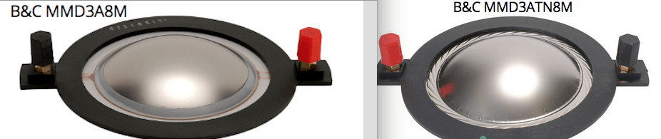

I am curious to know if I can improve the performance of my coaxials, for example. They share the magnet with the woofer, so I can't change the entire CD. But can the diaphragm be swapped with something different?
B&C makes 3" diaphragms with a mylar surround that may be a bit smoother than the all titanium diaphragm. I have not verified if those other diaphragms fit your driver.

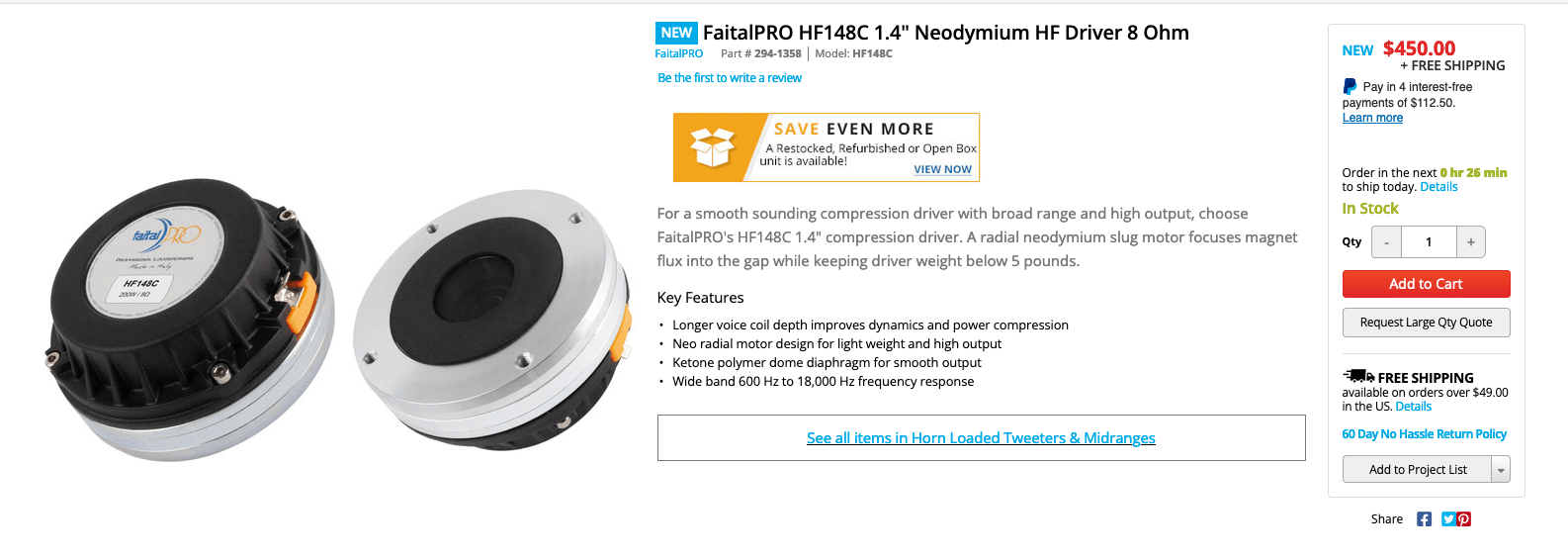

Kevinkr said elsewhere that he is using an FaitalPro HF10AK 1", which claims to use a keytone polymer diaphragm. The published measurements for that one look pretty even. So it seems a pattern is emerging.

Art, thanks for the suggestion on diaphragm with the mylar surround.

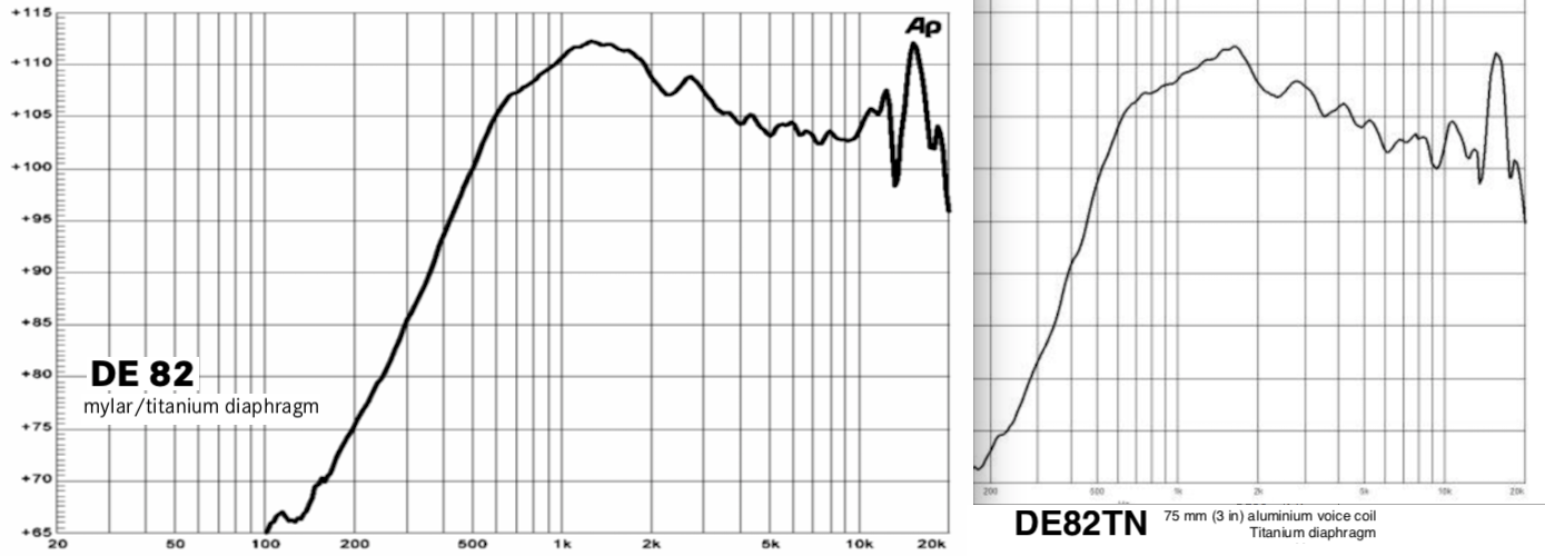

I incorrectly stated that the mylar surround lowered sensitivity on a B&C driver, recalling some other examples from previous generations of drivers from different manufacturers :oops:.

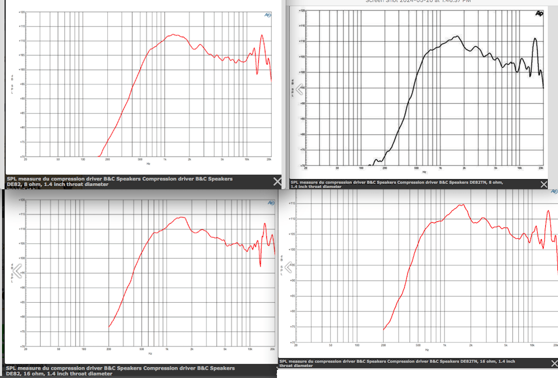

The B&C DE-82 mylar/titanium driver compared to the all titanium DE-82TN:
B&C DE82: DE82TN.png

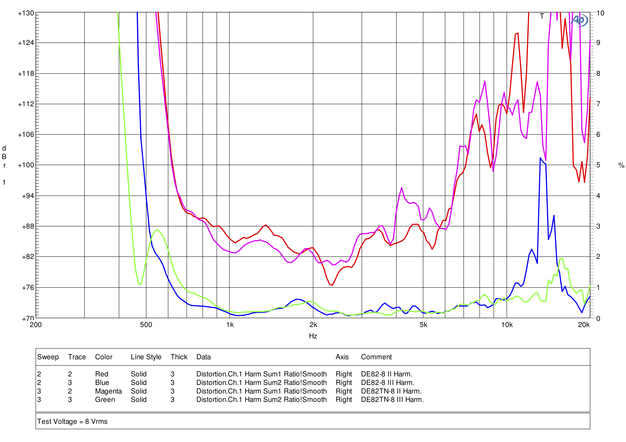

At 8volts, (~8 watts) third harmonic distortion is a bit higher on the low and high end of the DE-82 mylar/titanium driver (blue) compared to the all titanium DE-82TN (green):
DE82: DE82TN-8_DISTORTION .png
And diving further into the weeds, the 16 ohm DE-82 has slightly smoother response than the 8, while the DE-82TN is the opposite:
A 44mm diaphragm, 1" 40x50 horn, highly smoothed published measurement with a -5dB dip ~2.5kHz in the response..
You may find a pattern emerging that 3" dome diaphragms don't use that material ;)
For the HF10AK. It is fairly clean, has a small issue around around 2,5 k,( i guess a cavity resonance?) as shown in the mfg. sheets too, just very smoothed.

Larger diaphragms often use a polymer surround, that (if properly designed), helps dampen resonances.
