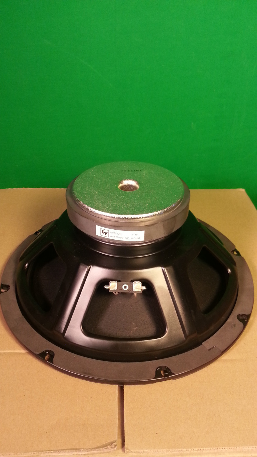

I was also able to find some pictures of the 12" in the EV, see attached below. From what I can tell, the peavey's use a custom version of the eminence delta 10", which appears beefier than the EV driver. Do not discount the plastic cabs of the peavey, which are quite solid and damp once modified.
