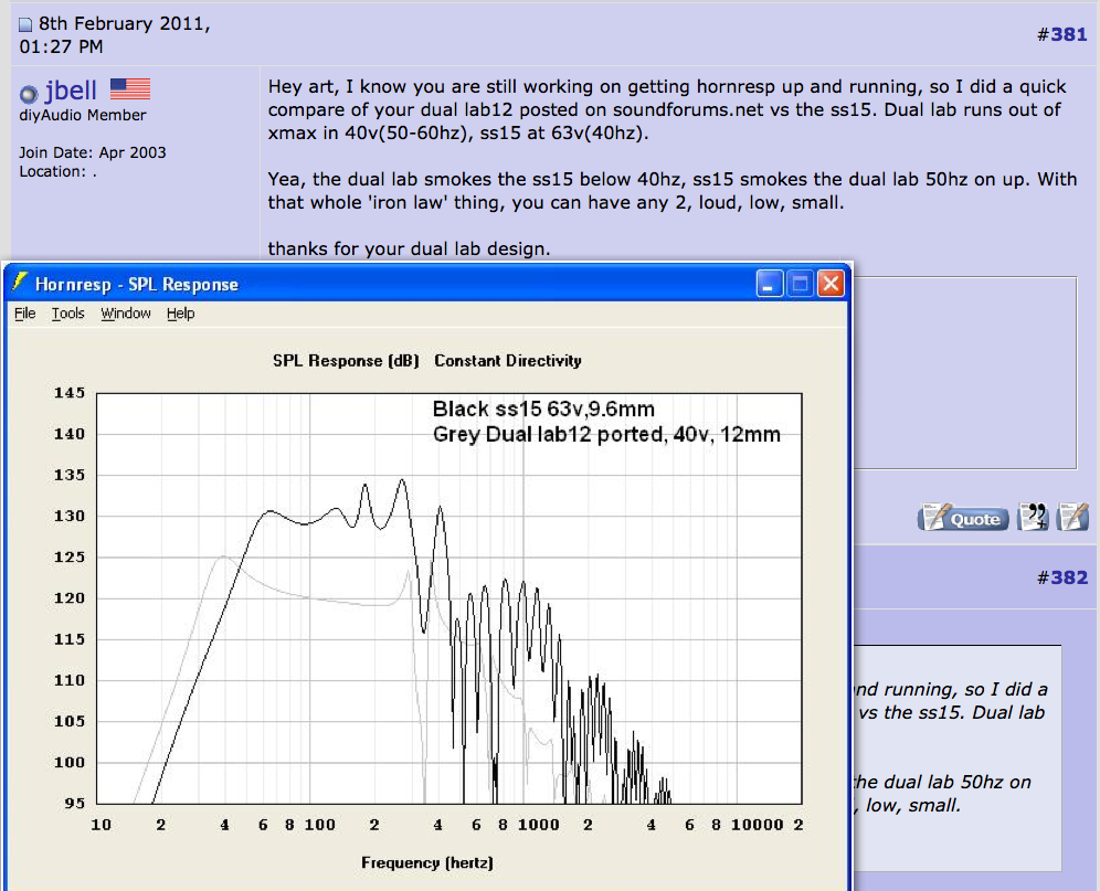

1)First off, the SS15 should have a lot more in the 40-50hz range, shouldn't it?

1) The SS15 rolls off below 60 Hz, 40 Hz is -10 dB. Between thermal compression, cone and cabinet flex, it will not reach the predicted 130 dB level, IIRC it was some 5 dB less at full power.

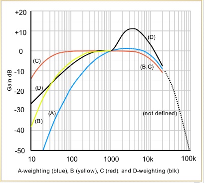

2) A 10 dB drop in level at 1000 Hz "sounds" half as loud. It takes almost 10 dB more level for 40 Hz to sound as loud as 1000 Hz.
Get a real SPL meter, the iPhone mic craps out around 110, and reads higher because the clipping adds level.
A 3 dB increase SPL requires double the power, 6 dB four times, 10 dB X 10.

4) It depends. An increase of only 5 dB at 20 Hz sounds twice as loud, LF extension can make a system sound louder without needing as much SPL.

the brain and our ears is not so good at percieving bass. this chart helps explain that. 120 db at 4khz would likely hurt quite a lot. 120 db at 40 hz is probably just tickling your pants legs.
