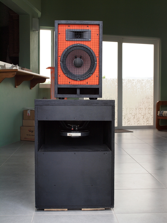

That was my thread, and here is what I ended up with after looking at many, different horn options:
http://www.diyaudio.com/forums/subwoofers/219923-ultra-compact-ported-15-dayton-ref-ho.html
It fits in a midsize car or small suv and is currently chilling in the corner of my living room. It has run very well outside for several hundred people and is plenty for about 100-200 people in a 1000-1500 sq ft room. With extremely good sound quality, and low bass. The subs will surpass any horn or tapped horn of the same size - in output, low extension, high extension, and sound quality.

When do you think you will be ready to share your POC#3 with the world?
At the rate my time is getting chewed up, probably around Xmas 🙂. I've promised to have it ready for my youngest daughter's Halloween Party, but time seems to be running out very fast. I still need to design in the bracing before I start any construction.
We are starting to think, for our particular situation, it might be best to have multiple smaller cabinets. The size you mentioned looks very appealing.
Multiple smaller cabinets = easier to transport. It can work out to be more expensive though, as you need one driver per cabinet.
I found your POC 1 and 2 postings. Do you consider those still good designs, or is your POC 3 going to be vastly superior? Thanks.
POC#1 is a tapped-pipe based on a 6.5" driver. Not good for pro audio use.
POC#2 is a THAM-like TH based on the PA310 driver. It has pretty decent output, but was initially designed without bracing. I've added bracing but external panel flex at start and midway down the path have me wondering if really this is the best type of fold to use for a pro audio TH.
POC#3 should include enough bracing to deal with panel flex issues. It's also going to have a higher Fb to be a better match for the PA310's output capability. On paper it should be better.
I've included an image of POC#2 below with some DIY tops I put together late last year using the Eminence Beta 8A driver and piezo tweeters - that should give you a good idea of its size.
