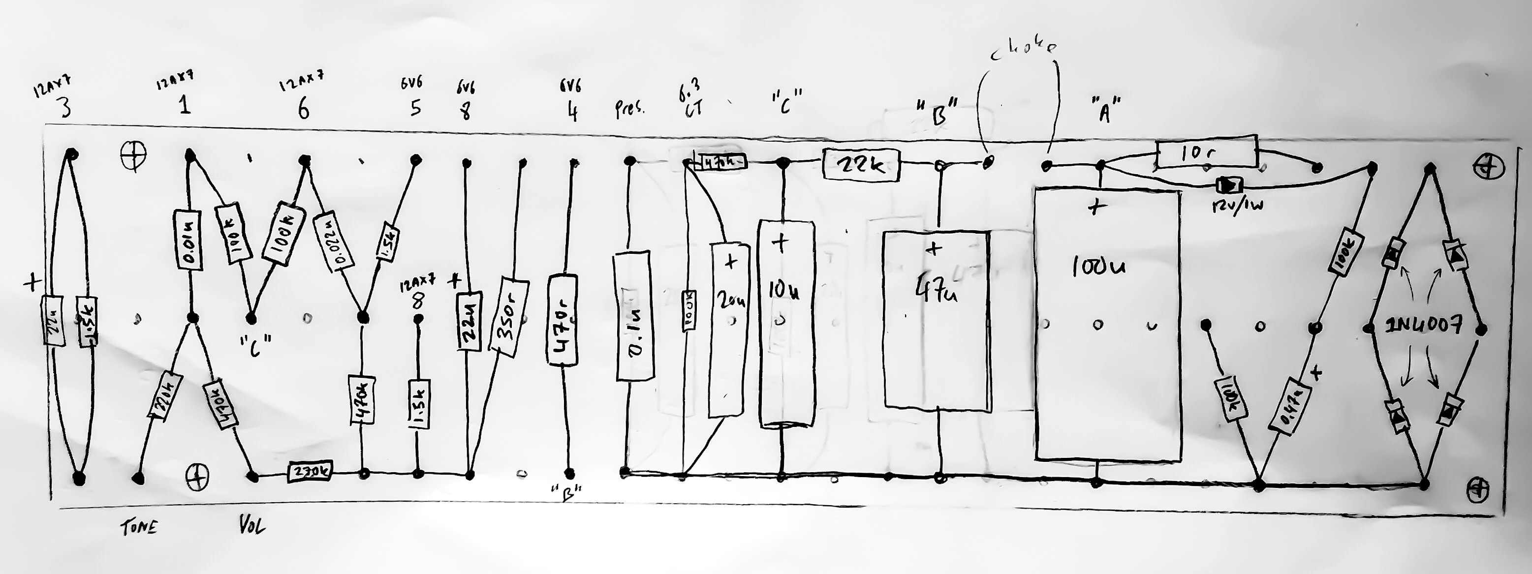

Right, work has been MAHEM, so my layout remains an atrocious scribble and not fit for public consumption. *But* I think I have my head around how it will be built... sooooooo without further ado: PARTS ARE ORDERED!!!
No problem on the still unfinished schematic. You say you wanted a looser type of build this time, more experimenting, as your previous Lightning was a " by the numbers" build as you say. Experiment with different values of resistors and caps, both cathode bypass and coupling cap values and see what sounds good. It's fun to learn as you go with substituting values and hear the immediate results from a change you made. It's a nice change from running endless sims. Change power supply dropping resistors for different B+ voltages, change bias points, etc. Lots of possibilities as you can take parts of different versions and put them together for a "new" version. Maybe the "Lightreel Princeton" will be born.
About to solder and I'm concerned about the 6V6 bias grounding point - is it best to have it on the preamp or power amp "side"?
I'm guessing I have it wrong and it should be on the power side... or maybe even it's own ground point???

Some progress (pic attached)
Chassis is done and all hardware is mounted. I still haven't soldered as I plan on going over my layout one last time! I moved the 6V6 bias ground to the power side, but it's easily changed if it's not happy like that. Presence cap was moved to input ground side.

HELP!!!
It's not working. Just blowing fuses straight away :-(
Anyone any ideas? I've checked everything I can think of.
The only weird thing is that the 6.3 CT wire (green/yellow) is coming off the primary side of the PT. Maybe I should crack it open to see what's going on???

Unhook stuff and go from there. Start at the trafo, measure voltages. If that's pjs then check your SC output. Hook up the gain stage.... Etc so forth. You'll be bound to see where its coming from.
Thanks jlangholz. I'll get on that. In the mean time I popped the covers of the PT... that green/yellow is definitely going to the primary side. Which makes no sense to me. Spec sheet definitely says it should be the 6.3CT (http://www.hammondmfg.com/pdf/EDB372BX.pdf).
I'll cut the connection to it and see what happens. Amp should work without a 6.3 CT? Just be quite hum-y... right???
Wow my mobile atuocorrect murdered that. check you DC outputs out of the trafo and go from there. If you're not sure about the CT you could always do a virtual CT with a couple resistors. This would work both if grounded it or elevating the supply with it.
If everything out of the DC stage is okay, like i (tried) to say, start hooking different stages up and you'll find where the short/miss wire is pretty quickly. Hook the heaters up to the tubes first maybe, check those. Make sure your rail voltages are kosher...etc.
With nothing connected the PT seems stable and the voltage is reading approx 650 and 6.4 which is what I expected.
I disconnected the suspect CT and made a virtual CT, the heaters work fine when connected, with B+ disconnected.
I bypassed the VVR.
But with the circuit connected it still doesn't seem happy: the PT gets very hot REALLY fast, and I can smell it... so I haven't dared run it for long.
I bypassed the VVR.
You should really be using a variac and dim bulb tester for first starts, that aside it sounds like you have a dead short on the high voltage side if the heaters work in isolation. You need to go back over all your wiring and look for the mistake, or post some pics incase we can spot something.
