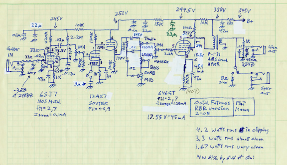

This circuit has the magic. Great sound clean or over driven. It got to where I had too many amps so I sold this one. The guy who bought it emailed me later and said, "If you want it back you'll have to pry it out of my cold dead hand"...
The zener in the Line Out circuit shorted and needed to be cut out. It was intended to protect external devices from overload. If you can't get the 6SJ7 pentodes (out of production but many surplus here in the U.S.) you could substitute a JJ EF806S (their version of an EF86), but may need to readjust the bias and plate load R for best results. If you replace the 6SJ7 with a 12AX7 circuit, you'll have less gain, but may still have enough. The output transformer was nothing special. It was the cheapest simplest single ended output xformer they had at Antique Electronics in Arizona, where I bought most of the parts. I forget what the primary impedance was, but whatever is appropriate for a 6V6. The 180 ohm R and 47uF cap set the "sag", which I never paid much attention to, but seemed to work well. Up stream from that I had two stages of RC filtering with larger caps. A single ended circuit has poor power supply rejection, so it's wise to have good filtering in the power supply before the "sag" RC.

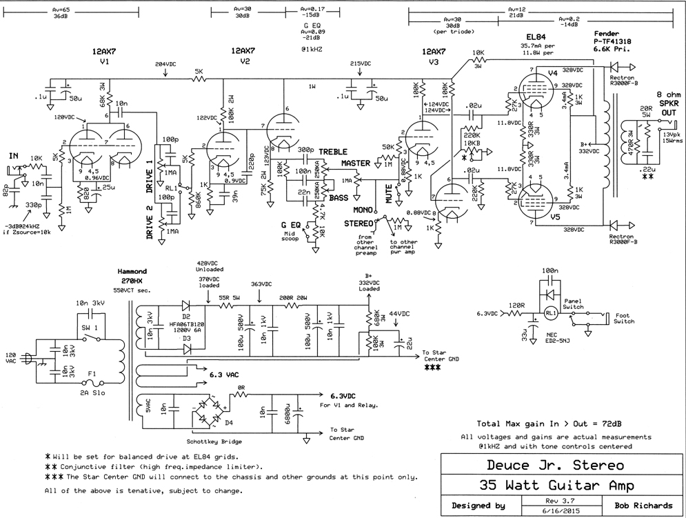

Here's an amp I built recently. You can see how I did the power supply.

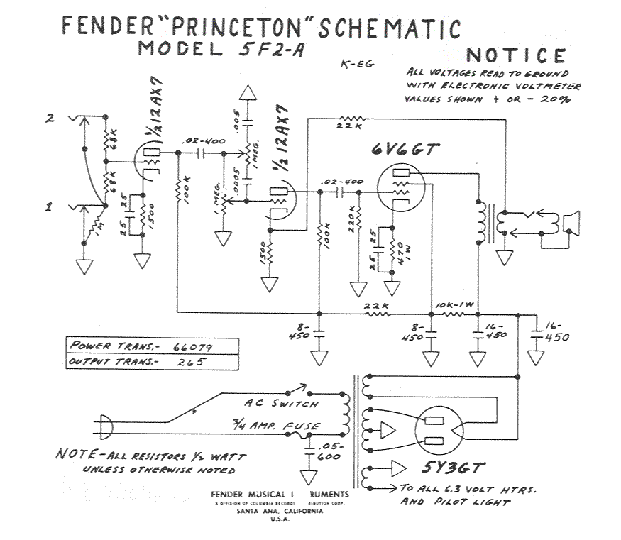

Sorry, should have given a reference to the two schematics.
View attachment Fender_champ_5e1_schem.pdf
View attachment Fender_champ_5f1_schem.pdf
That was exactly what i meant, thanks boobtube.
Just to add more confusion into the mix, i built mine as per the Princeton 5F2-A with the tone control between the two 12ax7 gain stages, and a cathode bypass capacitor on the 1st gain stage like the 5E1. There is at last half a dozen different variations of the Champ/Princeton so deciding which to build was the biggest challenge 🙂
The 5F1 makes sure the screen is at a lower voltage than the plate, which is considered the proper way to do it. The 5E1 does it the way many amps in the 40's and early 50's did it, which puts the screen grid at a slightly higher voltage than the plate (due to the drop in the OT primary winding). I don't know if this way has a better distortion sound when over driven, but I will say that there's a much better chance that the screen grid will glow red from dissipating more power than it's designed for. I would expect the 5E1 to burn out its 6V6 significantly sooner due to this. A screen grid has a max power dissipation spec., and it's usually approximately 5% of what the plate is running.
If someone gave me a 5E1, I would put a 470 ohm 2W resistor in series with the screen grid. This R would drop voltage as soon as current flowed, thereby reducing the voltage on the screen grid, and keeping the power dissipation from being too high.
The 5F2A circuit looks very good and reliable. One thing I'd change though is the heater circuit. Instead of grounding one side, I would put a voltage divider across the first filter cap, creating a +30 to +50 VDC tap, and tie that to one side of the filament winding. I'd also put a 10uF cap off that tap to gnd. For divider resistors, I'd use approximately 680K 2W and 75K 2W, or whatever gets you anywhere near +30VDC. This causes the cathodes of the tubes to be a minus voltage compared to the heaters, so less hum.
Also, the 22Kohm feedback R cleans up the sound a bit, but if you want more "color" or a different and possibly better distortion sound, you might try increasing that value to 100K or even higher. Gain will go up, and the speaker resonance will be less tamed. It's something to try. You might like it.

Sort of back on track with this one... I've updated the schematic:
- decided on the transformers
- updated the power supply
- added the coupling cap to the tone stack (0.022uF - can someone comment on this?)
- elevated the heaters
