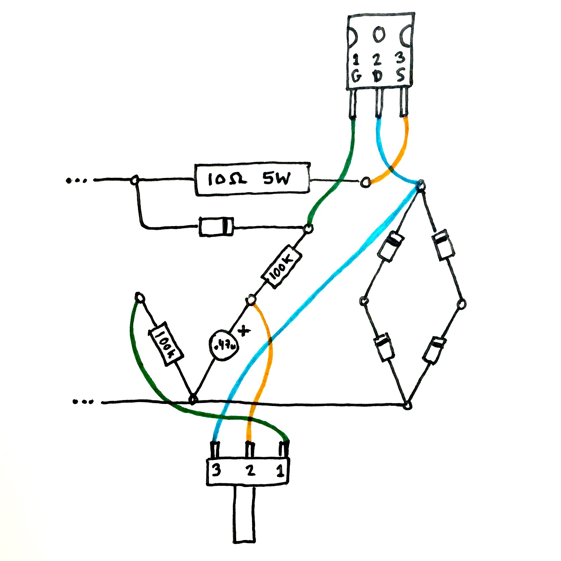

Thats very hard to follow when you dont know what is connected on the bottom side of the board. What is with the diode and and resistor/cap string next to the bridge rectifier?
Blowing fuses blindly isnt the way to go so try measuring the resistance between the + and ground without power and see if you can find any shorts. I would start by disconnecting the blue wire (transformer B+ i assume?) and the choke and measure both to try and isolate the fault. That should give you an idea if its the power supply, driver tube, or power tube where the problem lies.

Thanks mcandmar, that Zener is part of the vvr.

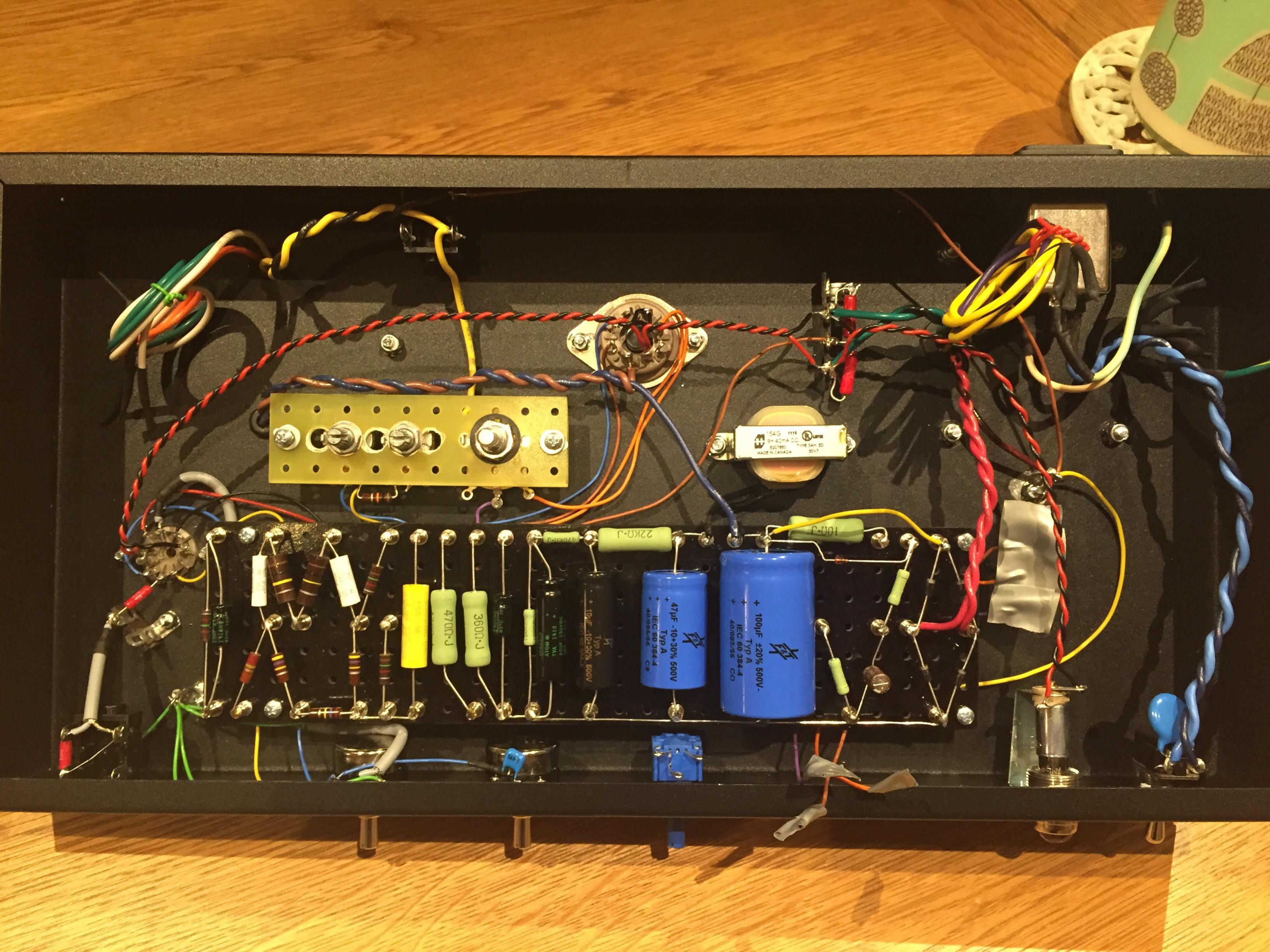

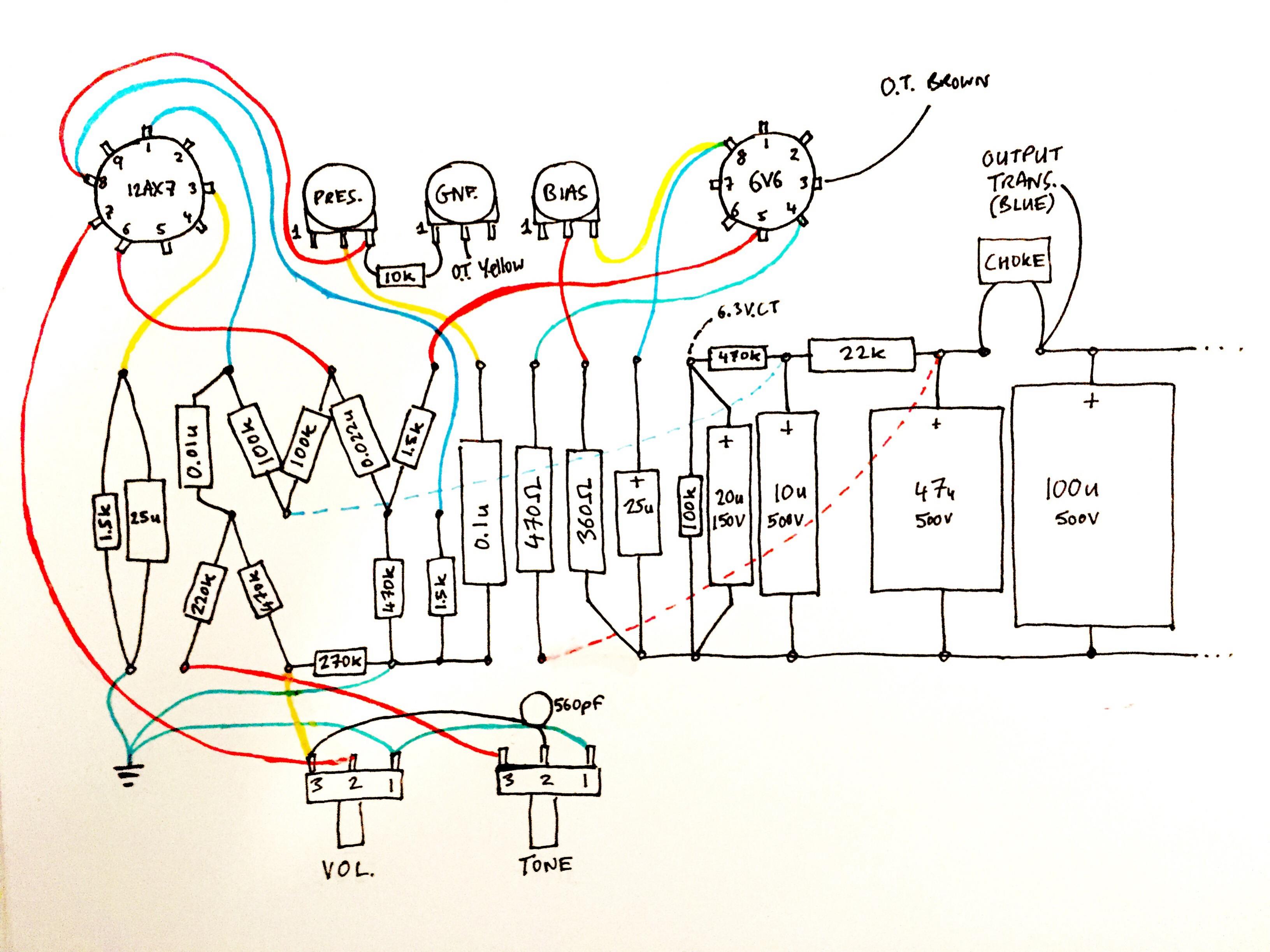

The rest of the layout is now attached. If you can make sense of it I'd welcome your comments.
Is the 6.3v heater winding CT (center tap) connected to B+?
If it were my project, I'd get it working and then add in the VVR later. At this point the VVR would just add to the troubleshooting possibiities, IMO.Stage one. The VVR.
Thanks VictoriaGuy. None of the power transformer CT's are connected.

The layout diagram shows the 6,3v CT connected to B+ - are you planning to connect this at some point?None of the power transformer CT's are connected.
Isn't the HV CT connected to ground - or am I misreading the full-wave rectifier situation?
That's a mistake on the schematic. As far as I know with a full wave rectifier you *don't* connect the HT CT.

Which schematic are you referring to?That's a mistake on the schematic. As far as I know with a full wave rectifier you *don't* connect the HT CT.
Are you thinking of a bridge rectifier?
All the 'classic' full wave rectifier circuits I see have the HV CT grounded,

Sorry - I found your schematic earlier in the discussion. I wasn't really paying attention!
Yes, you have a bridge rectifier, so the HV CT shouldn't be grounded.
And, I missed the voltage divider which you are using to reference your heaters, so that should be fine as well.
