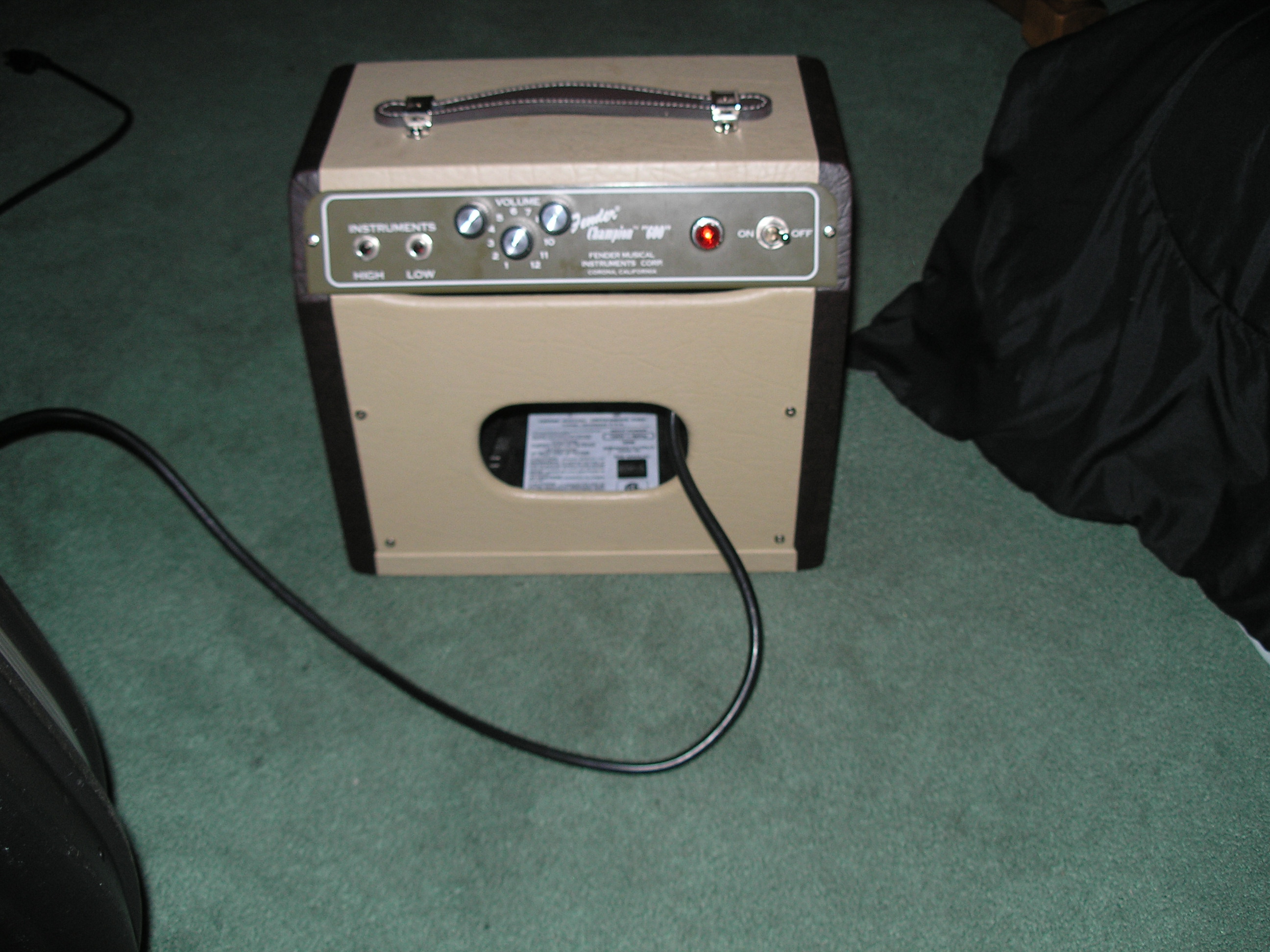

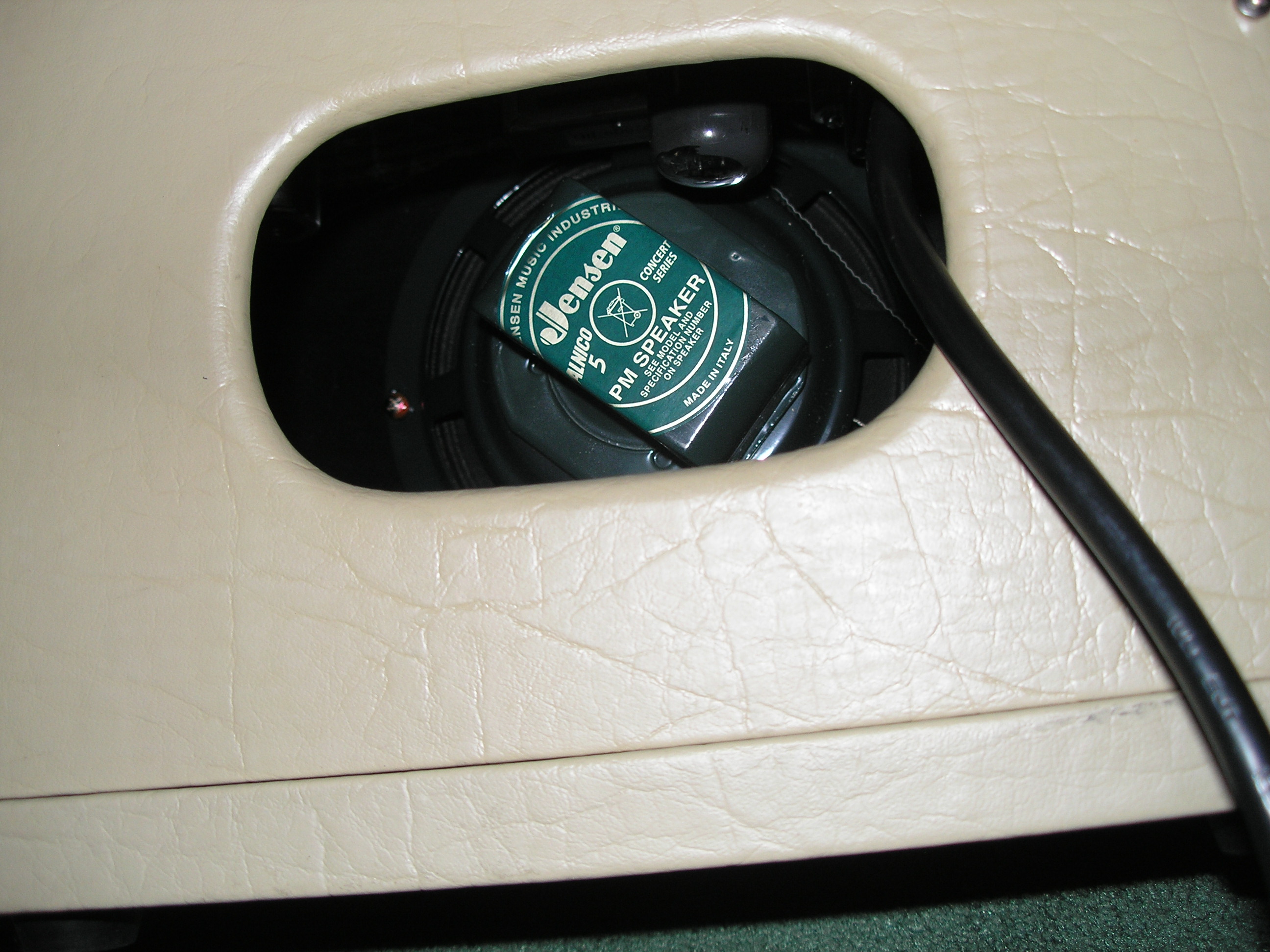

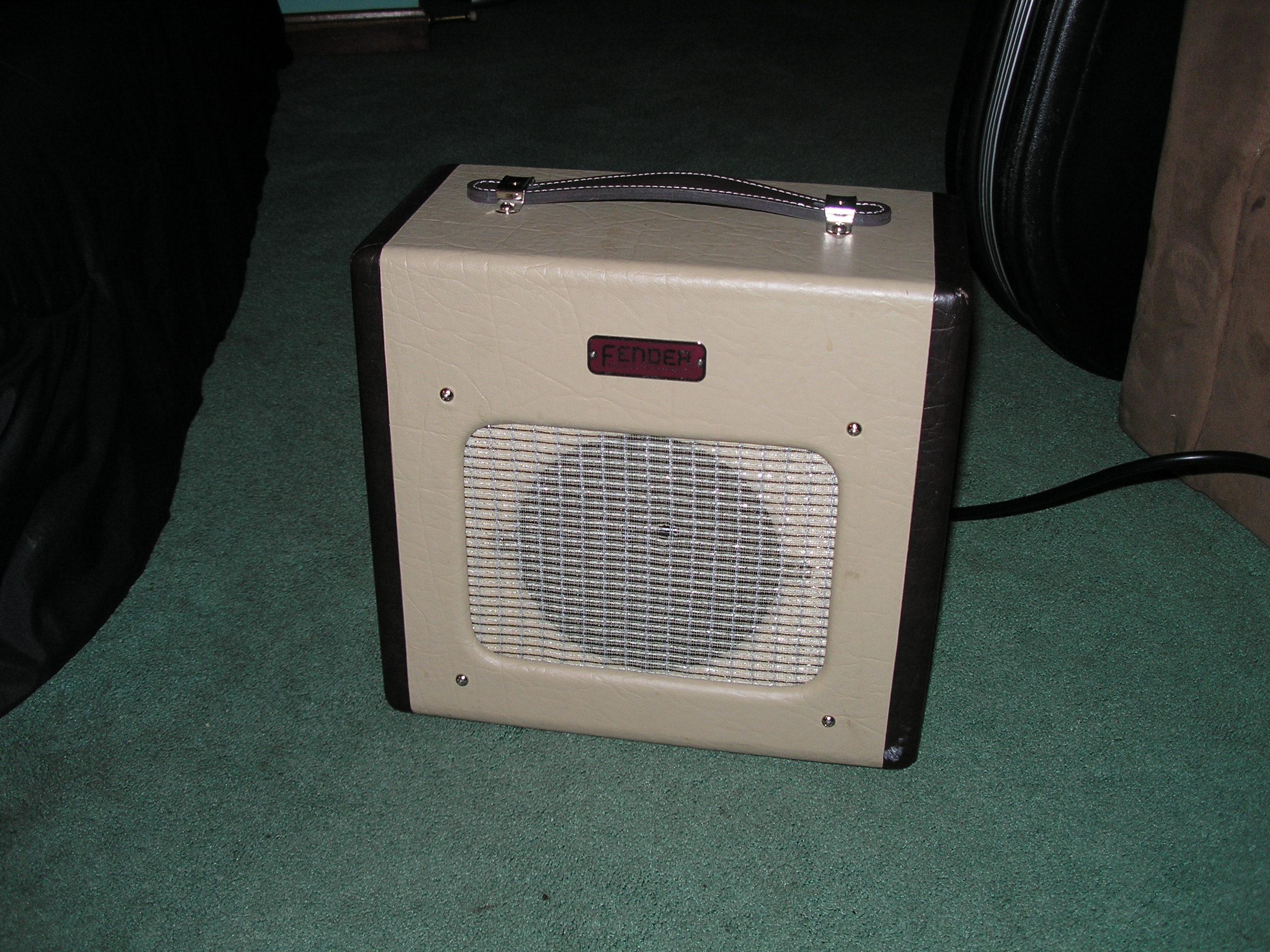

Here is a Fender Champ 600 I just modified. I added bass and treble controls, swapped the chinese 6V6 for an RCA, changed the grill cloth, and added a Jensen P6V alnico speaker. This amp truly sounds great now!!!
Good tone that won't break your back 🙂
Hello Geek, it does look like that Alamo amp you uploaded!!
I was searching for more pictures and found this one, thought it looked really nice.
@famousmockingbird: that champ looks great!
