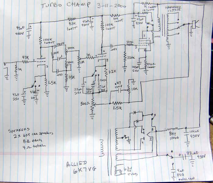

I have used the simple one knob tone control shown in the 4 tube amp schematic in several designs. It has less loss than the typical FMV tone stack, but still has too much loss for a two stage amp (one dual tube). This amp was designed for the Hundred Buck Amp Challenge at the top of this forum, and full details are buried somewhere in that thread. The amp has since been modified for switchable SE or P-P operation with a mosfet phase splitter. I will eventually post the new design here somewhere, once I find the amp. It's in a moving box somewhere.......
I also included the Turbo Champ schematic.

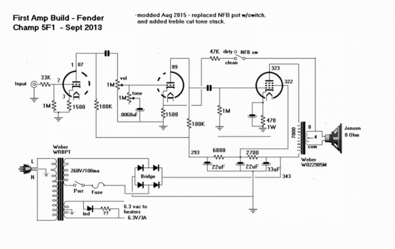

Attached is the schematic of my latest version of my first build, the 5F1 Champ. Had a pot on the NFB but went to a 2-pos switch, and added a simple lo-loss treble-cut tone circuit (gets plenty "bright" due to proper no-hi-cut caps anywhere). Low-cost transformers, boosting B+ with a bridge rectifier. Lowered input resistor from 68K to 33K. And put a good Jensen speaker in it. Mounted it all in a SS Squire cabinet. Offering it as a good starting point. Have fun!

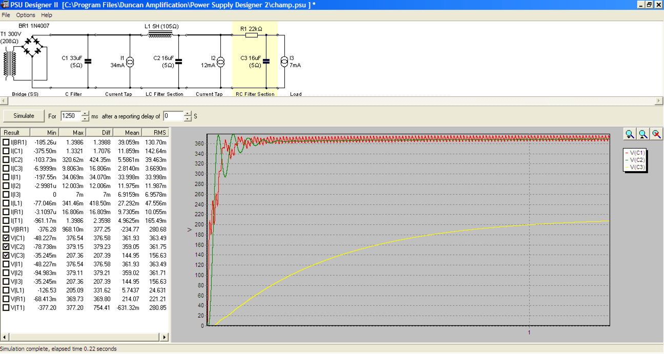

I modeled the power supply as best I could (attached) based on the 372BX PT and 194B choke. ***IF*** I have done it right, it seems the C3 voltage is very low at 207V. I believe it should be over 300V if C1/C2 are close to 380V (which is probably high for C2).
Thoughts?
If I keep the same PT, but change the choke to a 154G (9H,700ohm) and the resistor to 7.5k the voltages end up at:

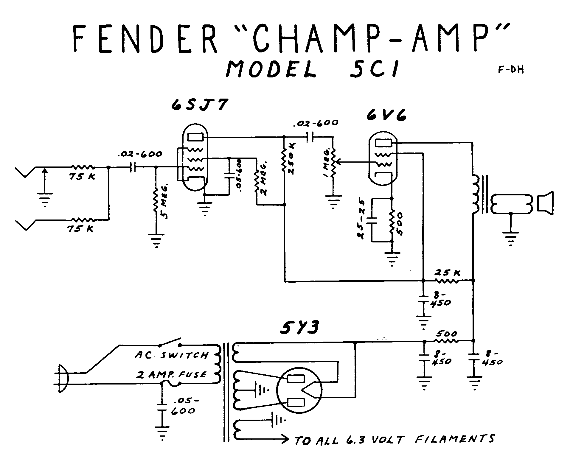

The original Champion circuit with a grid-leak biased pentode input stage is real interesting also.
@Joe: do you have a schematic for that Champion? Sounds interesting.
That is the circuit that I started out with in the mid 60's. 6SJ7's and sometimes 6V6's could be plucked from old radios in the trash for free. 12AX7's were not too common for free. As I learned how things worked, I abandoned grid leak bias. I would advise using a standard cathode resistor bias setup for any pentode input stage. See the hundred buck amp challenge (HBAC) schematic I posted earlier for details.
The grid leak bias setup uses a large value resistor to generate a negative voltage on the grid, while the cathode is grounded. This negative voltage is generated by collecting a few electrons from the space charge around the cathode and "leaking" some of them to ground through the 5 meg resistor. This voltage DEPENDS on a very good vacuum in the tube, since any "gas" will create grid current cancelling the negative bias. Current production tubes don't always have an excellent vacuum, and any 6SJ7 around today, has been around for at least 50 years, and may not have a great vacuum either.
Fender used it because it was cheap. It worked then, because the stomp box had not yet been invented. As I discovered when I built my first germanium Tone Bender clone (about 1970), the old Champ clone I had made years earlier could be made to go silent with a good blast from the two transistor stomp box, yet the stomp box worked great with a Bandmaster. I did not understand blocking distortion back then, but it was happening big time. The stomp boxes we have today have far more gain.

And you are correct, the 5C1 Champ did indeed have a 6SJ7 for the preamp, and since it's a pentode, under normal conditions will sound different than the two triode stages of the 6SL7. Of course it will depend on what voltage you operate the plate and screen at on that 6SJ7 to determine gain. Higher screen voltage will have more effect than higher plate voltage. Yes, it is more linear as the plate curves are more evenly spaced and when cutoff occurs from more neg signal, it is more sudden than the more gradual cutoff of a remote or semi-remote cutoff pentodes. Also, since there will be more gain in the input with a pentode, the noise that is generated will be higher because of the higher gain. so some people use a single triode for the input and then follow up with a pentode.
