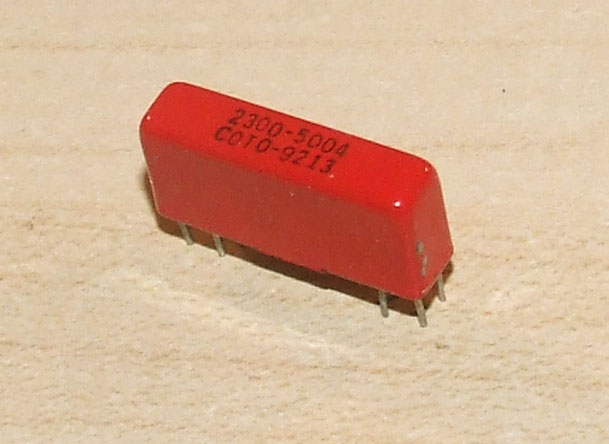

I need to switch inputs in my preamp but I need as highest quality contacts/relays as possible. Writing "highest quality" I have on my mind the quality of final sound: I want to find relays which will be nearly not audible. In this thread were mentioned such relays as:
- Coto 8L Reed/Spartan
- Teledyne 712 (TO-5)
- Coto 2200 Reed
- Omron G6A-BS
- Omron G6K
- Omron G6L
- TE Connectivity RT-2
- Panasonic SX-ASX
- Panasonic TQ2
and I consider to use Coto Technology 9814-9852 Reed Series relay.
But I have not still chosen any of above. Maybe there are other suggestions?
