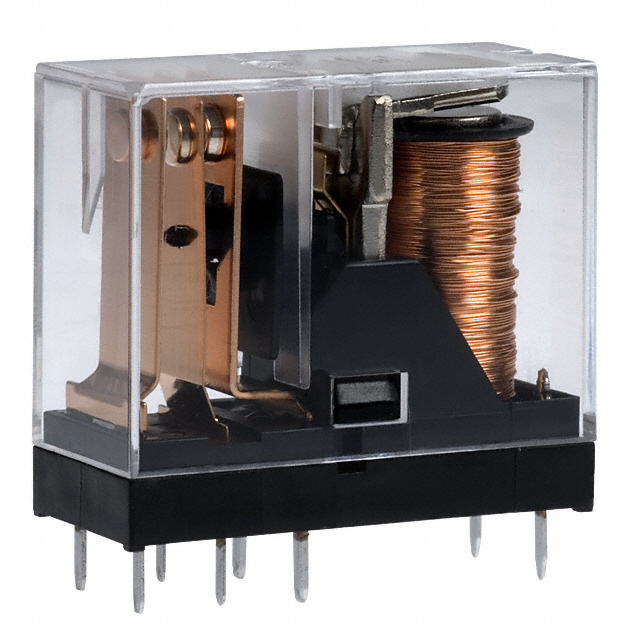

Im building speaker protect circuit and also need to use relays,
Ive been looking at whats available to me,
Ive been looking at the OMRON G2R-1-E
What do you guys think about this relay ?

10A 30Vdc rating for a resistive load, reducing to 5A 30Vdc for an inductive load.
What are your supply rail voltages?
Supply is 35V-0-35V AC so about 50V-0-50V DC,
If these relays are not suitable, do you have any suggestions ?
Thanks so much
Thanks so much
Thanks so much
My guess is that those Omron relays should do. They seem to have specs similar to the F&T F4AK024T which is the speaker relay in my Marantz amp with +/50 VDC power rails (amp is specced at 2x 90 W/140 W into 8/4 Ohms).
