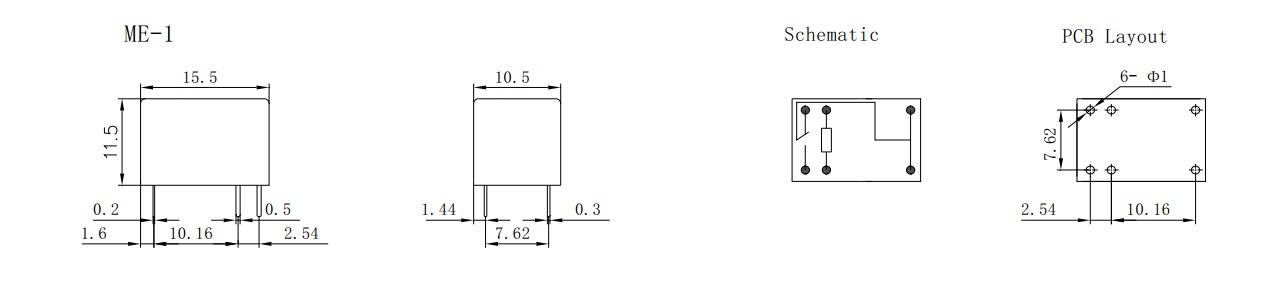

Guys sorry to barge in but I need some help. I have a Muse ta2020 amp that has 2 relays for speaker protection. The model is Massuse ME-1-1-12BS. It is 2A rated but I'd need 3 or 5A at least. I measured a 2.35A maximum draw from the PS and would like to be on the safe side. Plus this type of relay is some chinese stuff that I wouldn't trust that much on some nicer speakers. There are only 2 relays to replace so I'd like to put something nice and safe rated for my application but have no idea on what "package" type or dimension. This relay is rated as mini-format or something like that because it is small, and I don't have any room left on the board for something larger, just in height can go to about 20mm. width and length can be no higher than the one that I have. I'd appreciate any help for good parts that fit and are easily available from tme or farnell. Thank you and again I'm sorry to hijack the thread with my problem.

Im building speaker protect circuit and also need to use relays,
Ive been looking at whats available to me,
Ive been looking at the OMRON G2R-1-E
What do you guys think about this relay ?

G2R has very ordinary DC switching rating.
You should try Omron X rated relays, specifically for DC load switching. eg MM2X.
Rated at 10A 110Vdc or 7A 110Vdc inductive load. Hard to get and costly.
Because they are unavailable here I am using a standard LY4 but with all 4 poles wired in series to give me sufficient air gap to quench the arc quickly and reliably. Approximates 25% of the voltage across each of the poles when opening.

10A 30Vdc rating for a resistive load, reducing to 5A 30Vdc for an inductive load.
What are your supply rail voltages?
This is an economical ( $1.00 ) relay suitable for Speaker switching applications.
The G2R-1-E series is rated at 16A@30Vdc. There are very few devices which can compare at this price/ performance level.
