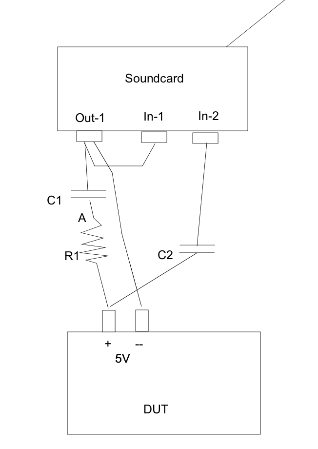

With a swap, a sinosuidal signal that you apply to a given load with and without the PSU connected, and then comparing both measures.
Hook a signal generator (sound card) up to the output of the supply via a blocking cap and series resistor and measure the AC developed across the supply output, do maths.
If you use a stereo sound card or such then by also sampling the drive voltage you can produce a plot of complex impedance not just magnitude, which is far more useful.

Did you see my measurements?
Regards, Dan.
Thanks!
What size resistor would you recommend?

Like this?
Should probably be a load for the DUT also....
I would make the connection to in 1 come from point A via a cap equal to the one on input B, that way you will have close to a pure resistance as one half of the measurement impedance which makes the maths for the down near DC case simpler.
Resistor value depends a lot on the impedance of the network you are measuring (Effectively you are building a low frequency vector network analyser).
As to the load on the supply, sure but remember that that load then becomes part of the one port network you are measuring.
Calibration of such things is done traditionally by measuring with open circuit DUT, short circuit DUT and a known impedance in place of the DUT.
HP/Agilesight have a great publication "The Impedance measurement handbook" that goes into more then you ever wanted to know about this stuff.
Regards, Dan.
